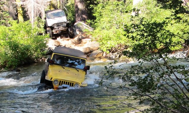

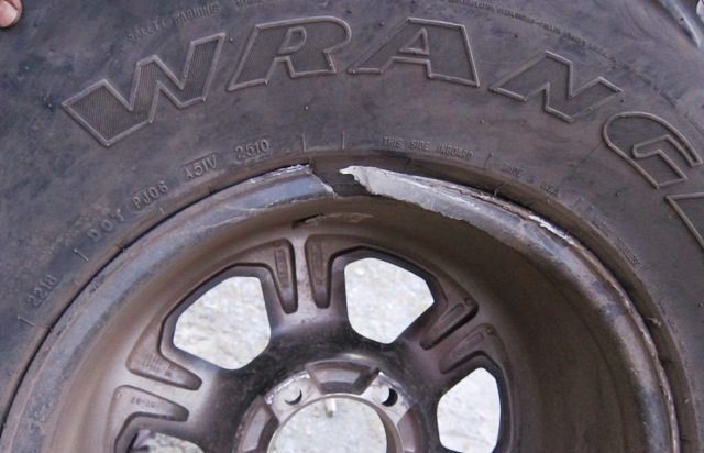

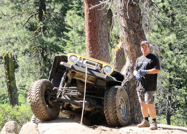

    A few pics I have. Brad, I will get you the rest on disk.
    #4521 Aug 2010, 8:06 AM
    I'm still amazed that tire held air 😲
