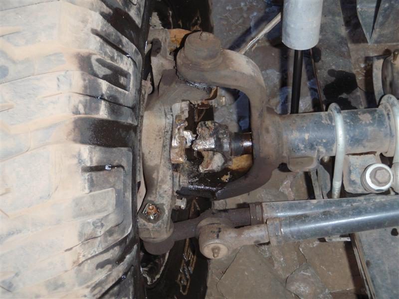

    What's the story with the axle problem?

    "FAM" wrote: What's the story with the axle problem?
    All I know is he tore the ears off of both shafts on winch hill two.

    I'm home. That was one abusive and fun day. I suffered body damage and got winched up one and two. The Toyo made some funny noises on the way home so there might be some more damage. Kevin broke the right front u-joint on Winch Hill 2. Rob got a minor scrape and I think Chuck survived intact.

    I made it home okay. I still had my stock YJ disconnect axle so I pulled the fork out of the vacuum disconnect and was able to drive home. To be honest, I don't know when it actually broke. In hindsight I did notice a noise every now and then but just assumed it was from bouncing around. It must have been hanging by a thread on winch hill 2 and then it seemed much harder all of a sudden and spit out the u-joint. No big boom though. 18 1/2 years on stock axle isn't bad though! What a huge difference between having a front locked axle and then not!

    #616 Sep 2010, 7:11 AM
    D'oh!
    #626 Sep 2010, 7:49 AM
    That doesn't even look like an axle shaft any more 😂

    Kevin,
    If you go to a junk yard or call up some of the 4wd shops, they probably have some really cheap TJ axle sets sitting around. It wont take very long to fix your Jeep. You will need to pull your carrier now and replace the seal on the side with the broken shaft. It is more than likely toast after having that shaft wobbling around in there.

    "SLM" wrote: I may have 2 stock TJ front axles that are some what complete still hanging around if the buzzards haven't picked them over too bad. All I know of for sure is that Lee used the carrier and the unit bearings from mine that was removed when it had 30k on it and Sue's were from a 05 LJ with about the same. Do you want me to ck on them?
    That would be great! I just need the shafts. Then I can pick up some new seals and be back on the trail! 😀
