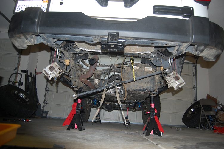

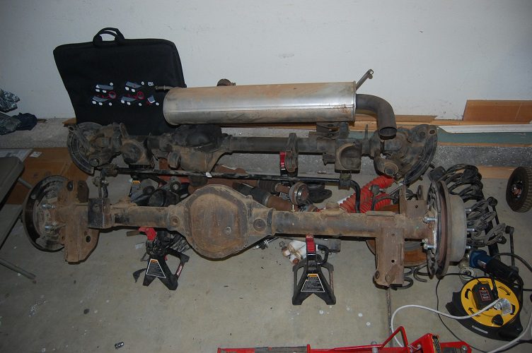

    I completely removed the rear axle from the Jeep. I also removed the muffler to make room for the other D44 i'm putting under the Jeep. It doesn't feel amazing but tomorrow I can start to install the new bracketry and the rock star skids. I am installing a charcoal canister relocation kit first since everything is removed it should be pretty easy to install.
    I also removed the rear drive shaft and my new front and rear drive shafts showed up today so they will go in tomorrow as soon as I get the axle put back in.
    I'm also amasing a ton of parts. Time for a swap meet or if anyone is looking for some spares.

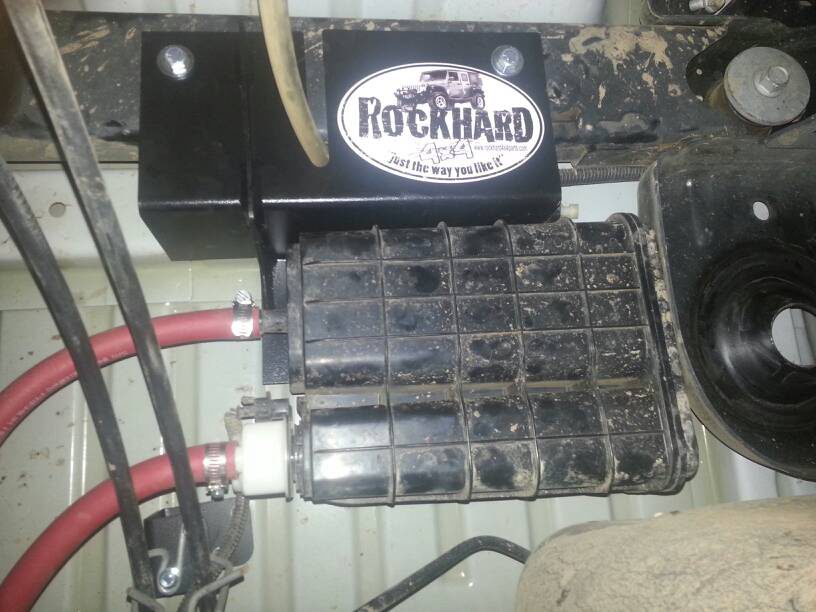

    Quick update only had an hour today so I installed the rock hard evap relocation location kit. 1 down several to go.
    #433 Oct 2012, 7:25 AM
    "huck271" wrote: Quick update only had an hour today so I installed the rock hard evap relocation location kit. 1 down several to go.
    Looks good. I relocated mine too. It's money well spent.

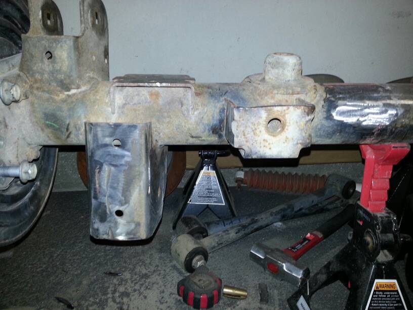

    Lots done today I'm making progress. I lifted the body off the frame in the rear to install the reenforcement brackets for the coilover. It was easier said then done. Next i had to cut rear axle lower control arm brackets to make room for the rock star skids that come in the kit. I also had to trim the factory trackbar bracket to make room for the new trackbar bracket. The challenge here was that the previous owner of the axle had a Teraflex bracket that had to be cut out as well. It was welded in about 10 spots. Lastly I had to shave the brackets to remove the old swaybar mount and old shock bracket. This took a ton of grinding to get right. Lastly I cleaned up the axle a bit and layed down a coat or primer.
    Tomorrow i should be able to start installing the coils, paint the axle and start reinstalling everything.

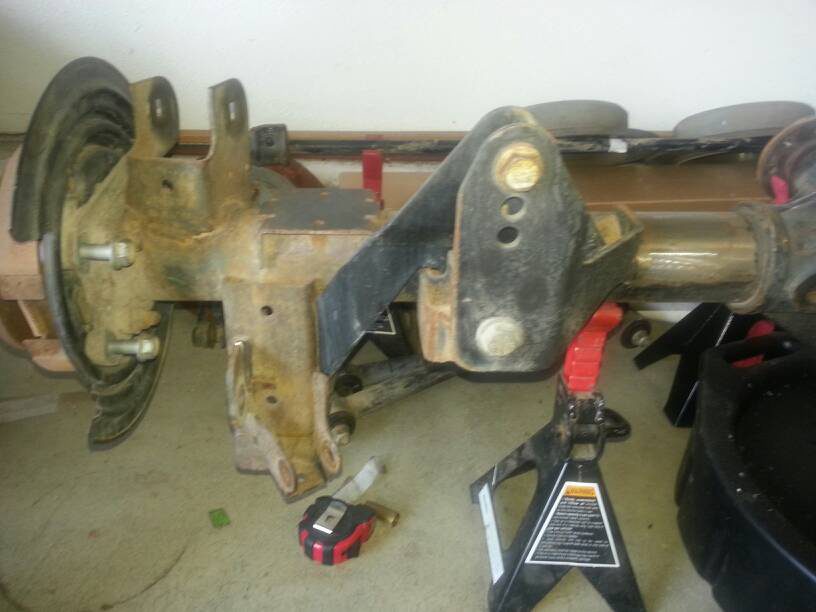

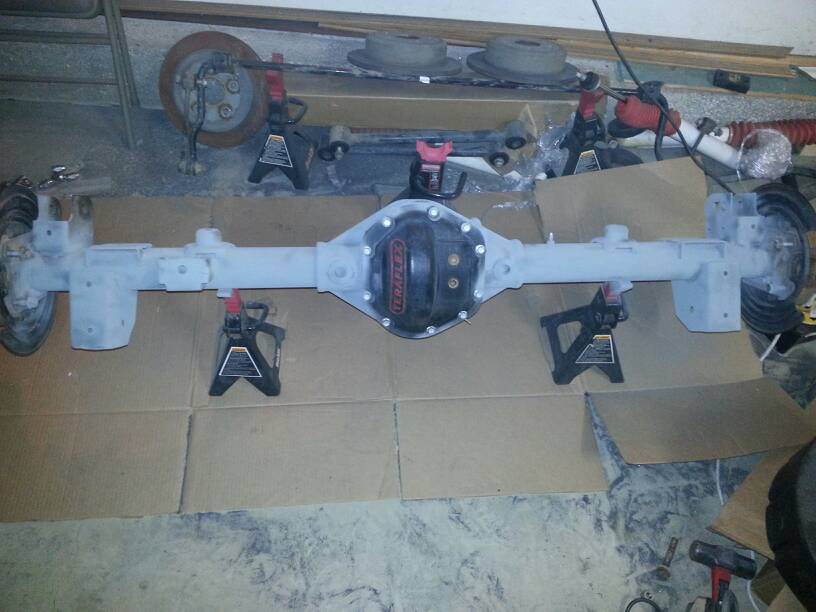

  20. huck271 started this Subscriber
    #453 Oct 2012, 11:40 PM
    Starting point
    Shaved
    Primed
  21. huck271 started this Subscriber

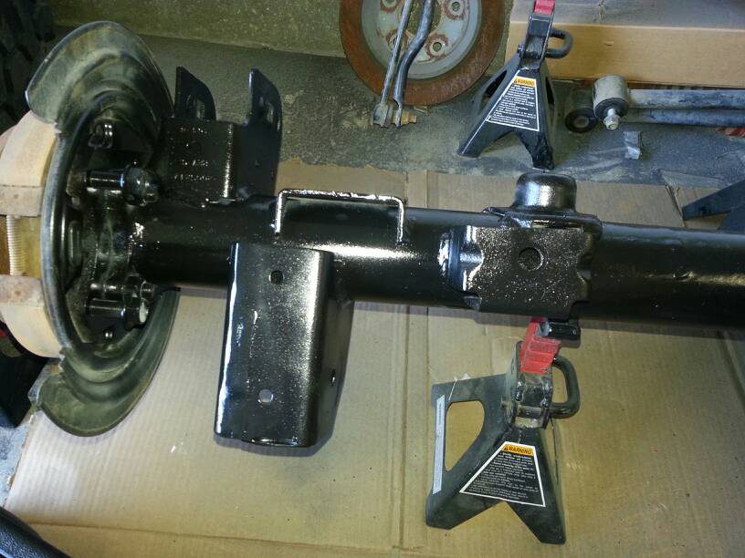

    #465 Oct 2012, 9:52 AM
    Got a good bit done yesterday. Lot of "watching the paint dry". I coated the axle twice with a gloss black. Installed the rock star skids, and trackbar bracket. Installed a new locker actuator plug and put it under the Jeep. Lower control arms are in, uppers still have to be adjusted for the right pinion angle before they can be installed. Today I am hoping to hang the coilovers, run the new brake lines, put the new drive lines in and possible set it down under its own weight.
    If anyone wants to help today i'll probably be in the garage all day.

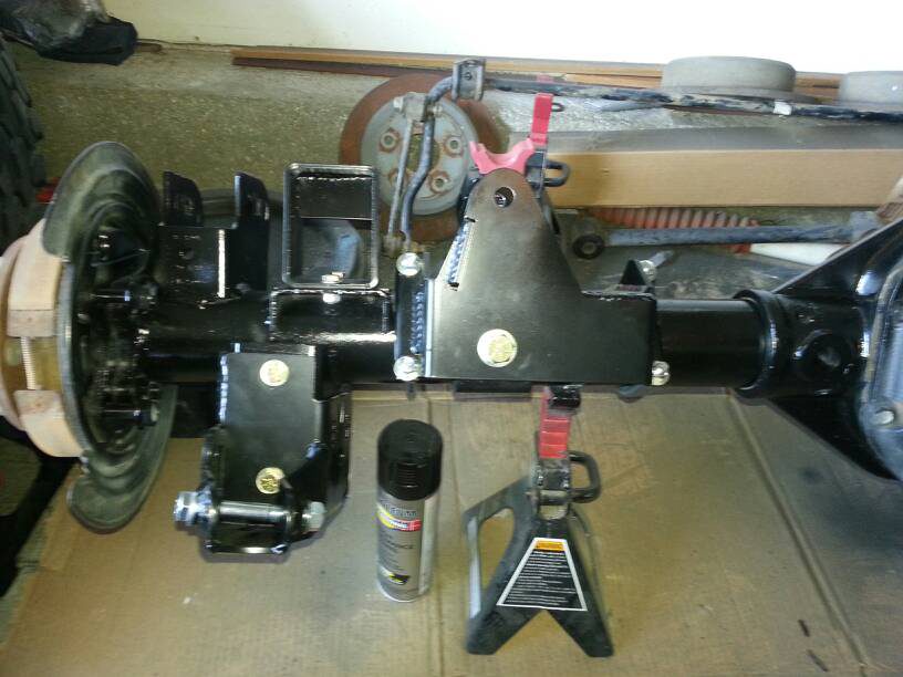

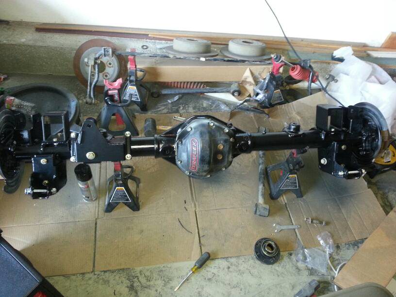

  22. huck271 started this Subscriber
    #475 Oct 2012, 9:55 AM
    Painted
    Rock Star Skids Installed
    Finished Axle
