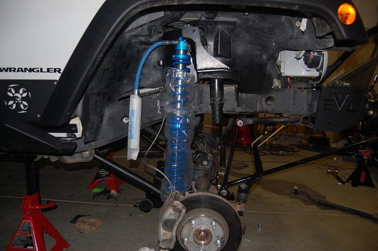

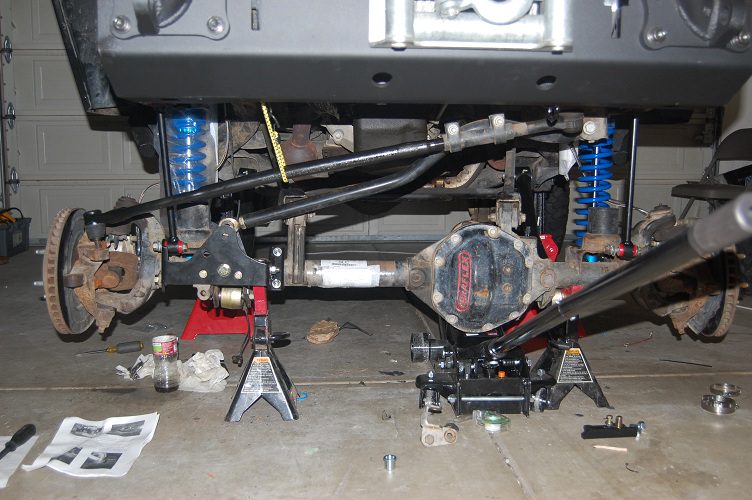

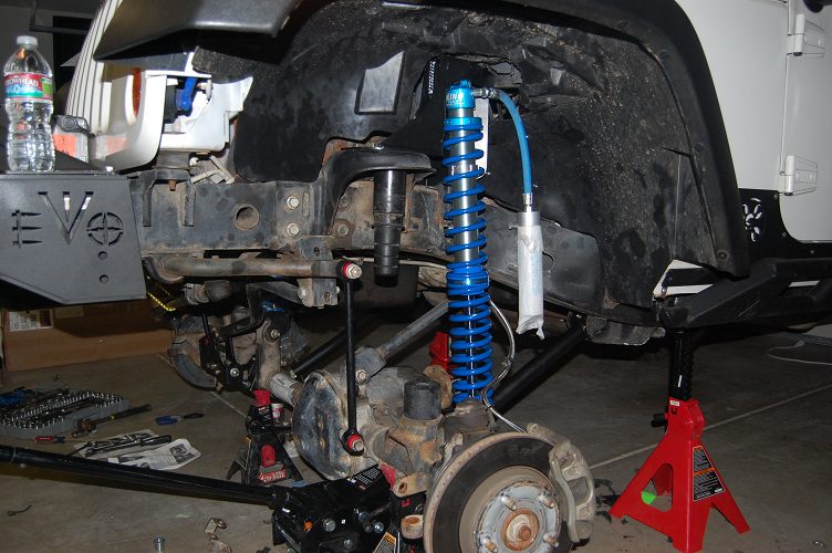

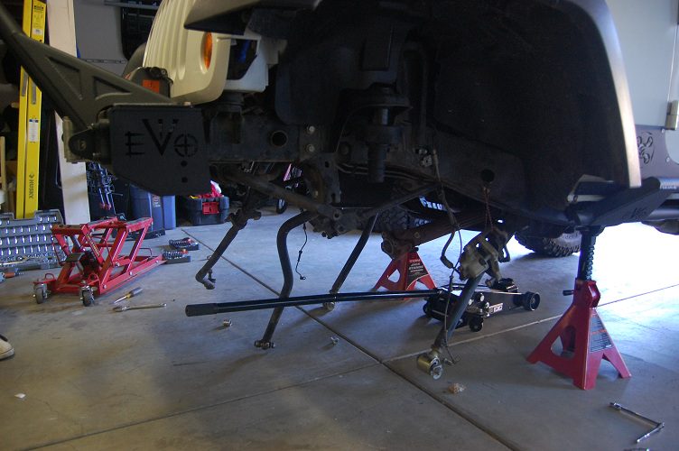

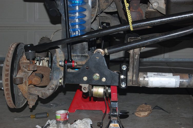

    Huge thanks to John and Josh who showed up and helped today. We made a ton of progress. For being a bolt on this kit is pretty involved and could really use some better instructions. We made a lot of progress but we still aren't done with the front yet. Haven't even started on the back.
    It took about an hour to remove the D35 from the front of the Jeep, about 2-3 hours to cut out the plastic necessary to make the tower bracket fit and get the driver coil hanging. It took about another 2-3 hours to do the passenger side and new lower control arms. Then it took about 2 hours to mount the replacment D44 axle under the Jeep and install the Drag link flipkit and install the new longer brake lines.

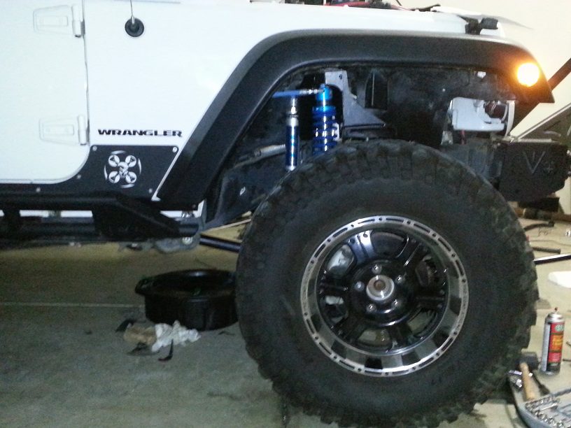

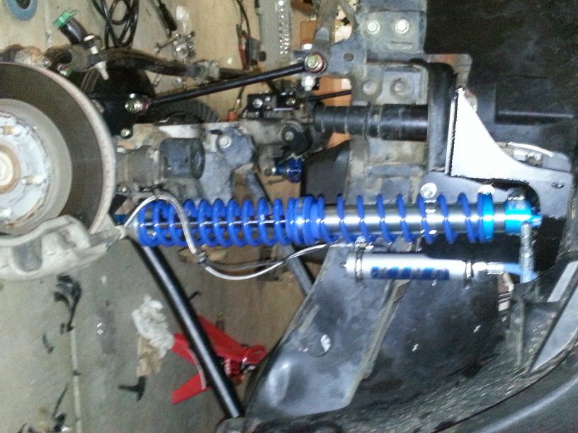

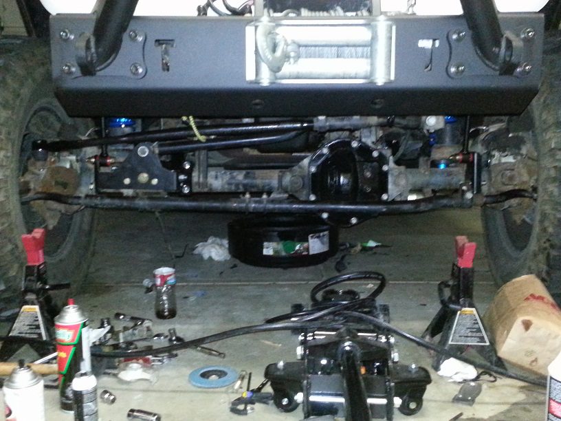

    Today was not as productive as I had hoped but I the Jeep is sitting on all four and drivable tonight. I finished mounting the coil reservoirs, upgraded the sway bar bolts, installed the final parts of the drag link flip kit and put the wheels back on to look at the lift height. It looks good. I serviced the diff today so its got fresh fluids. I only have one or two items left to call the front end done. I need to replace an ABS cable I broke removing it from the D35, and I need the Rubicon Axle housing plug for the top of the diff. The axles were used and the front was missing the plug, the rear has the plug but the plastic is broken so I'll pick up two new ones and just start fresh. Hopefully after a trip to the stealership tomorrow for the new cable and plug ends all will be good to go and I can get ready to do the rear.
    Some updated pics.
    Axle after diff service and fresh coat of paint
    Driver Coil with Reservoir mounted
    Front end at ride height, higher than before probably 4-5" of lift, time for 37s
