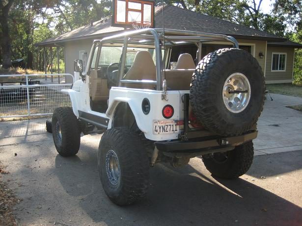

    Thanks to Rob for his help. Who'd have thought that a simple LED install would take all danged day. Every time we'd wire them up, something wouldn't work. We'd pop fuses, then the blinkers wouldn't work, then the brake lights wouldn't work. It turned out to be a bad blinker relay in the steering column. But, now they are in and they work GREAT!. Now I have "flower power" in the front and the back 😁

    The wiring on the driver's side has three wires while the passenger side has four. I know what all the wires are except the fourth (green) wire 🀷

    "JohnDF" wrote: The wiring on the driver's side has three wires while the passenger side has four. I know what all the wires are except the fourth (green) wire 🀷
    Third brake light maybe?

    My 2000 FSM shows a 4th wire going to the right rear tail light and says it's not used. It lists the color as DG/RD. I suspect that's a dark green wire with a red stripe. From the diagram it looks like it splits off from the left brake/turn signal wire.
    #158 Jun 2009, 1:38 PM
    That's the one. It's a hot wire that's not used?
    Maybe it's there for the tow package πŸ˜‚
