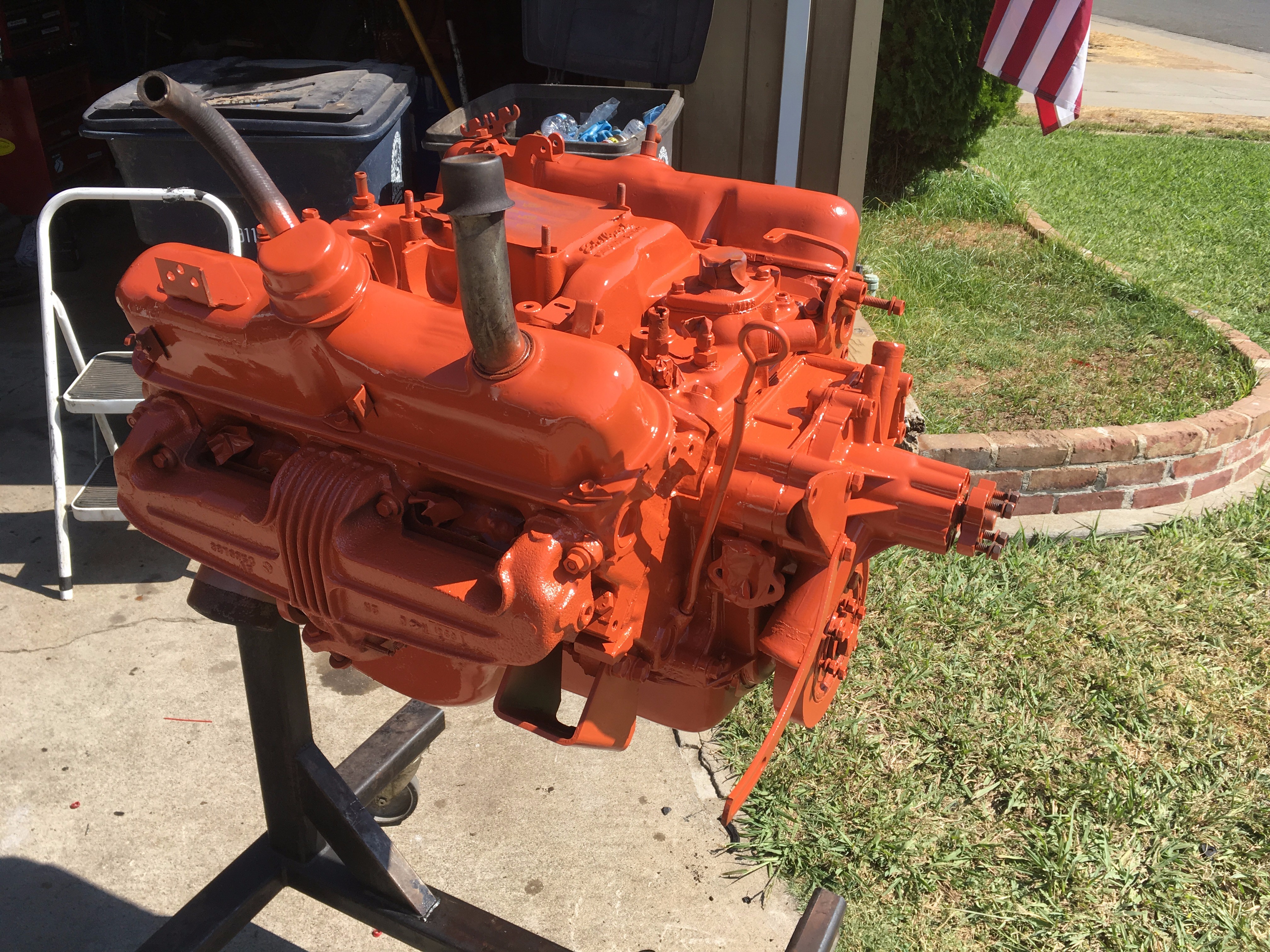

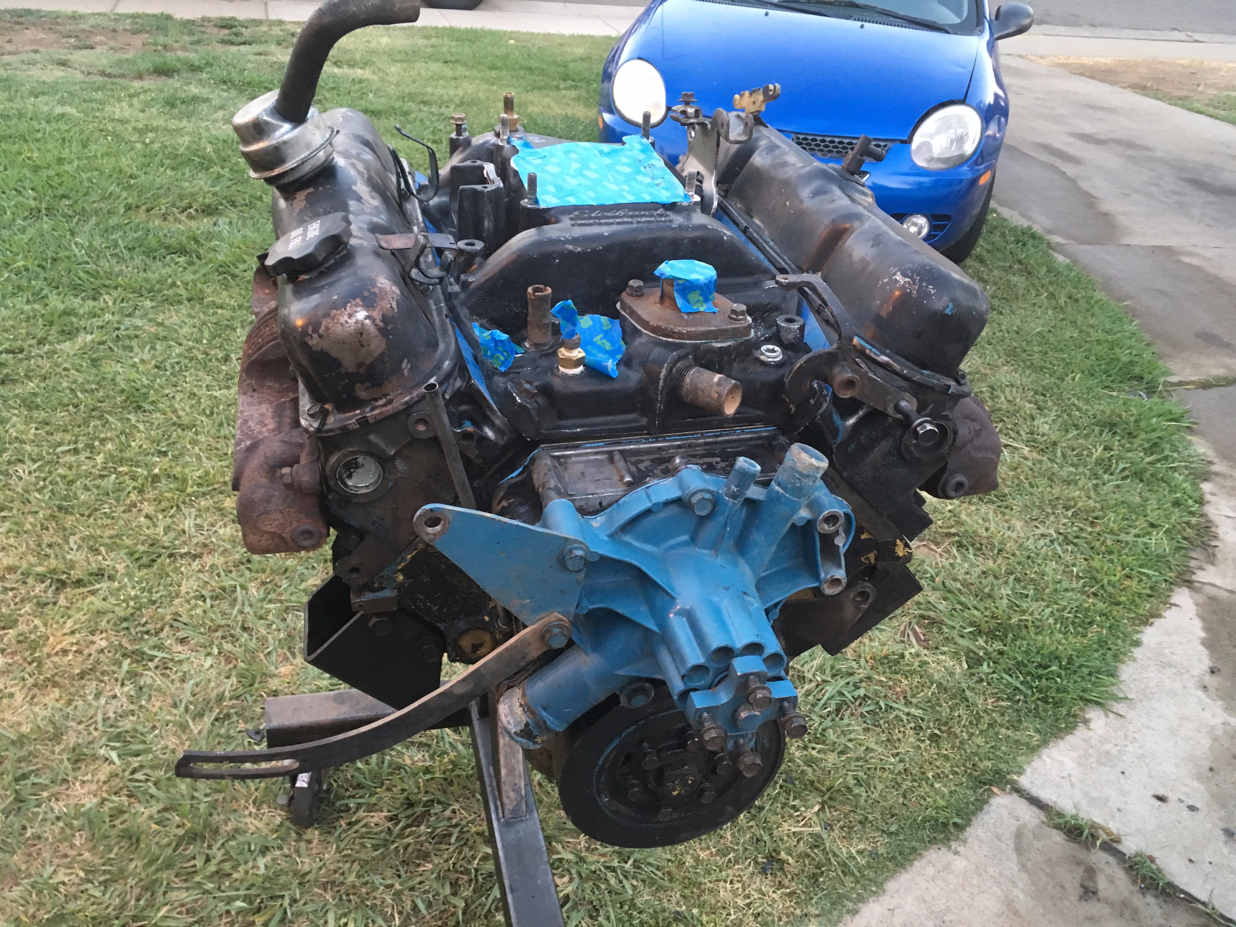

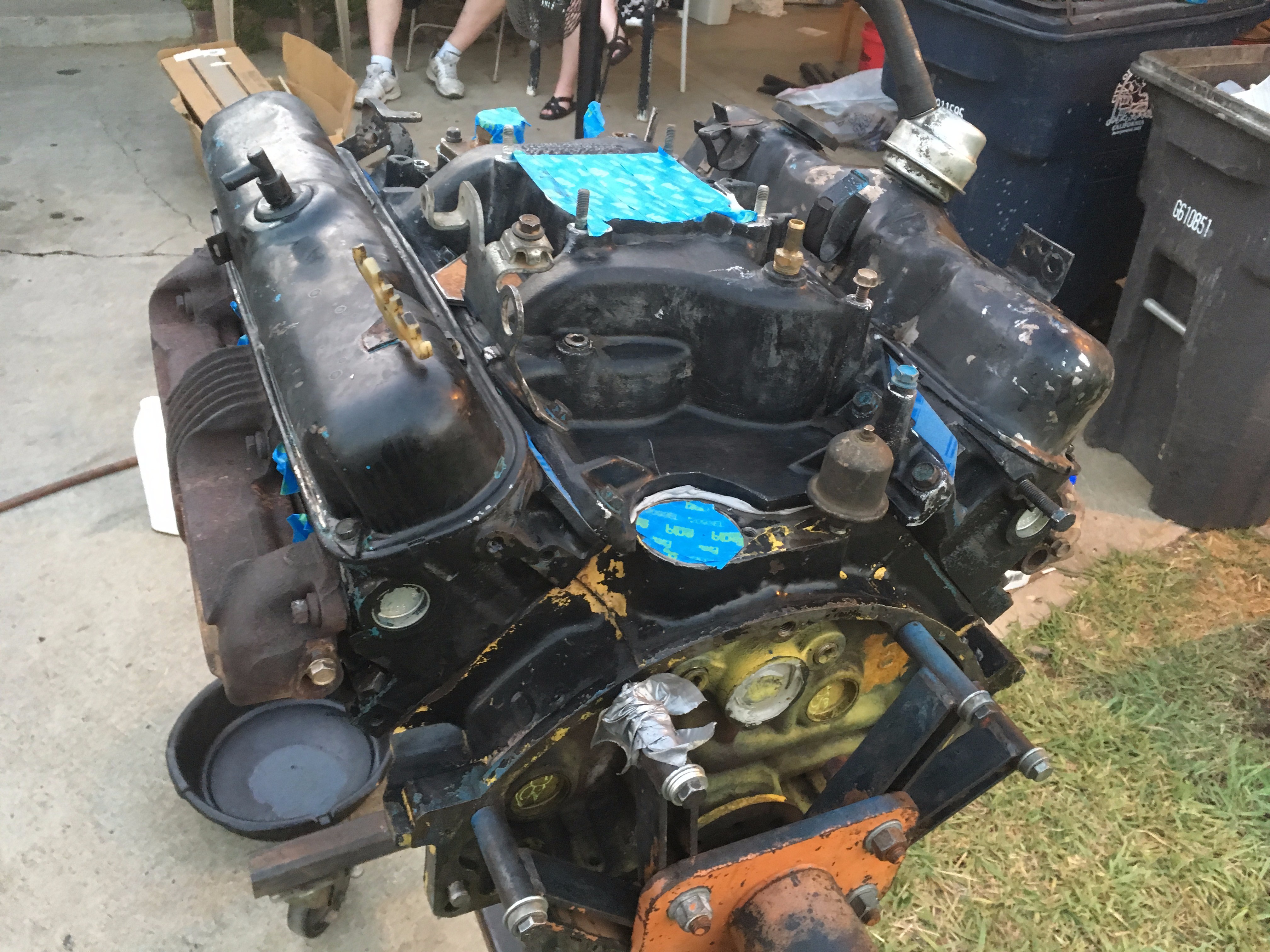

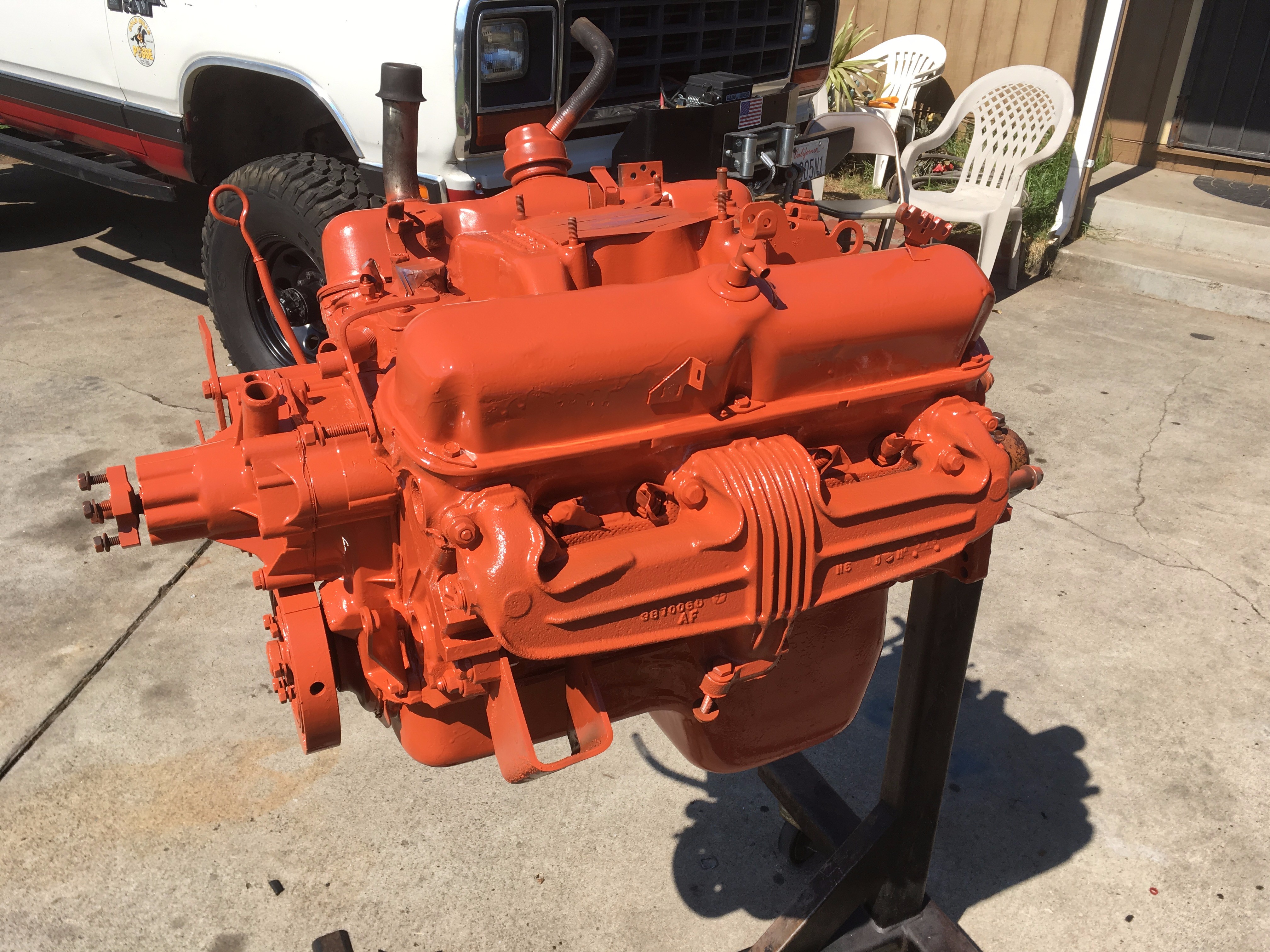

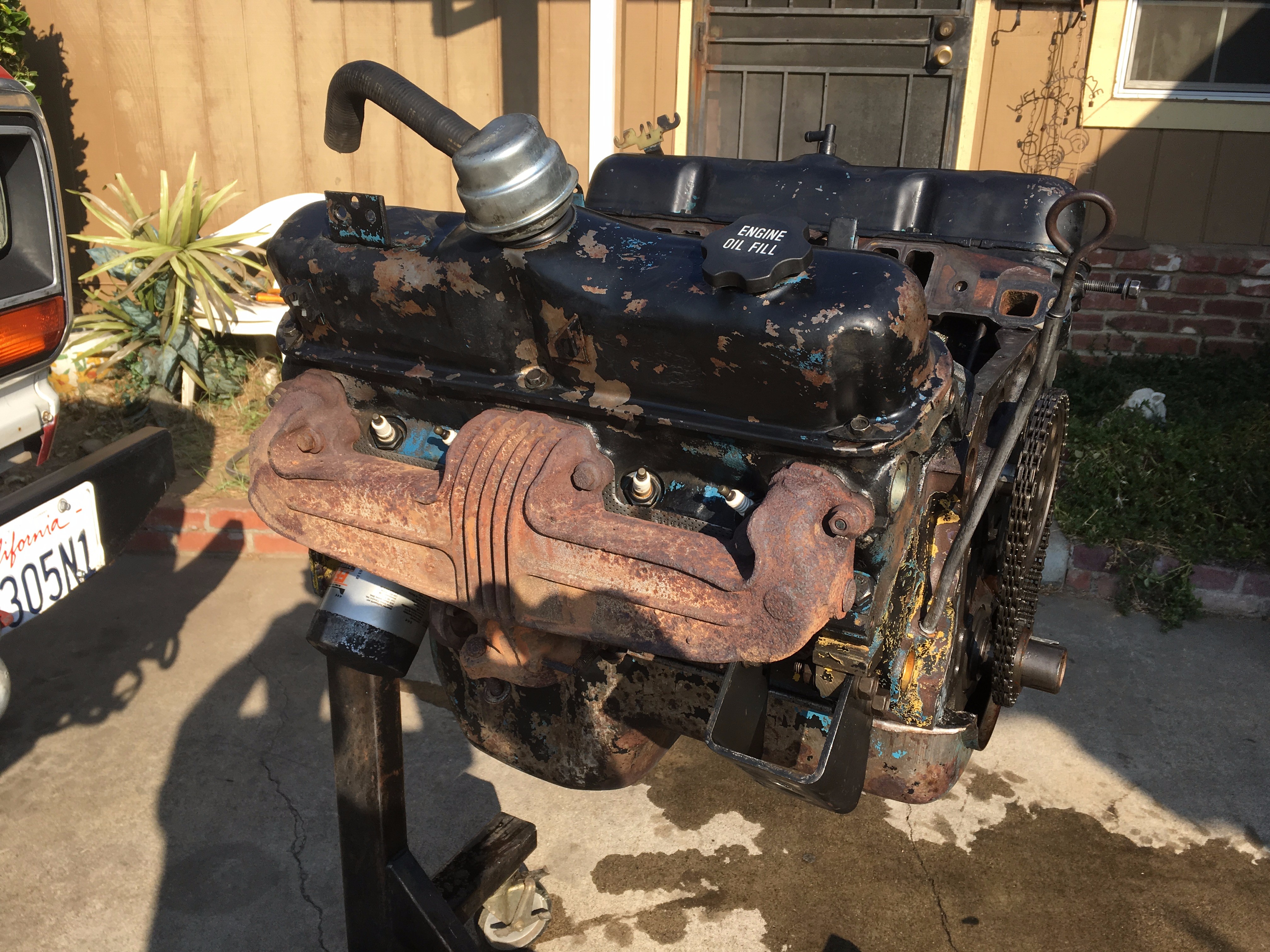

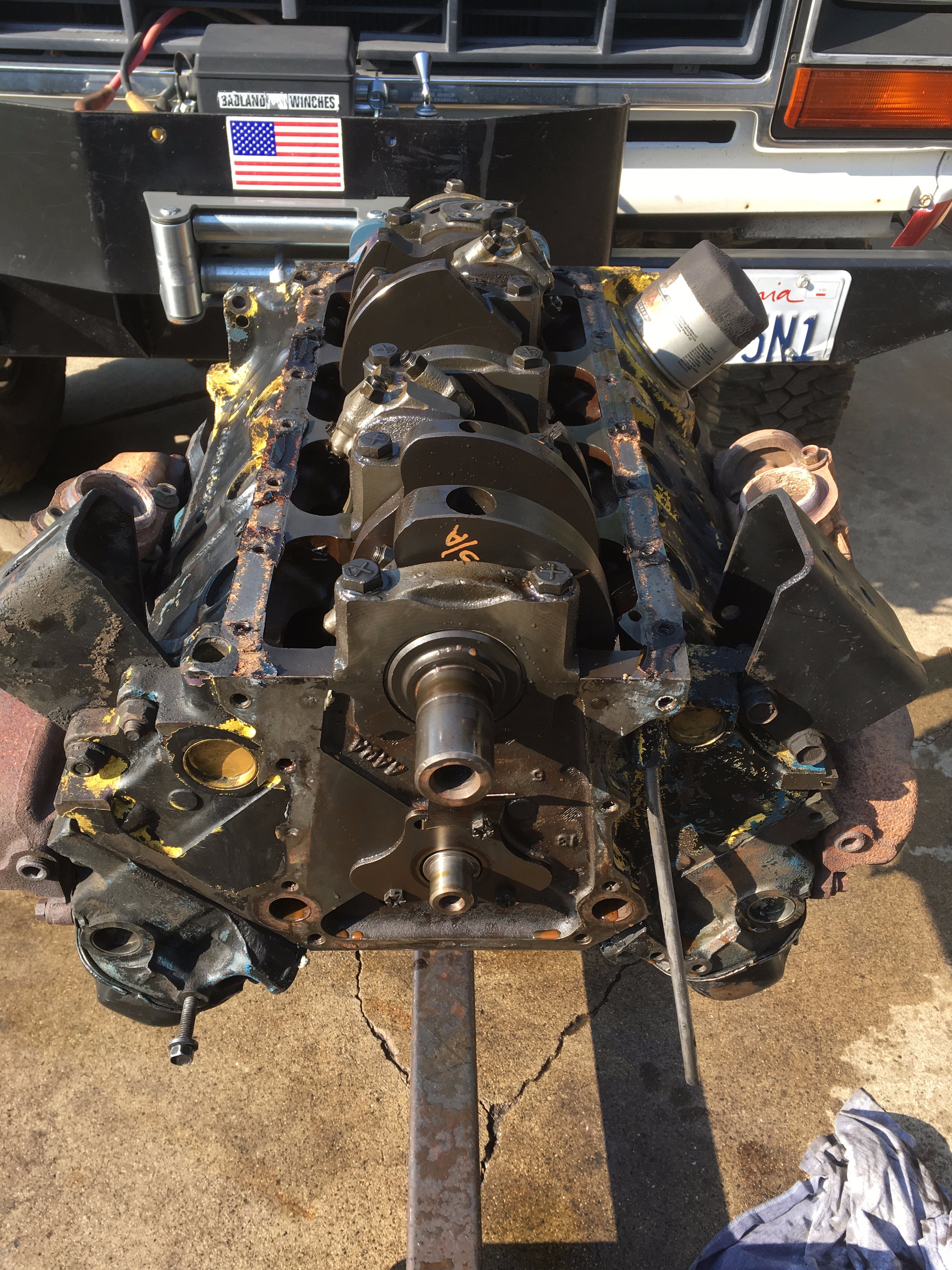

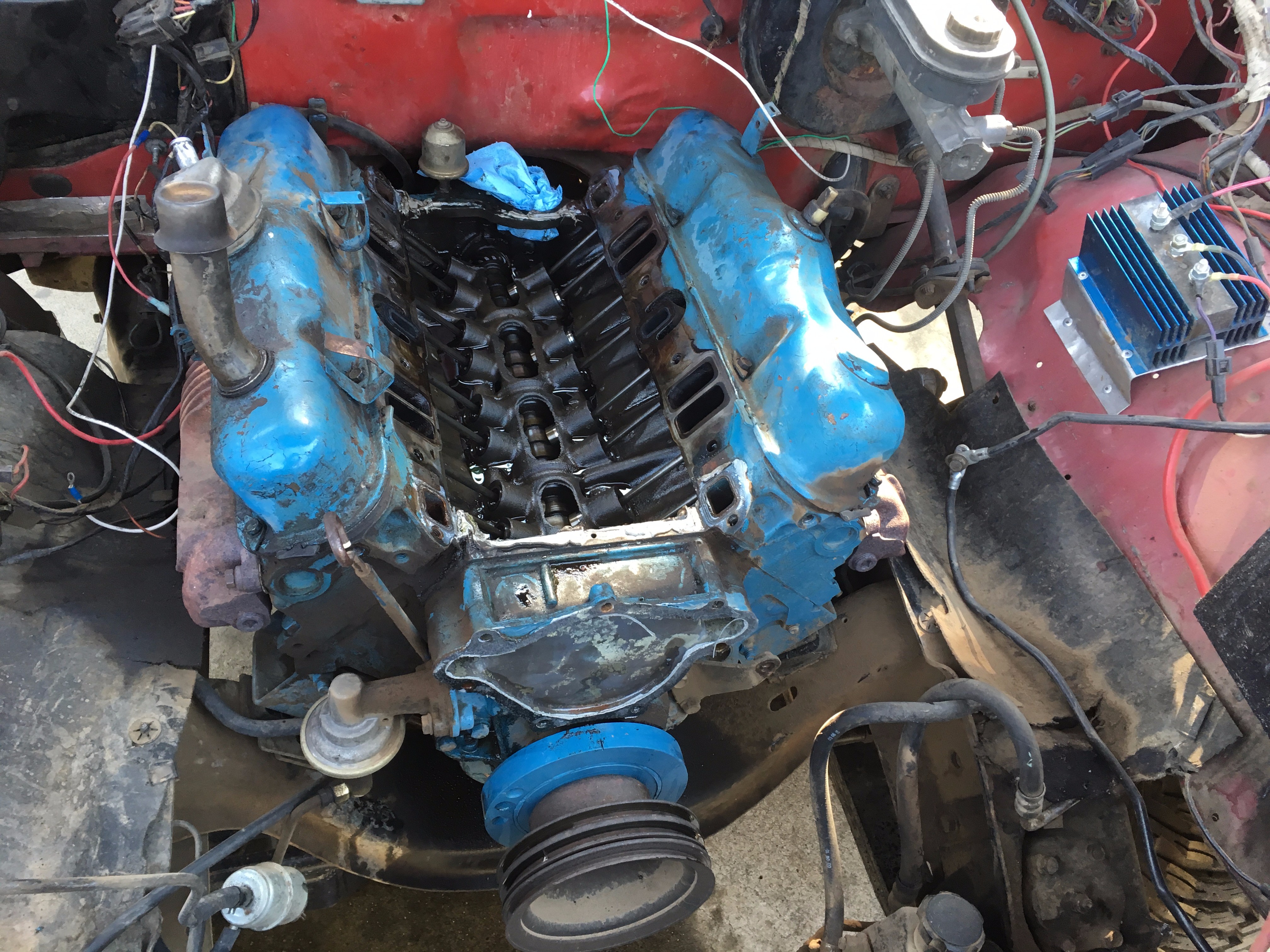

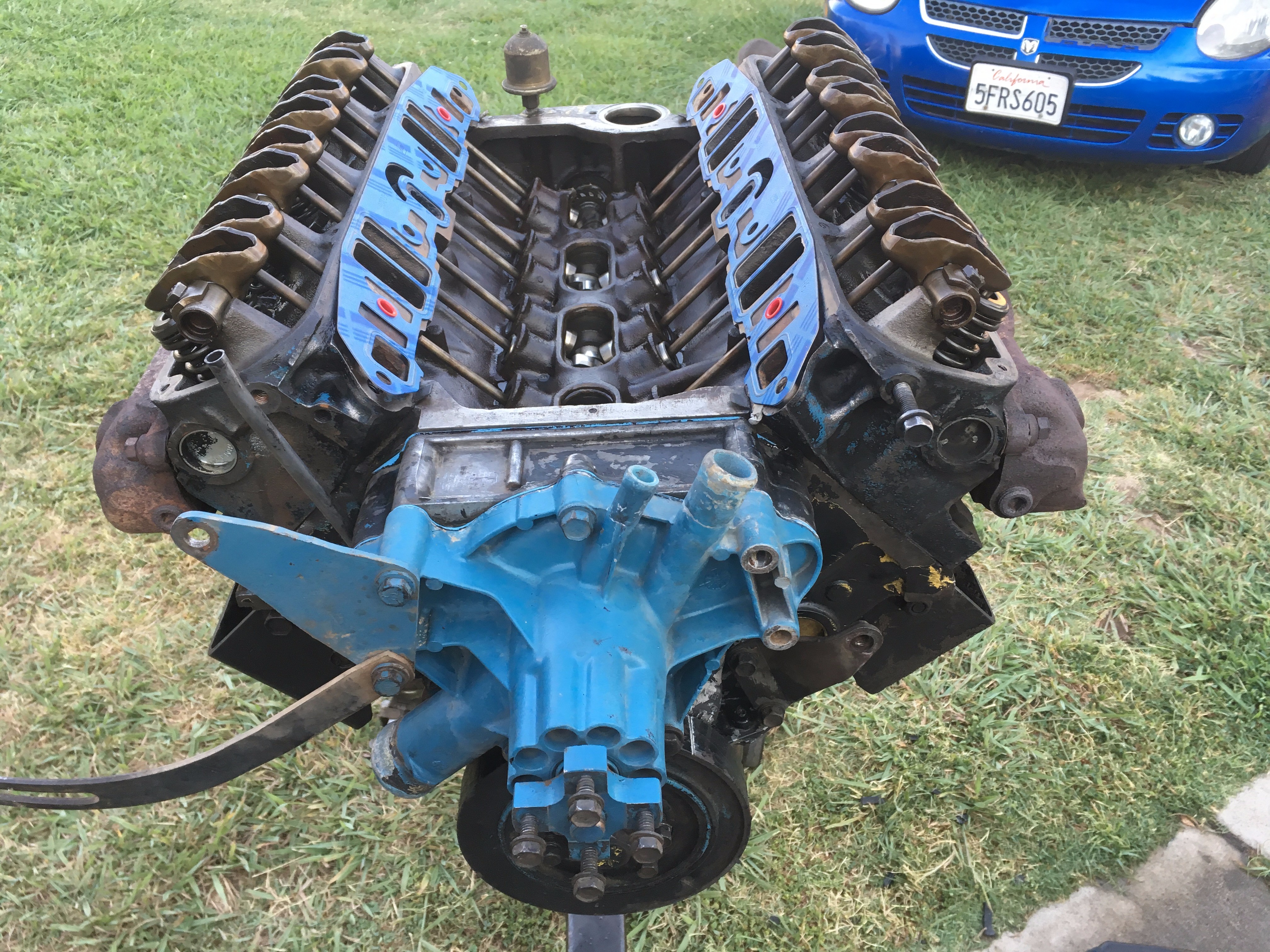

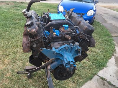

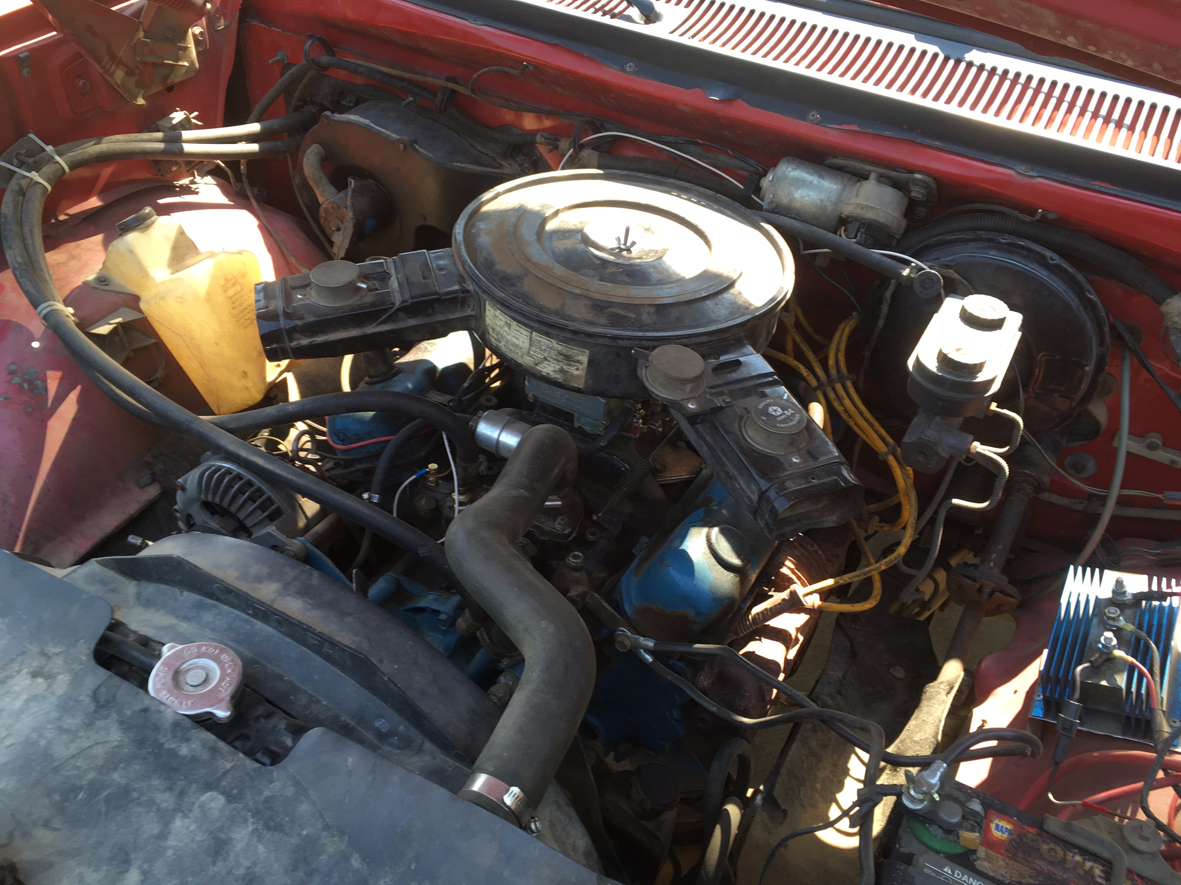

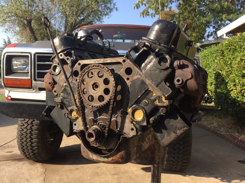

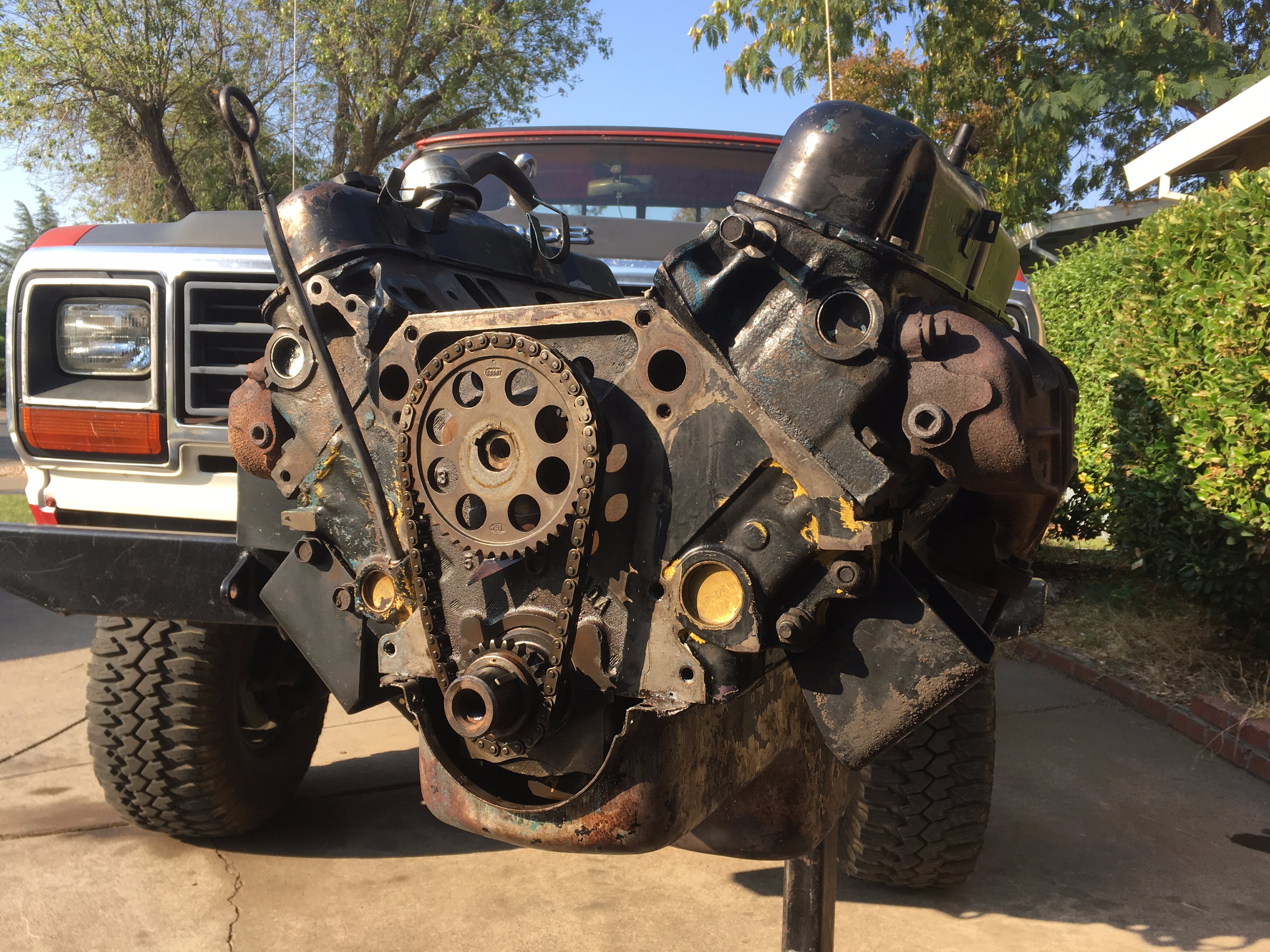

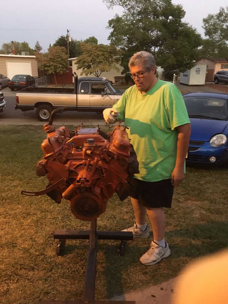

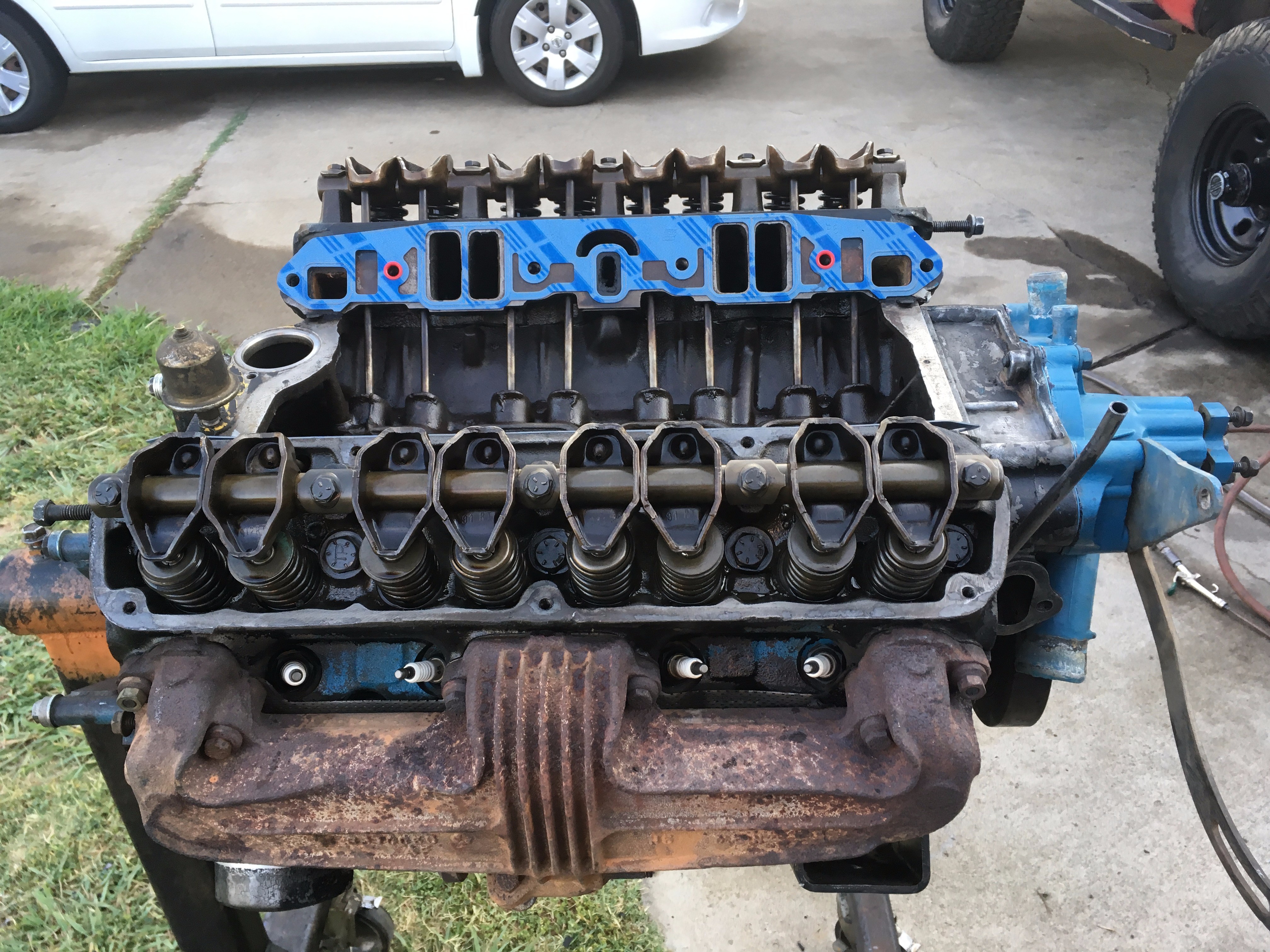

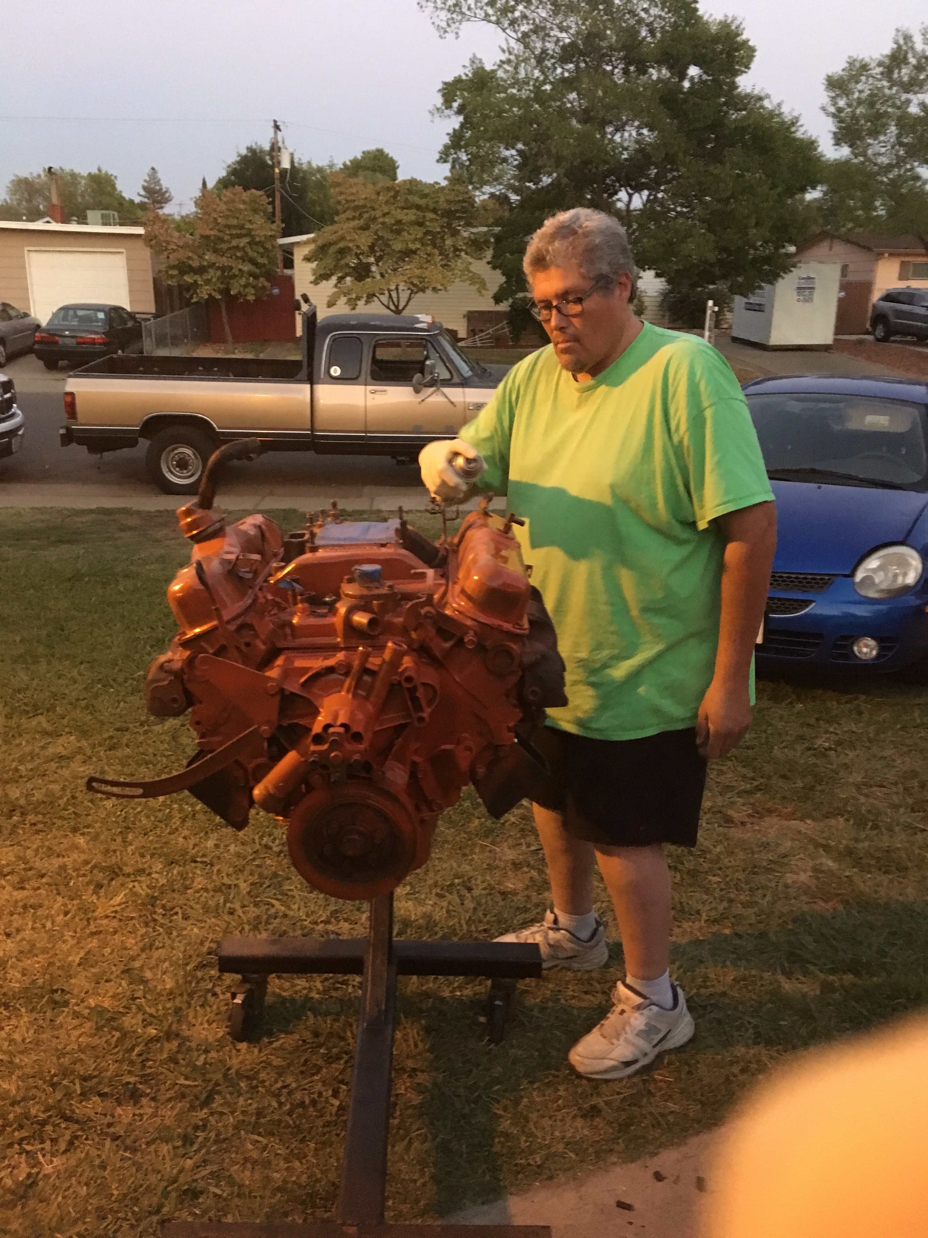

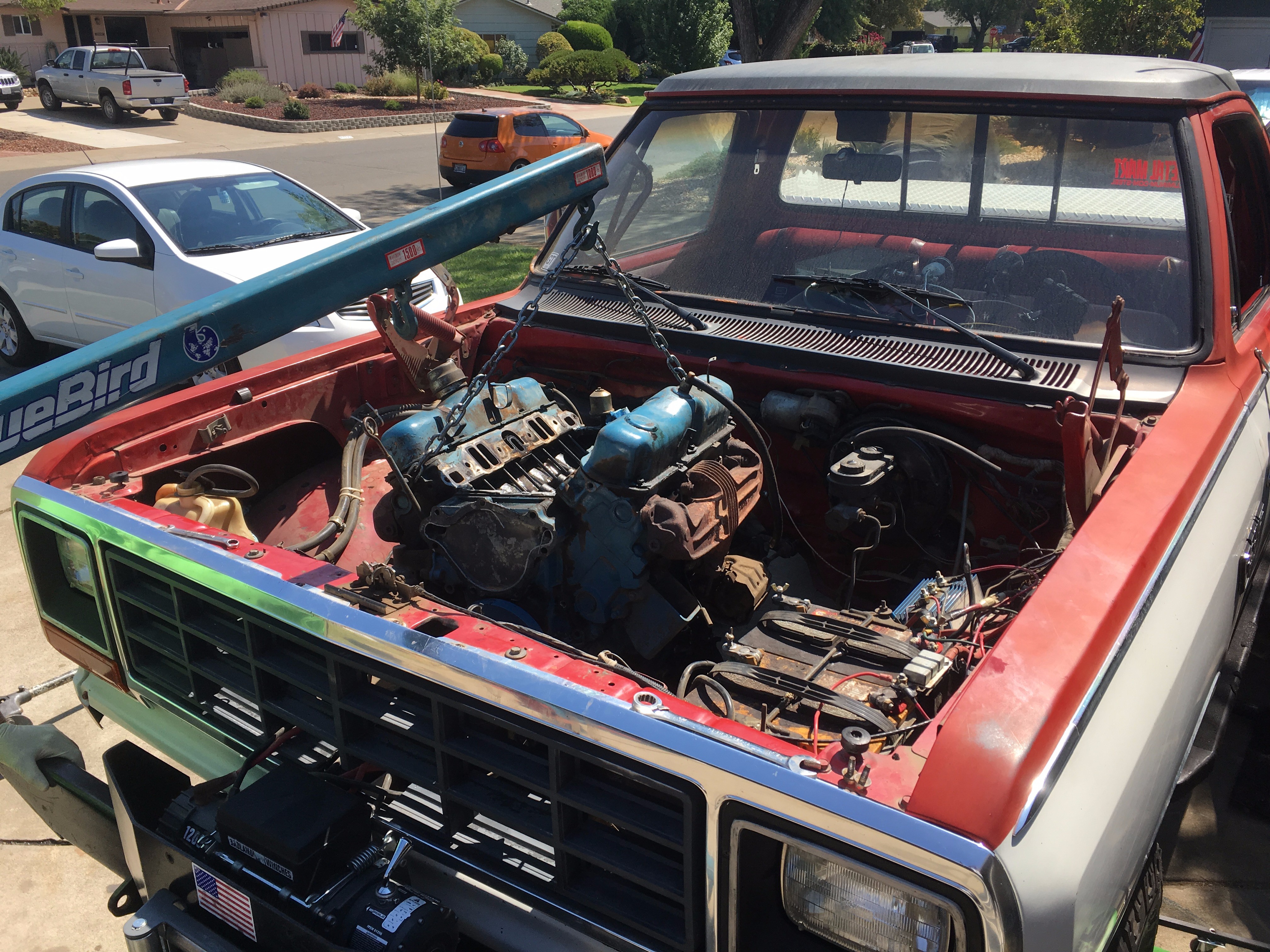

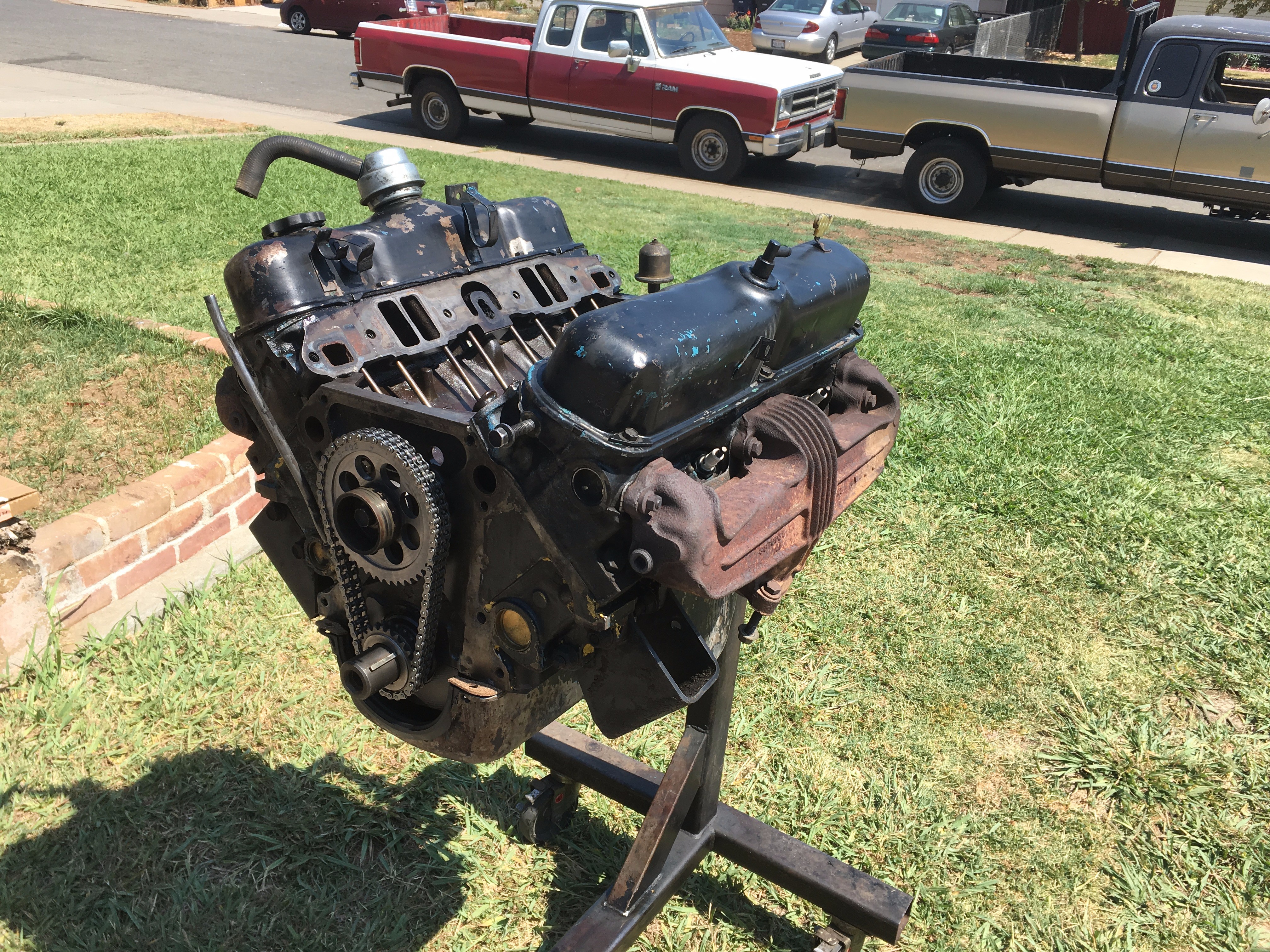

    I thought it would be fun to document swapping out my 318 for my 360 in my 1985 Dodge.153.JPG154.JPGThis is the 360 cleaned and ready to change oil pump and put a double roller timing chain on156.JPG Got the Chain and pump on157.JPG got timing chain cover and water pump on and ready to put intake manifold on168.JPG169.JPG intake manifold and valve covers are on and ready to paint170.JPG171.JPG Lew Painting the engine Chrysler Hemi Orange of course (Ha Ha)172.JPG176.JPG      318 before starting removal160.JPG radiator is out, intake is off distributor is out and water pump is off166.JPG more to come later

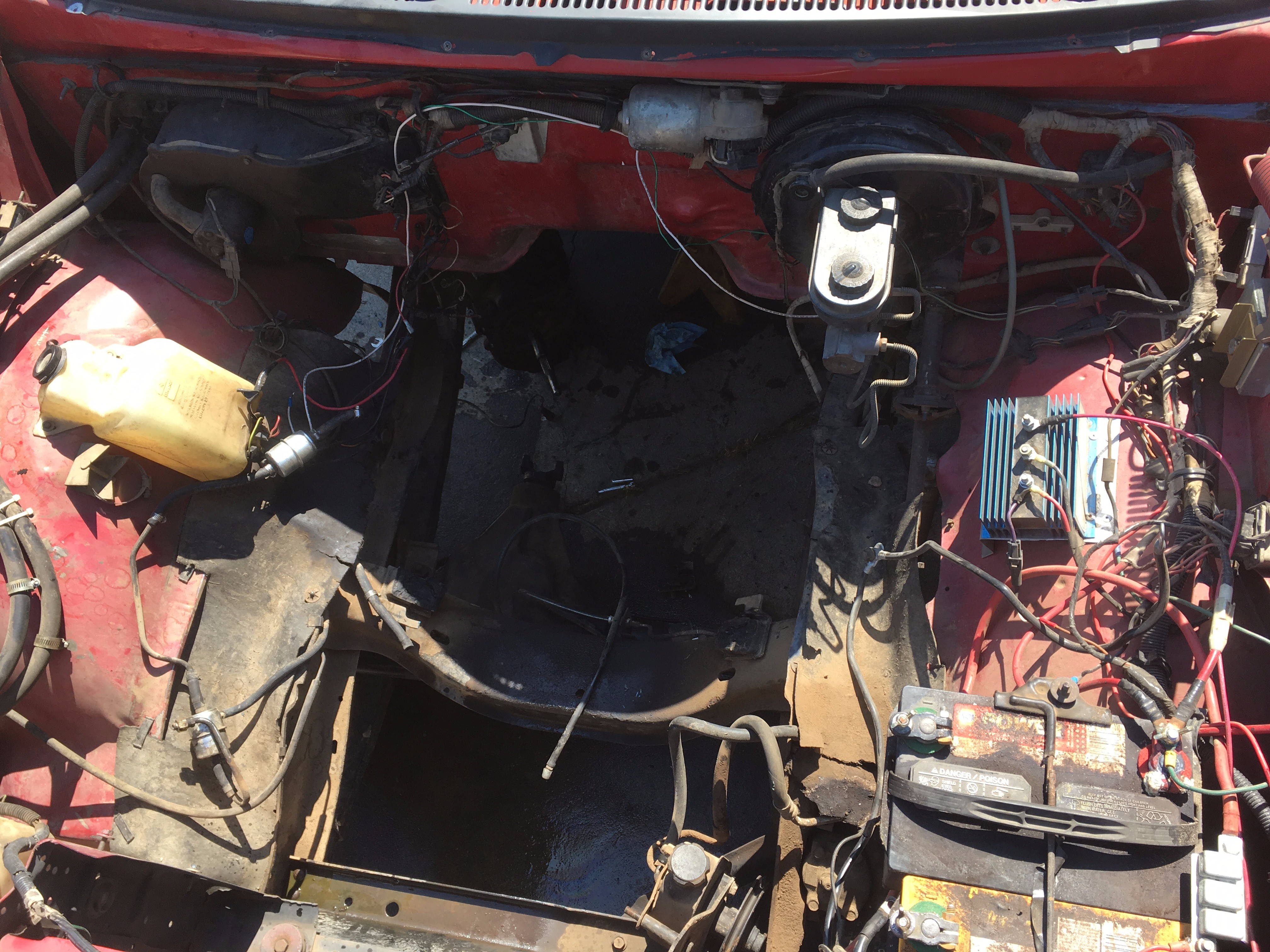

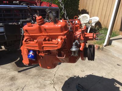

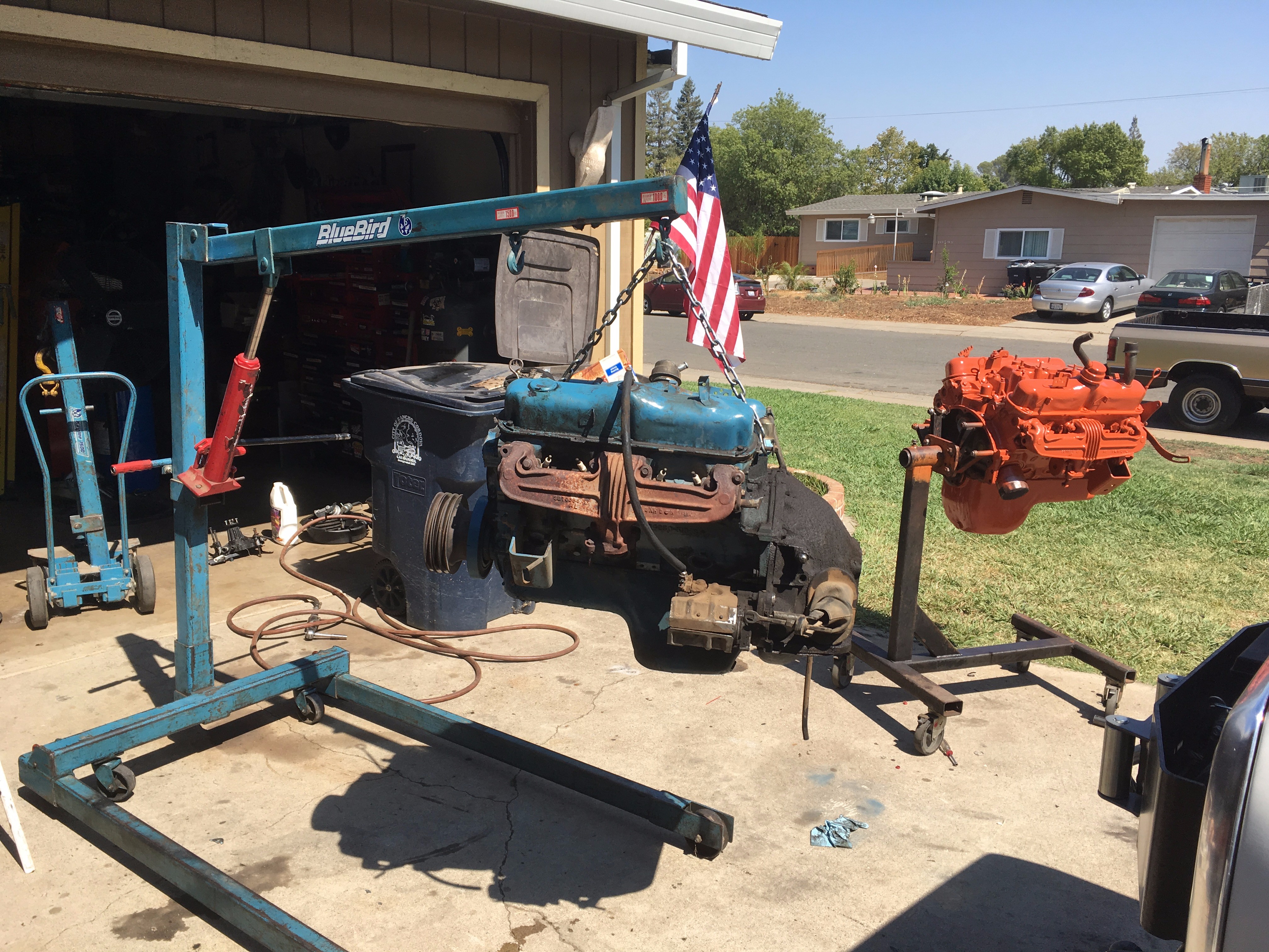

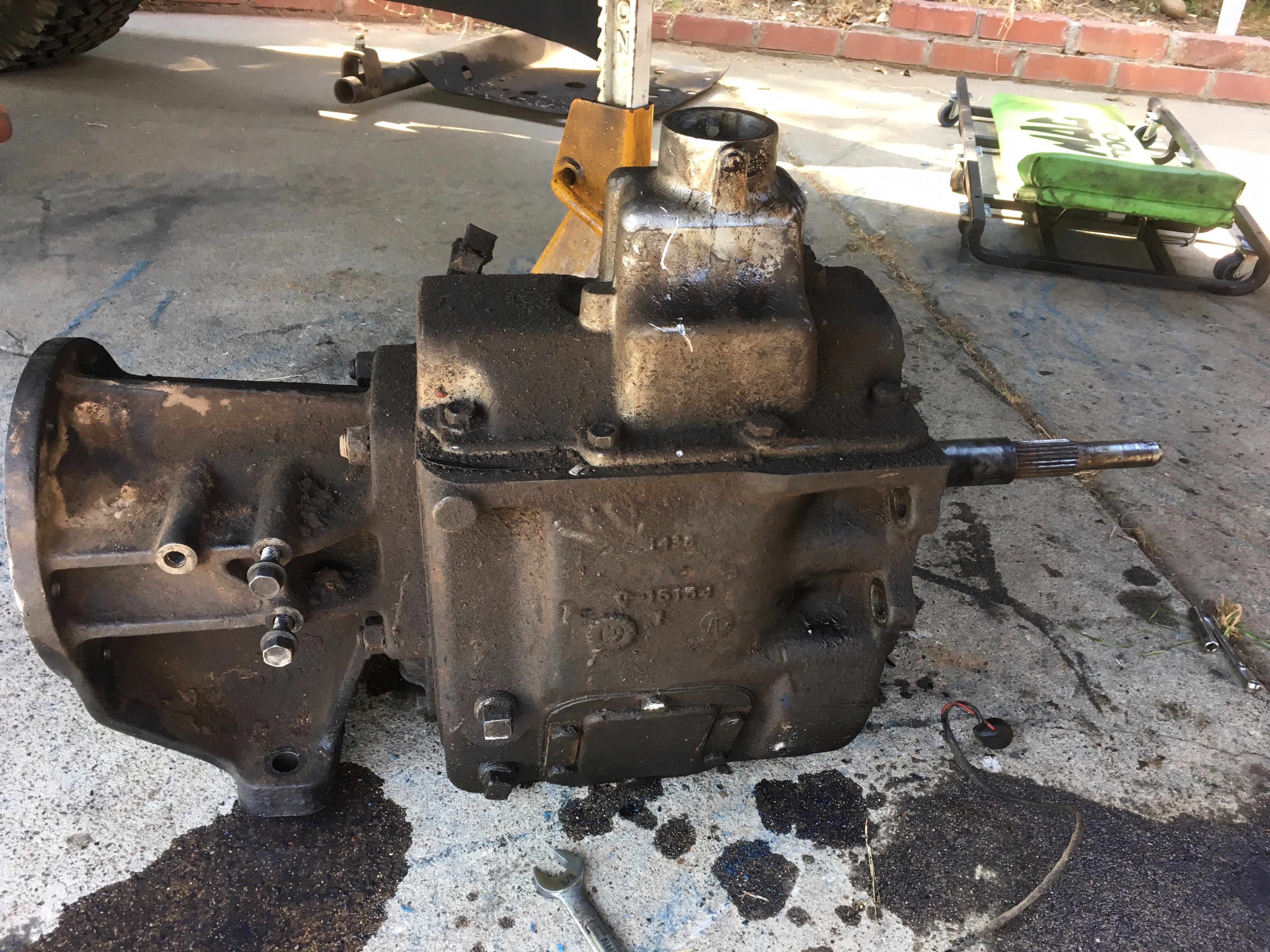

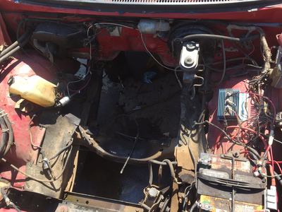

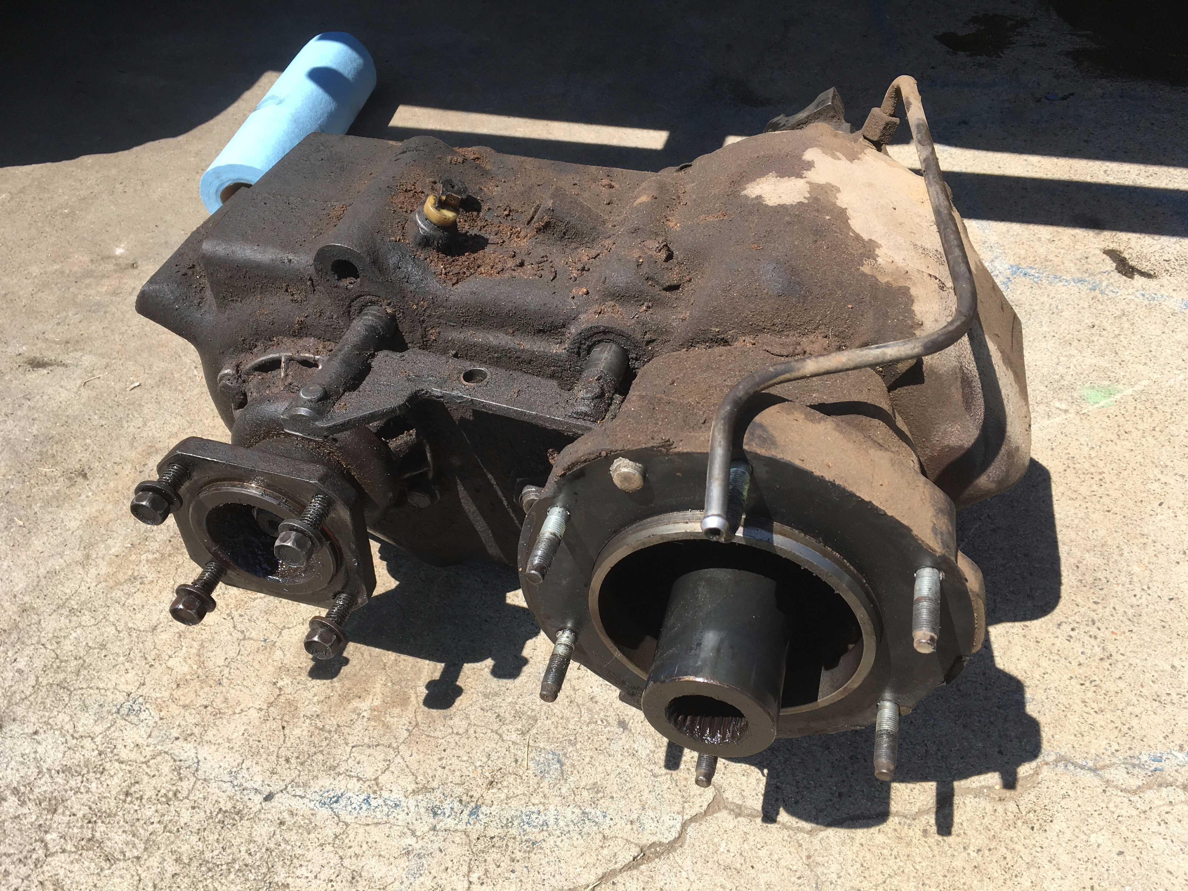

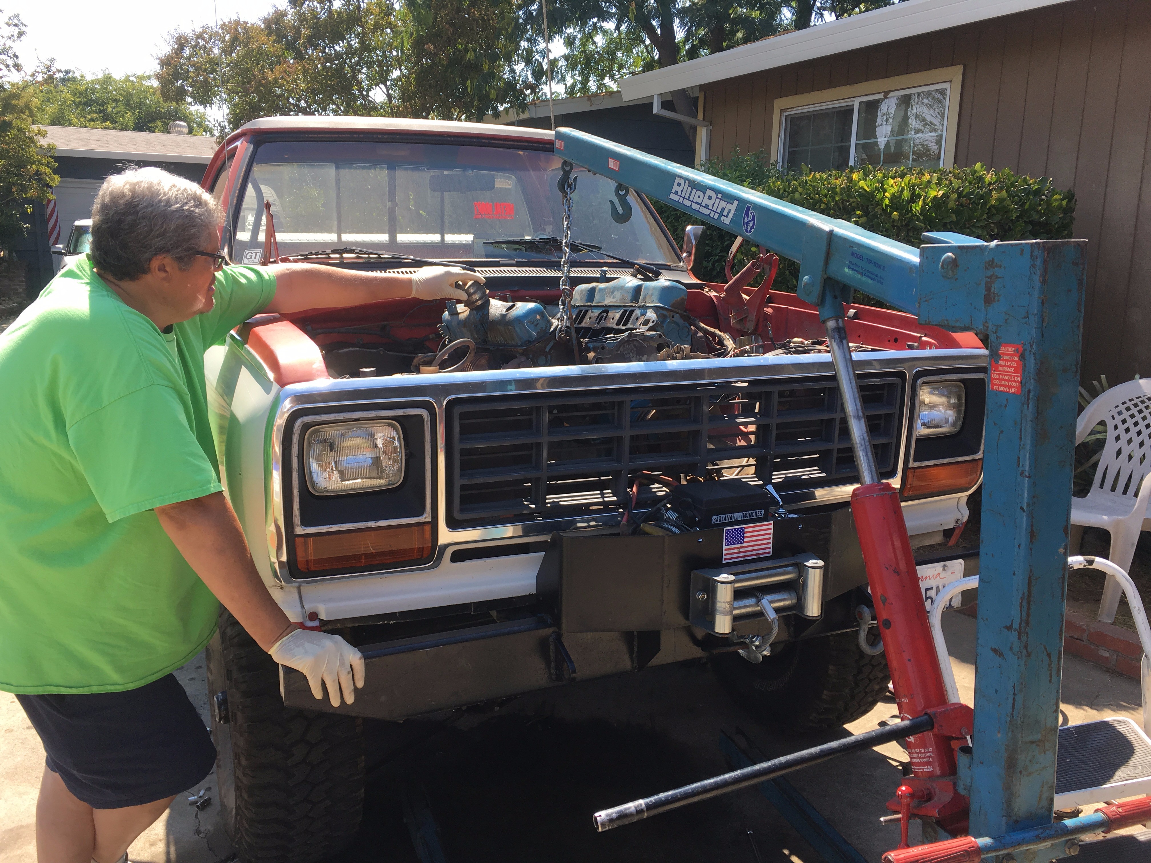

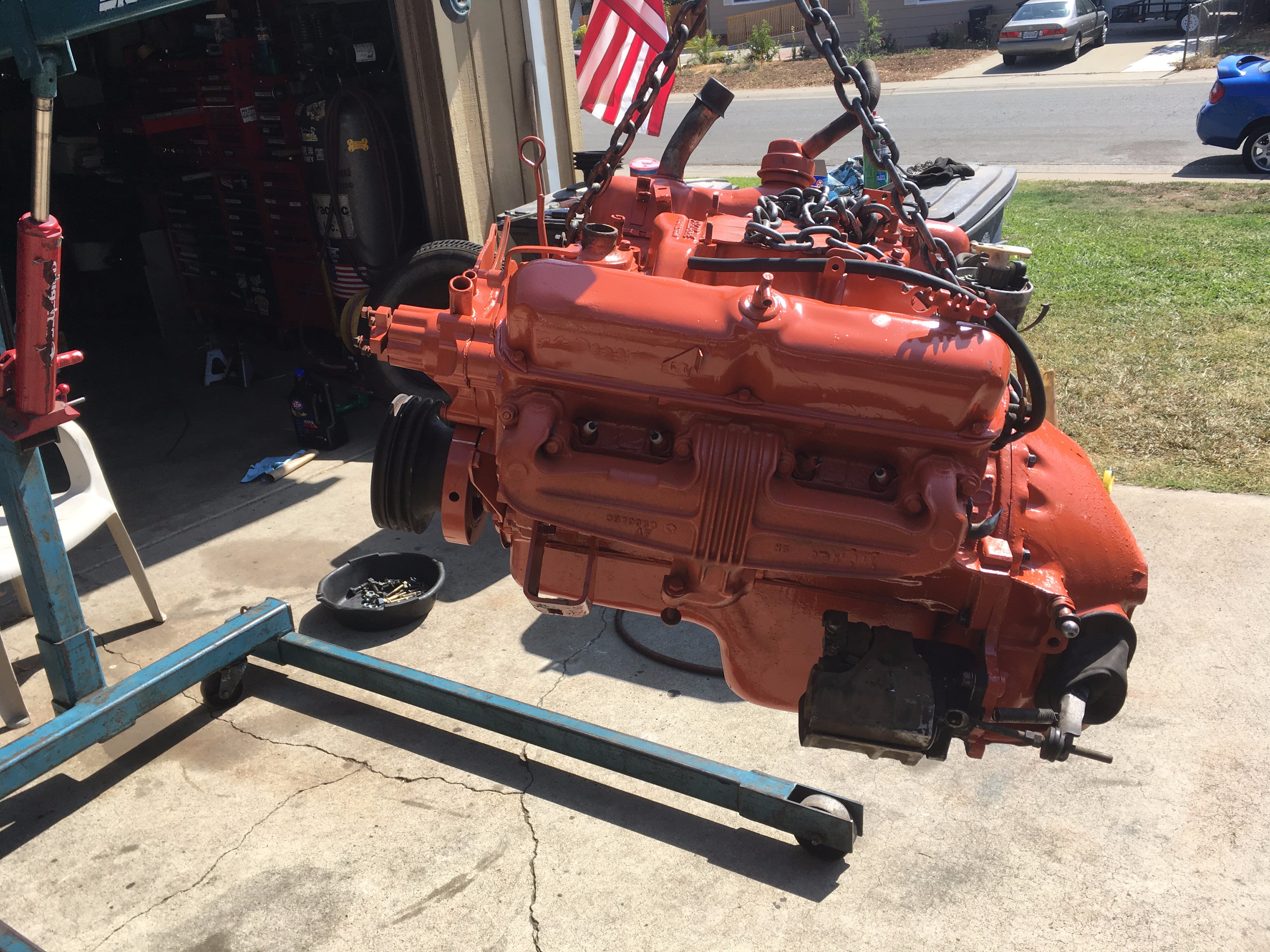

    I got a little farther along on the truck today, the transfer case, transmission and engine are all out, now only a open hole where it all should be.                                               The orange engine is the 360, ready to go back in177.JPG178.JPG                                                                                                           Lew and me pulling the 318 out180.JPG181.JPG                                                                                                                             Victory, the 318 is out182.JPG                                                                                                                                                                                      the empty engine compartment187.JPG                                                                                                                                                                          the NP 205 transfer case and NP 435 transmission. (Man they are heavy)179.JPG186.JPG                                                                      I found that both engine mounts,( the rubber biscuits,) were ripped in half, got to replace those and put in some kind of travel limiter to prevent future problems.

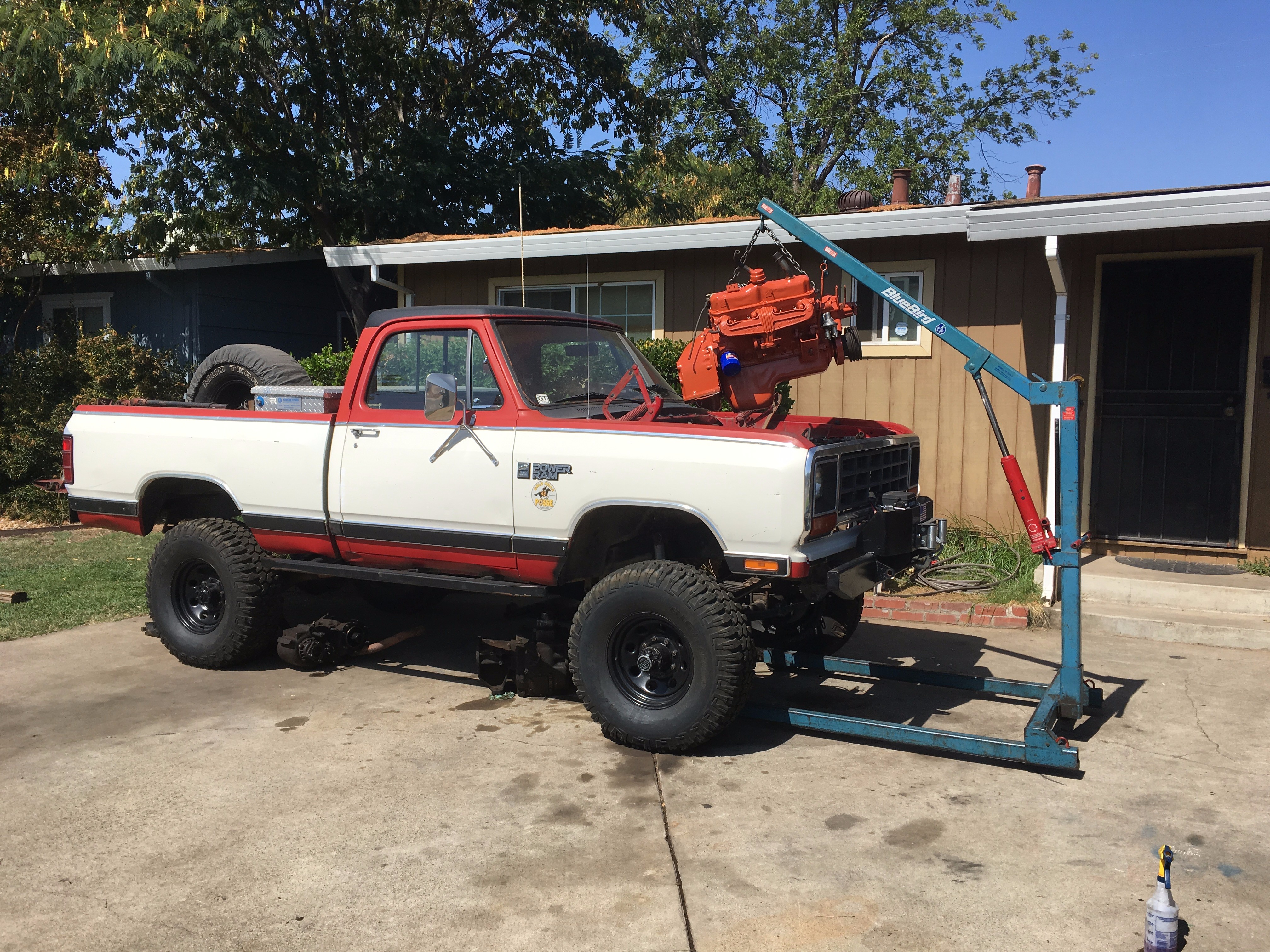

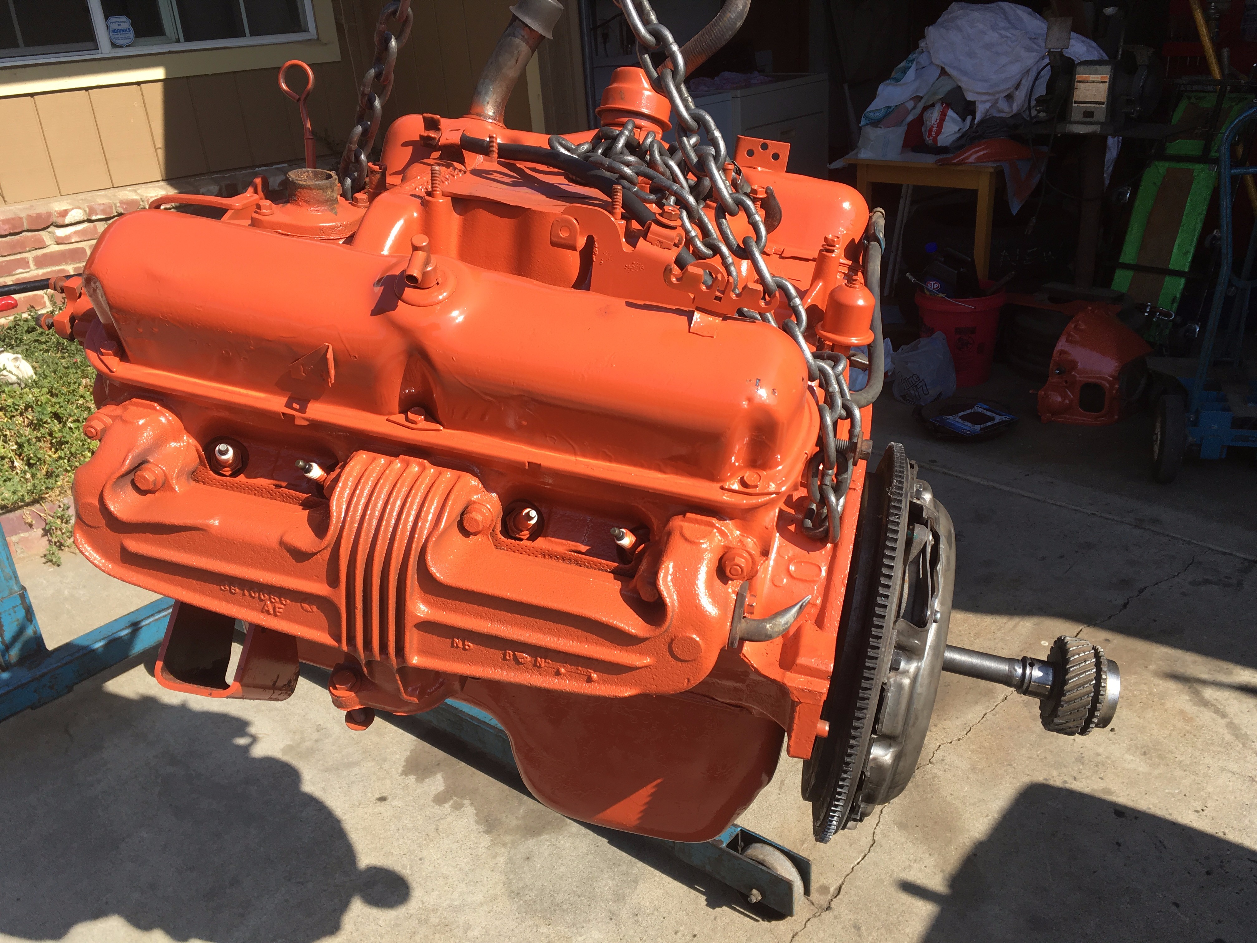

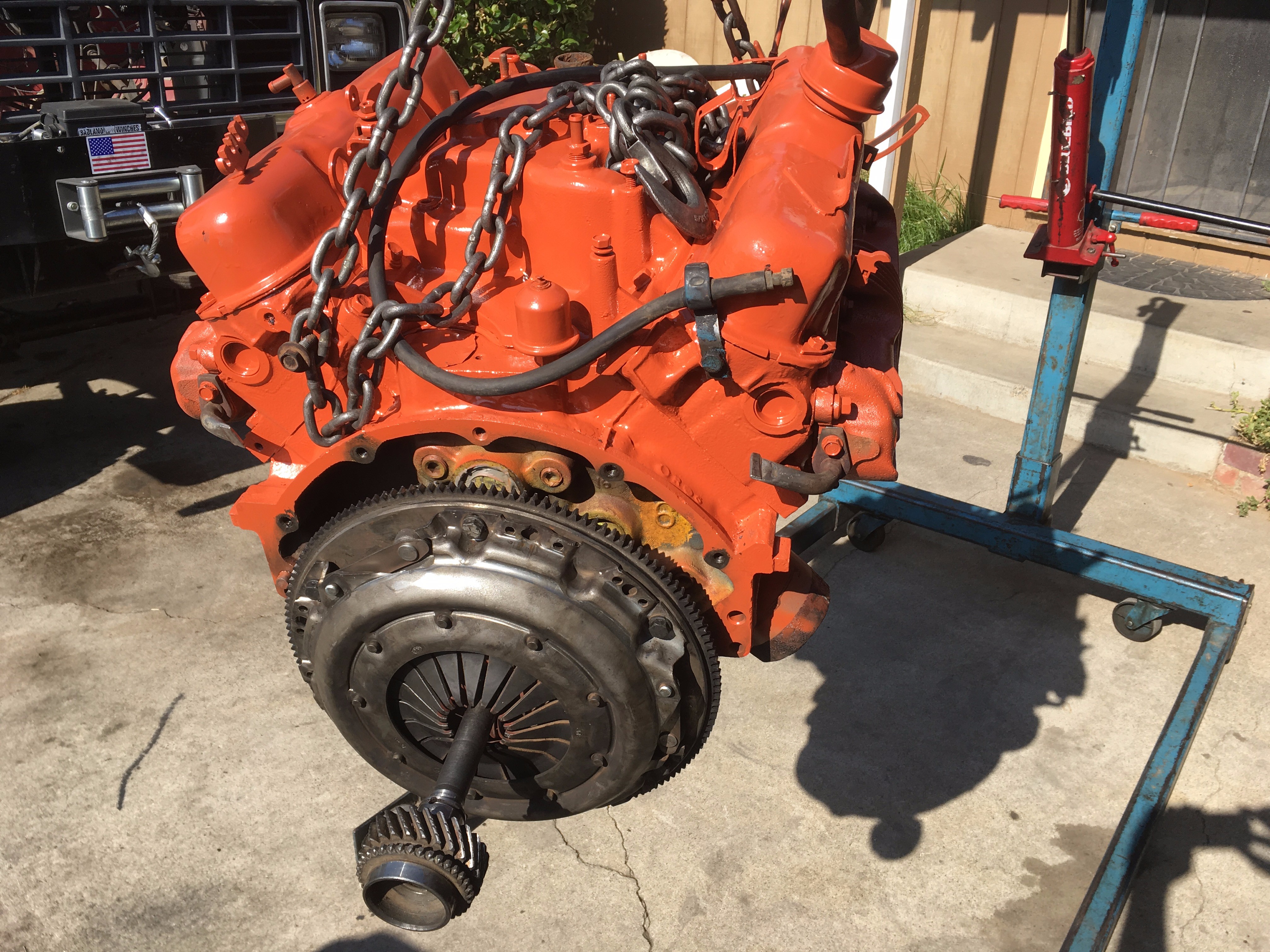

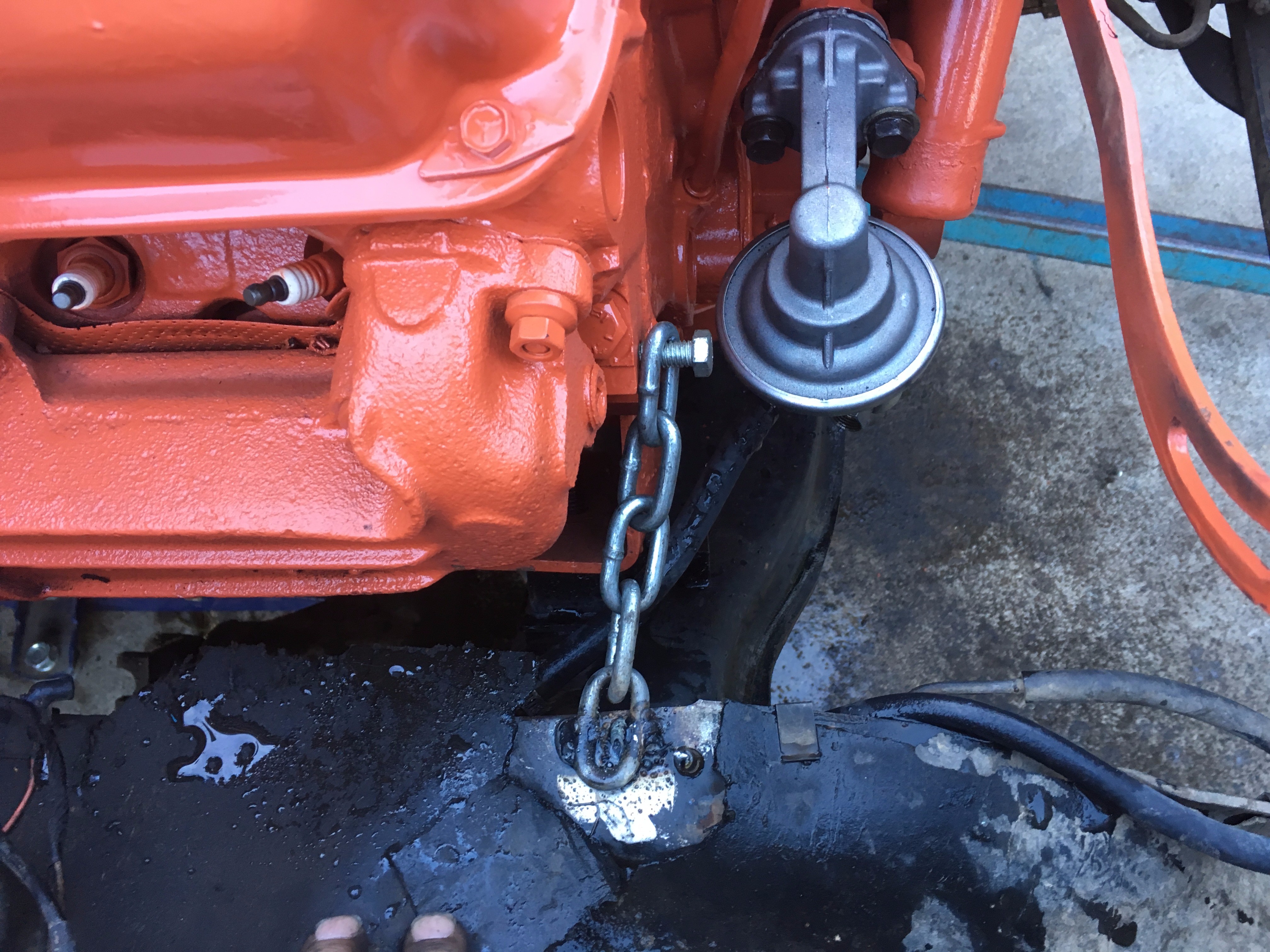

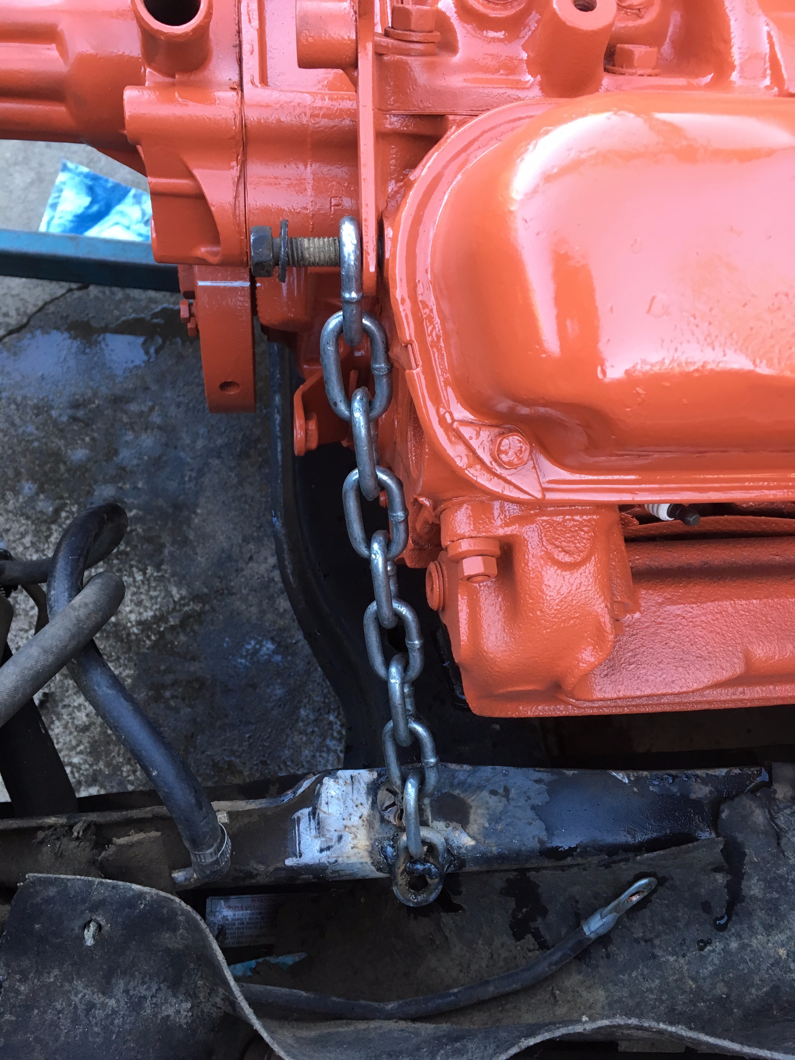

    Well, got a little more done today, welded chains to limit the travel of the motor mounts and test fit the engine, I pulled it back out to put on the flywheel, clutch and bell housing005.JPG. Maybe tomorrow I will have time to do that and put it back in for the last time.😀003.JPG004.JPG

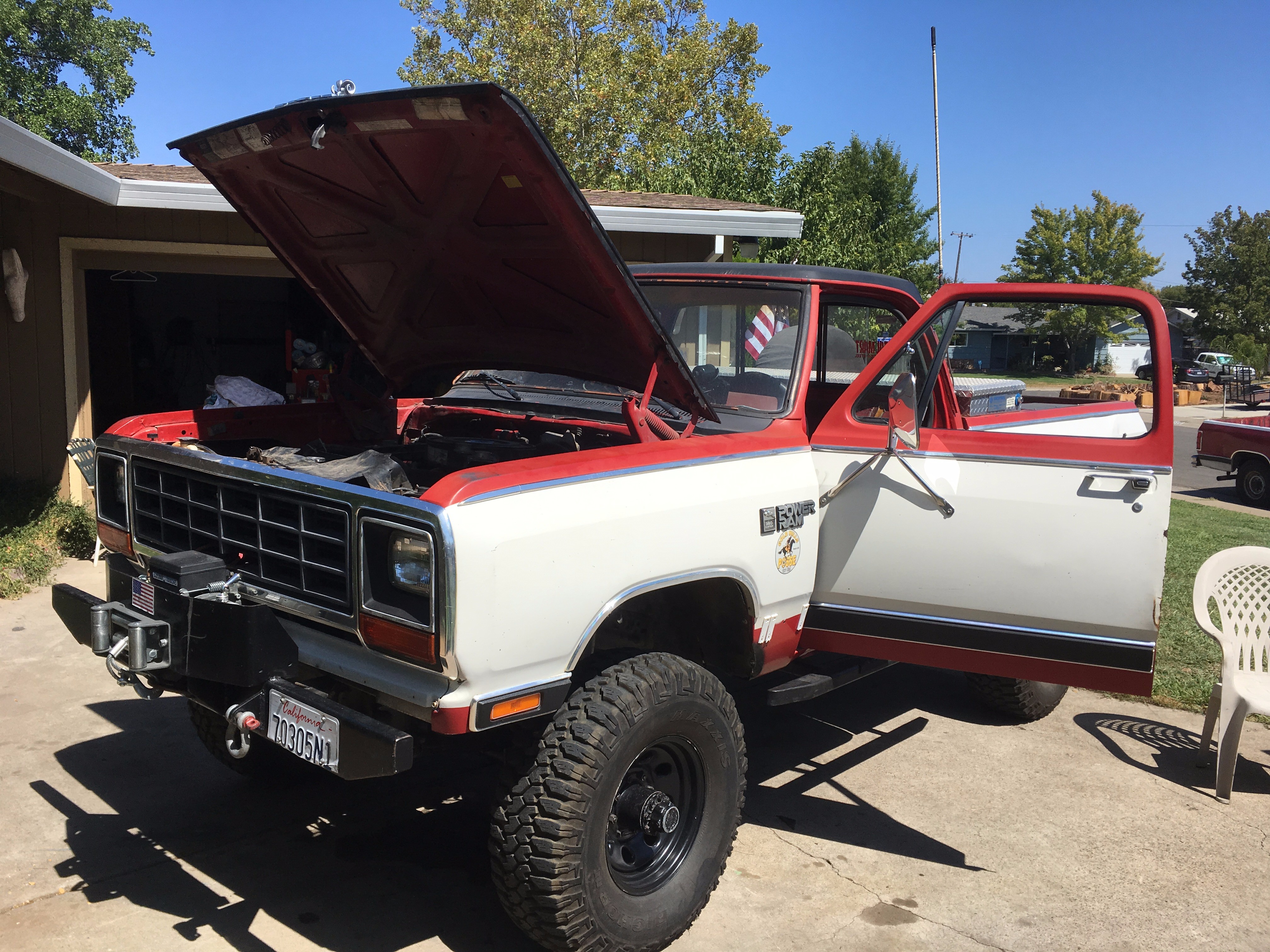

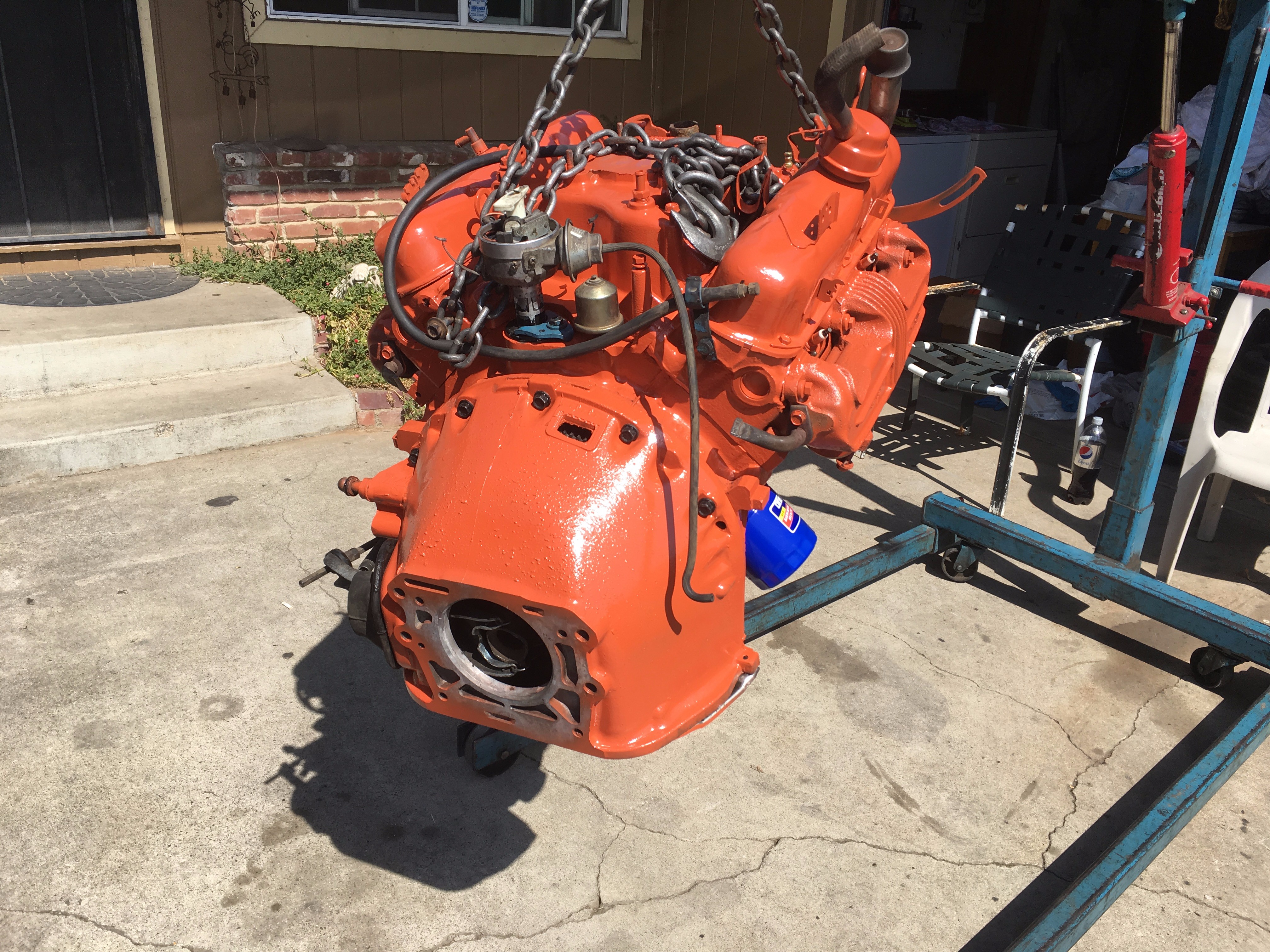

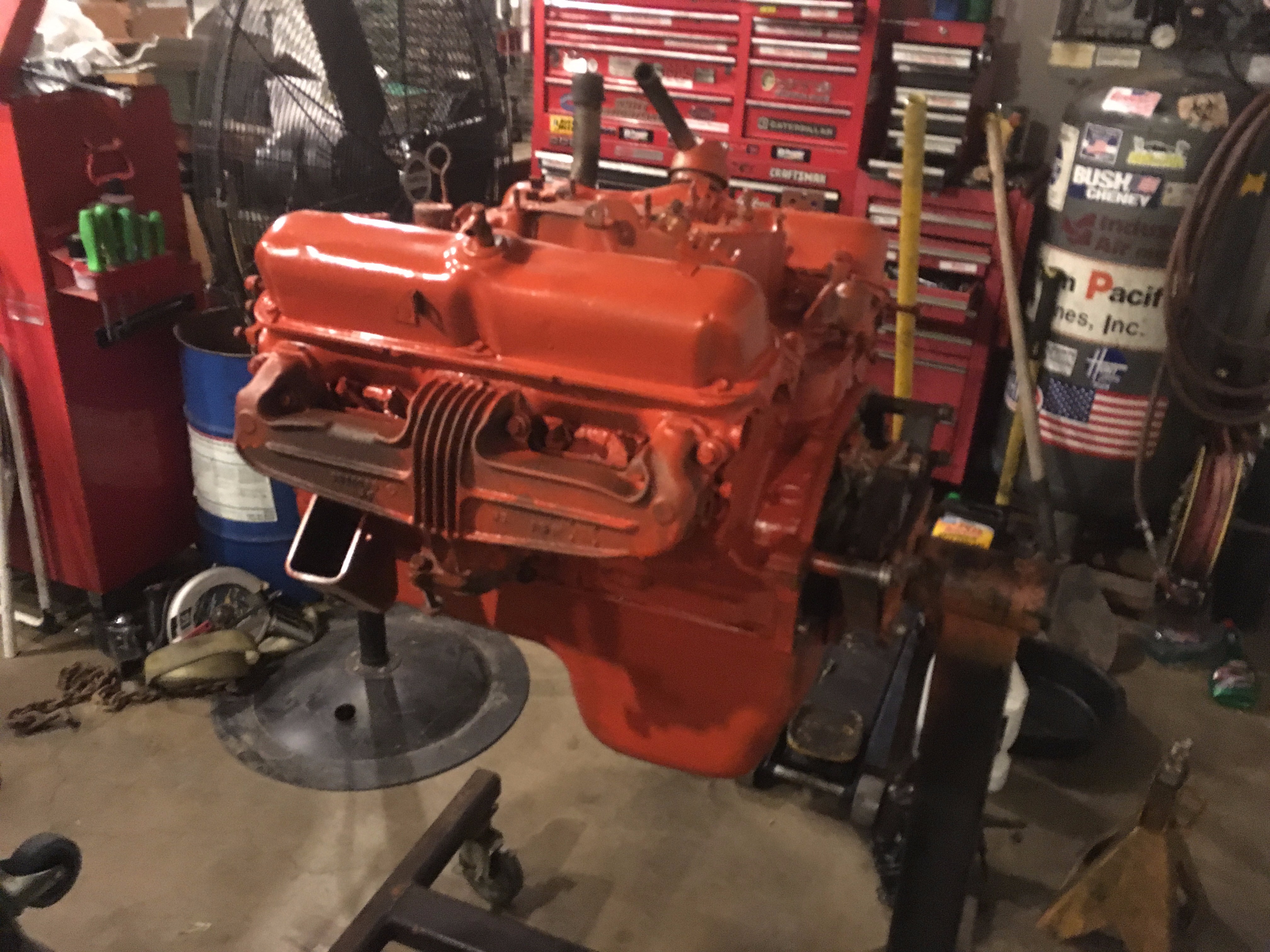

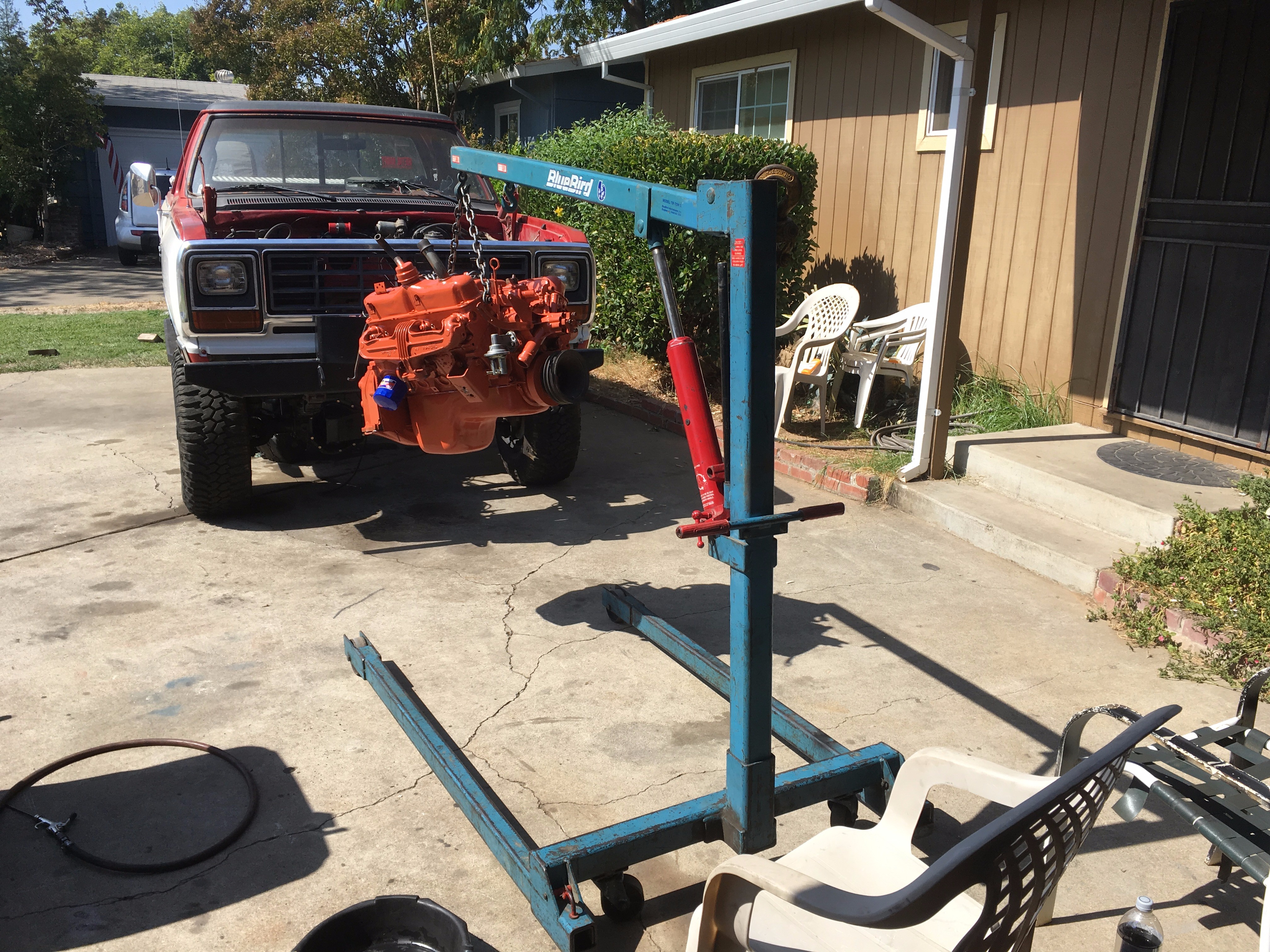

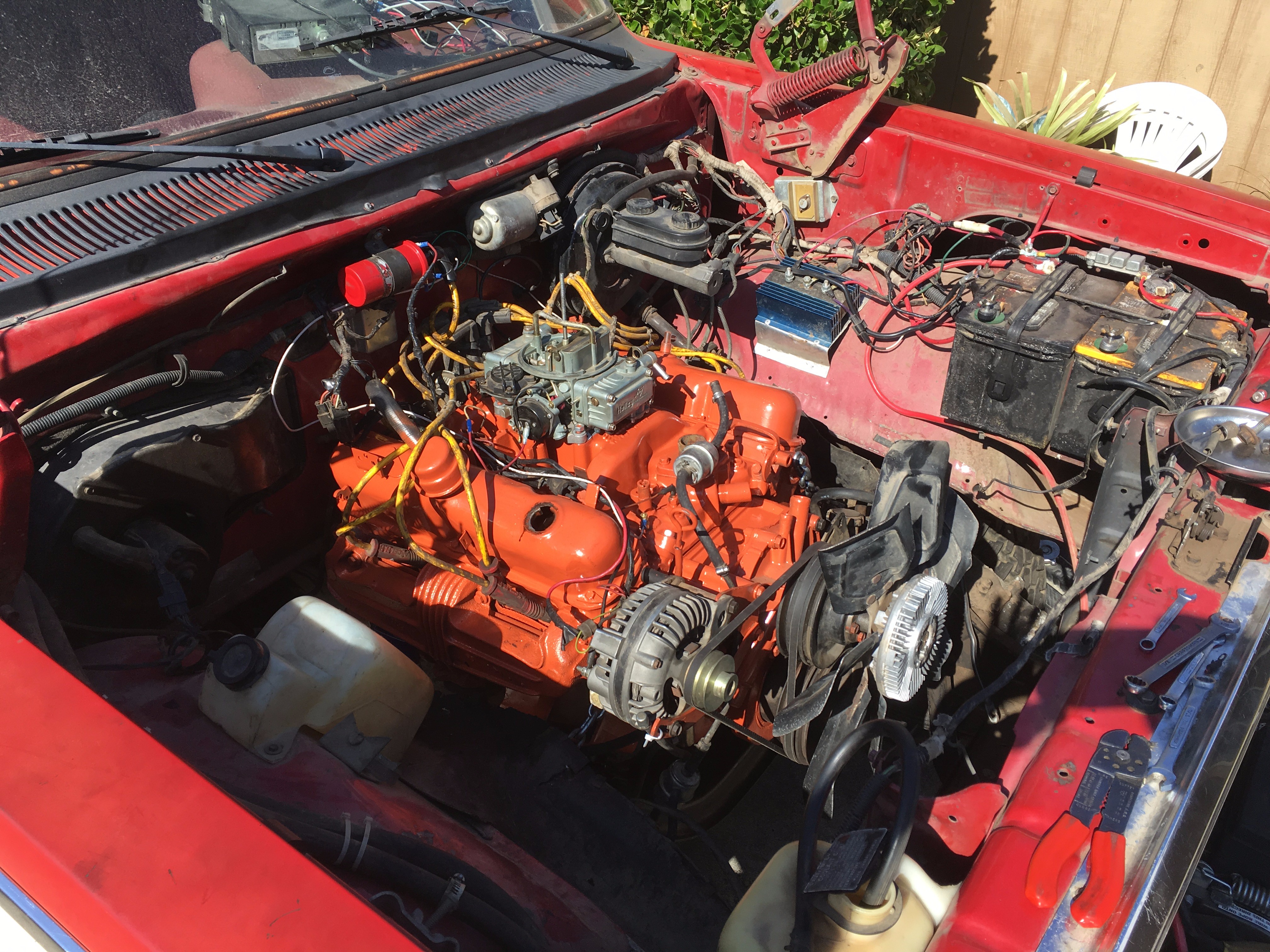

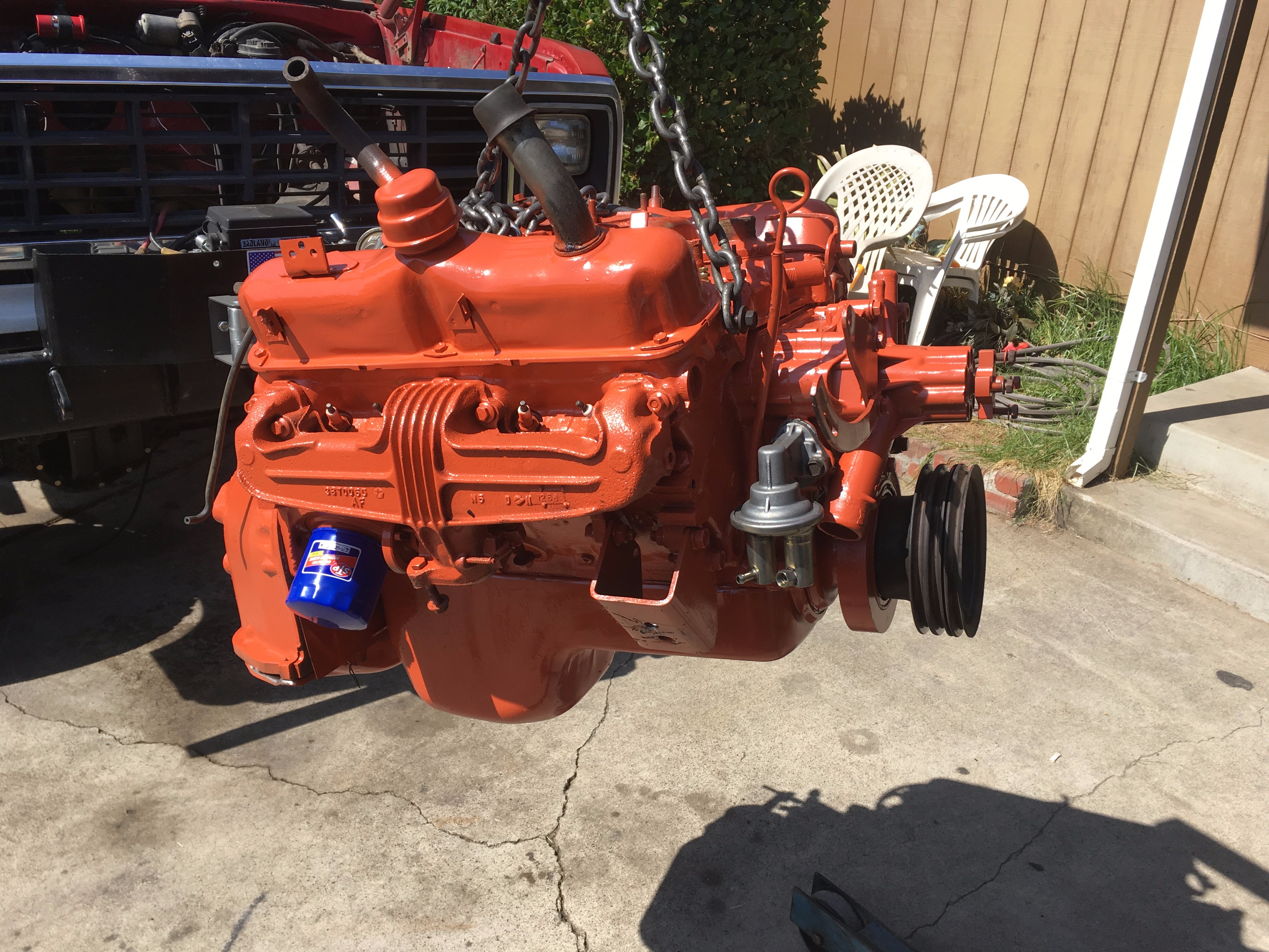

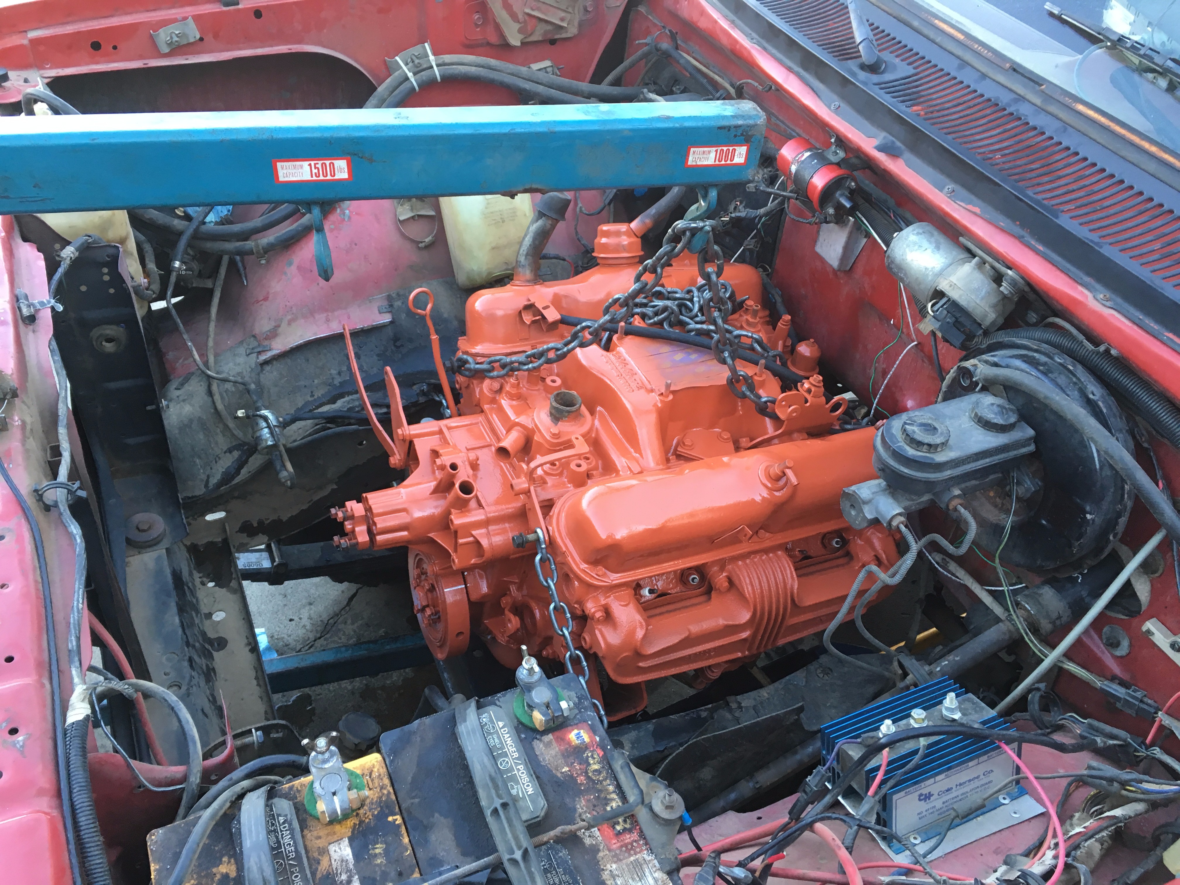

    Flywheel, clutch disk and pressure plate are on001.JPG002.JPG oil filter and fuel pump are on003.JPG004.JPG bell housing and starter are on005.JPG006.JPG putting engine in007.JPG008.JPG all finished with hood on 010.JPG011.JPG It was a lot of work, but it runs great, just have to fix a valve cover leak.
