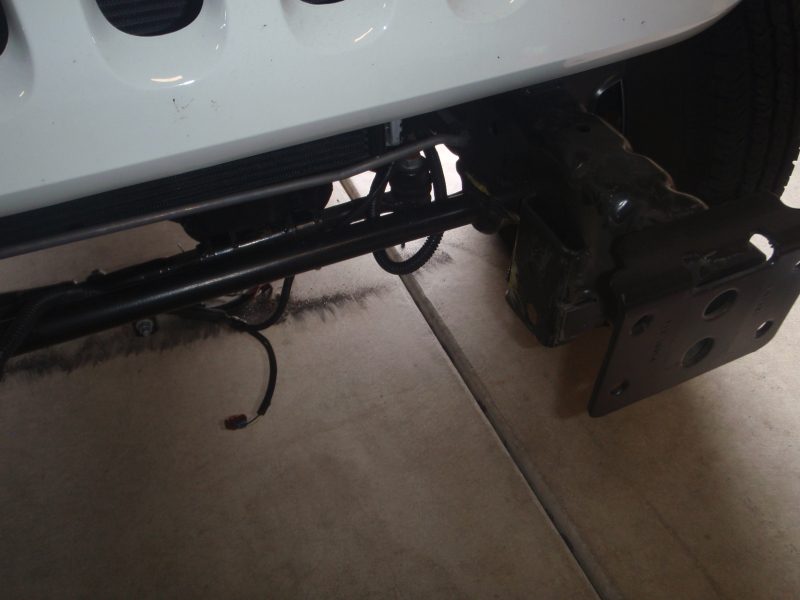

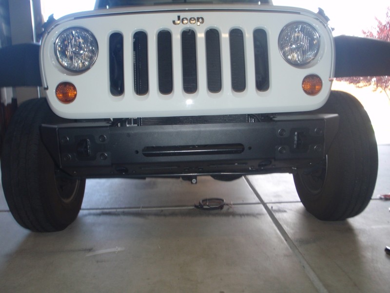

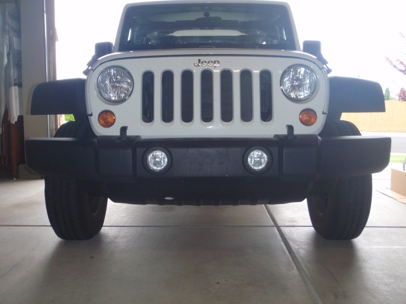

    Finally got around to installing my Metalcloak front bumper.
    Here’s a before of the giant piece of plastic that comes stock.
    https://posse4x4.org/wp-content/sp-resources/forum-image-uploads/k-jeep/2014/04/P4270261.JPG

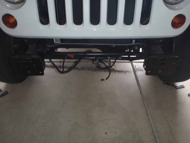

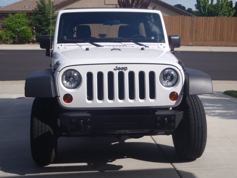

    Stock bumper removed.
    https://posse4x4.org/wp-content/sp-resources/forum-image-uploads/k-jeep/2014/04/P4270262.JPG

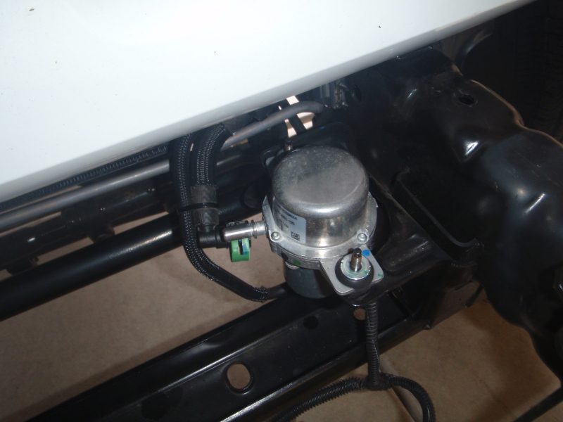

    2012+ models have a vacuum canister mounted on the inside of the frame.
    https://posse4x4.org/wp-content/sp-resources/forum-image-uploads/k-jeep/2014/04/P4270263.JPG

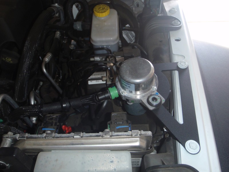

    Here is the vacuum canister relocated up under the hood using a bracket from OR-Fab.

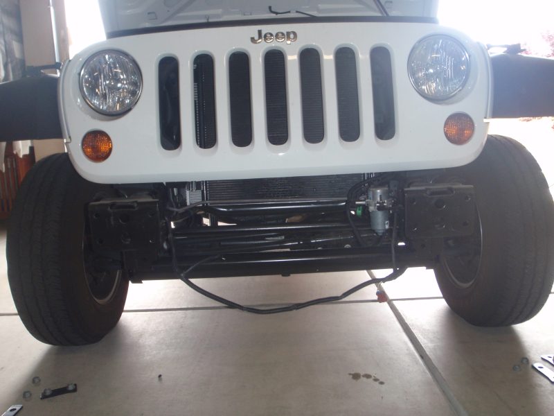

    The Metalcloak bumper required the removal of the vacuum canister bracket and crossbar.
    https://posse4x4.org/wp-content/sp-resources/forum-image-uploads/k-jeep/2014/04/P4270267.JPGhttps://posse4x4.org/wp-content/sp-resources/forum-image-uploads/k-jeep/2014/04/P4270268.JPG

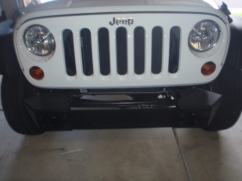

    Here is the new bumper installed. A winch will fill the giant hole at some point. https://posse4x4.org/wp-includes/images/smilies/icon_smile.gif
    https://posse4x4.org/wp-content/sp-resources/forum-image-uploads/k-jeep/2014/04/P4270271.JPGhttps://posse4x4.org/wp-content/sp-resources/forum-image-uploads/k-jeep/2014/04/P4270273.JPGhttps://posse4x4.org/wp-content/sp-resources/forum-image-uploads/k-jeep/2014/04/P4270274.JPG

    #227 Apr 2014, 4:12 PM
    Looks awesome Kevin!!
    Did you have to extend the vacuum lines at all to get the pump all the way up under the hood? What a great place for it.
    #328 Apr 2014, 1:10 AM
    Gregulator said Did you have to extend the vacuum lines at all to get the pump all the way up under the hood?
    Just the wiring. The vacuum line comes down from up above so you end up removing a section of it.
