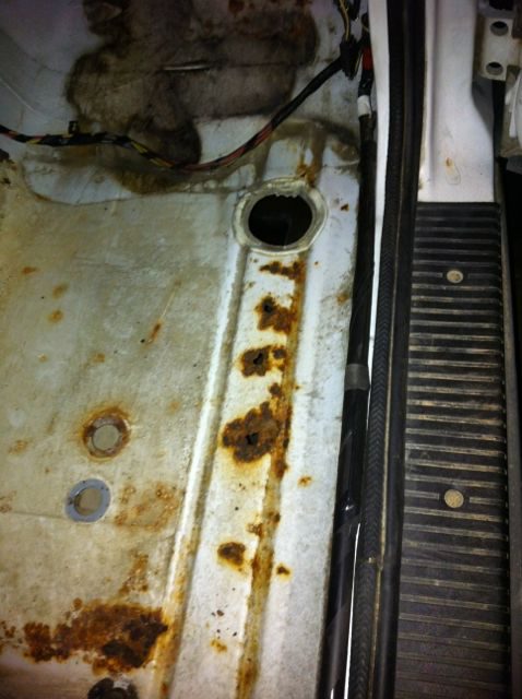

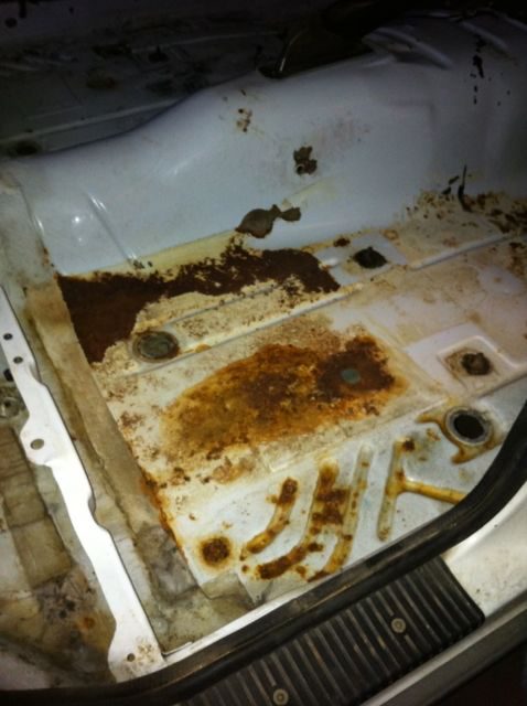

    Before starting on the headliner project, I thought pulling the seats and carpeting up would be a good idea. Give me lots more room and see what it will take to repair the leak on the passenger side, front. Here's what I found ...

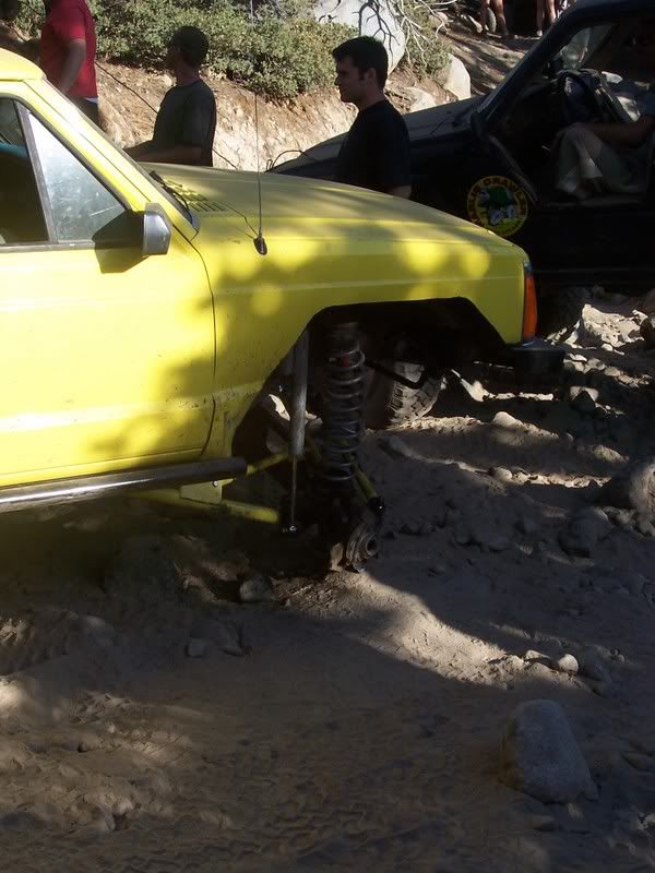

    I found this as I was looking through my pictures of my pathfinder runs. This was an xj that had the whole knuckle ripped off leaving him sitting right in the middle of the Rubicon Trail on Labor Day weekend. It took him two days to catch up with us in camp at Buck Island. They tore down another jeep to rebuild his axle so they could drive it out to Loon Lake then they had a quad drive the axle end back in to the jeep they tore down leaving them to hoof it from Loon to Buck. Just an FYI

    "Path 88" wrote: I found this as I was looking through my pictures of my pathfinder runs. This was an xj that had the whole knuckle ripped off leaving him sitting right in the middle of the Rubicon Trail on Labor Day weekend. It took him two days to catch up with us in camp at Buck Island. They tore down another jeep to rebuild his axle so they could drive it out to Loon Lake then they had a quad drive the axle end back in to the jeep they tore down leaving them to hoof it from Loon to Buck. Just an FYI
    Certainly don't want to be "that guy". What did he do to rip it off? How did he rebuild/modify so it wouldn't happen again?
    #882 Mar 2012, 8:45 AM
    The wrong line? lol
    That had to be one crazy set of days.

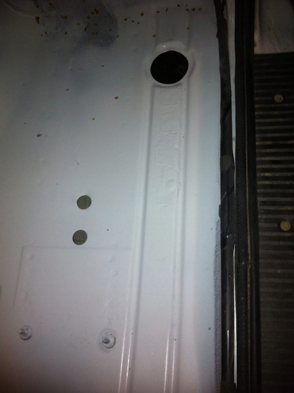

    Thought I'd post a quick "after" picture of my sanding, grinding, and painting before the Herculiner gets rolled on. Gotta love POR 15 and fiberglass.

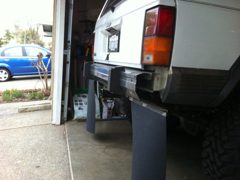

    Oh, and what 4x4 would be complete without OFFICIAL CHP/Elk Grove PD approved mud flaps!! 🕺
    #9127 Mar 2012, 12:37 PM
    The floor looks awesome...
    The flaps not as much. 😁
    Do your tires stick out that far?

    "JohnDF" wrote: The floor looks awesome...
    Thanks. It took me WAY longer to get everything to bare metal then I'd originally thought
    Yeah, once I get the full width bumper made I can build the flaps into that. It will be a quick disconnect when I get it all brewed up. At the time I had no flares on as I was doing some fender repair. Once the fender flares are on, then the tires are only sticking out ~2" and I'll take off the mud flaps and see if I can get away with it. Drove it for 8 months all over the state highways and byways with only the flares and never got a second look.
    The tires actually stick out from the fender 4" in back and 5" in front ... 33x13.5/15

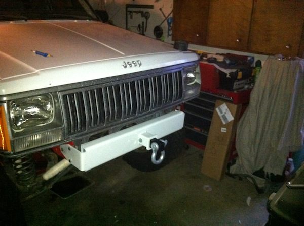

    This is a little out of order, but I just had to put up the pic of my new front bumper ... a buddy made it for me while we were on vacation last week. Better pics later.

    #9910 May 2012, 8:49 AM
    Leave no rock unscathed! I should have sent my work offsite too! 😀
    Nice

    "Wh1t3Nukle" wrote: Leave no rock unscathed! I should have sent my work offsite too! 😀
    Nice
    I was actually good timing on my part. My buddy was looking to improve an internal process and needed a non-standard item to go from engineering, to laser cutter, to break to welding to powder coat. We designed this over a beer one evening. The rear we did the next day at lunch so he had 2 that would be put between standard production items ... my gain x2!!
