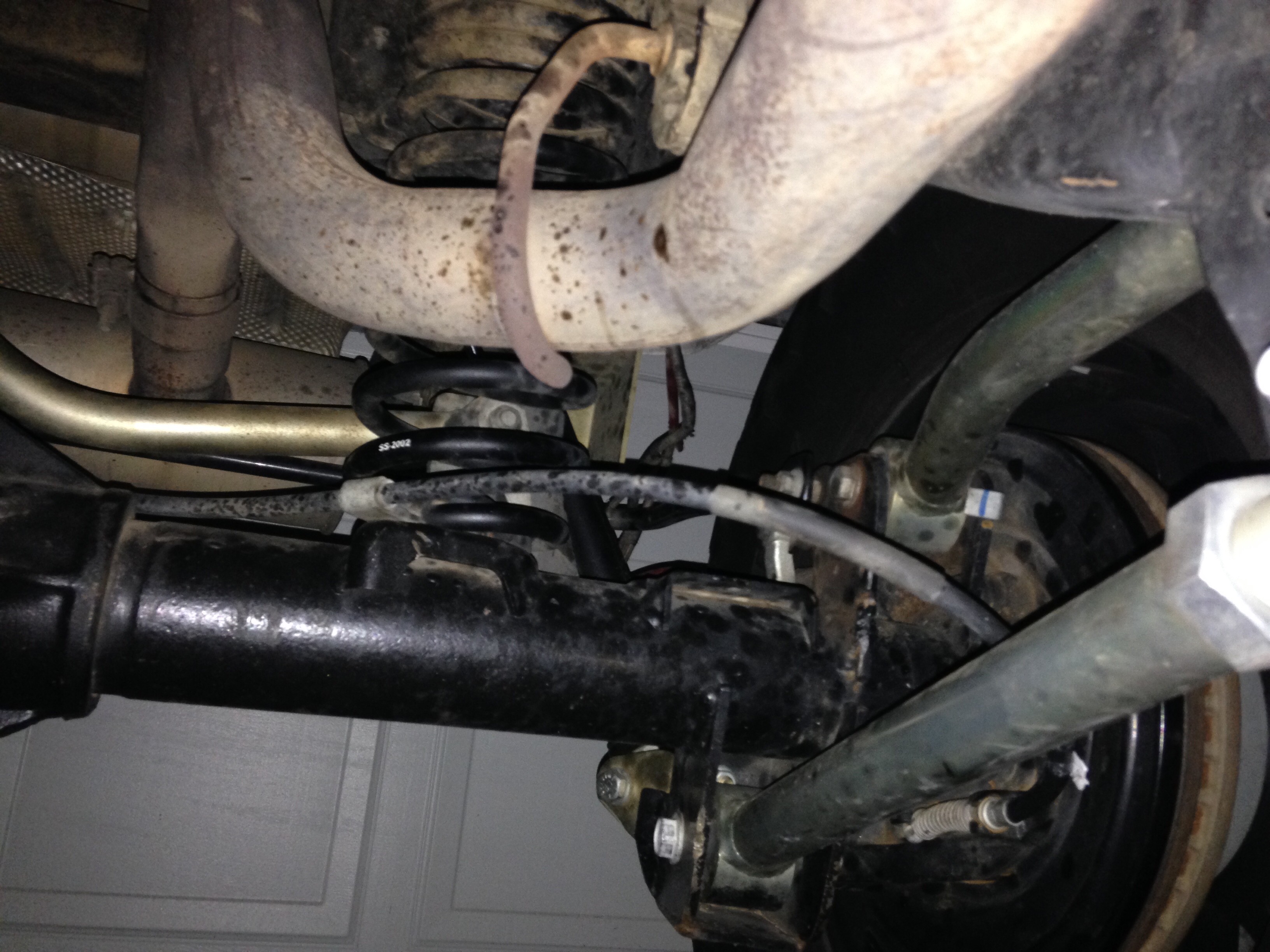

    #8228 Mar 2017, 9:45 AM
    Talked to Trevor at WFO about the brake cable to see why it was mounted under the control arm. I was just curious, you never know, there may have been a legitimate reason for doing it that way. Turns out a customer had his brake cable melted by the exhaust so the tech installed mine below to keep it from melting. I am going to move it back up and zip-tie it so it doesn't contact the exhaust. Mystery solved.

    I'd be interested to see how they were installed. I attached the brake cable tab to the spring retainer bolt. I have a 3"- 4" gap from the exhaust pipe and no sign of melting.

    I have never had a brake/exhaust contact problem and mine is installed similar to Kevin's.

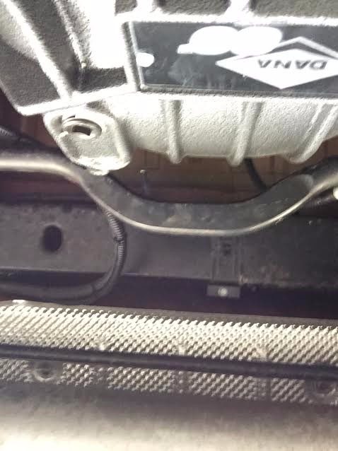

    John, how close is your rear track bar to your diff cover?
    #8829 Mar 2017, 6:57 AM
    Gregulator said John, how close is your rear track bar to your diff cover?
    It's tight but it clears...
    Actually, ALL the clearances are very, very tight with only 3 inches of lift.
    The tie rod, drag link, and track bar bracket are almost touching at full turn and droop.
    It took a lot of "tweaking" by WFO to get everything to fit "just right". But by the time they were done everything fits perfectly and cycles fully without contact.
    Glad I paid to have it done LOL.
