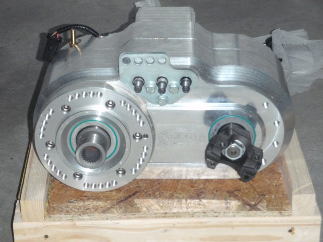

    Here's some details:
    Stak Mini Monster 3 Speed Transfer Case
    4.29:1, 2.44:1, and 1:1

    "kevheb" wrote: Here's some details:
    Very nice! 🍺 I like the options the 3 speed t-case gives you.
    I'm curious, does anyone know if the Stak t-case is compatible with flat-towing the Jeep (without disconnecting the driveshafts)?

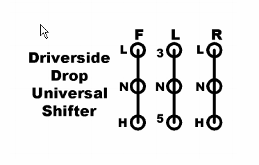

    "FAM" wrote: I'm curious, does anyone know if the Stak t-case is compatible with flat-towing the Jeep (without disconnecting the driveshafts)?
    I couldn't find any specific info but here's the shift pattern. There are 3 neutral positions.

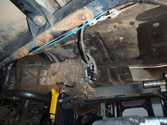

    Old NP231J is out. Had to remove the cat to get to some of the bolts. I'm getting good at that now.
    Only problem I have now is getting the new 153lb t-case up. I need to test fit to see if I have the correct clocking and then final mount. I made one attempt using the floor jack but couldn't get it at the right angle.
    If there's anyone that would like to lend a hand that would be great. I can PM directions.
    Here's a pic of the transmission without t-case...
    #1730 Sep 2009, 9:09 PM
    When? This weekend?
  18. k-jeep started this Member Joined: May 2009
    #1830 Sep 2009, 9:13 PM
    "BKGM Jeepers" wrote: When? This weekend?
    Yeah, I guess a time would help. 😀
    Any time between Friday afternoon and Sunday evening works for me.

    #191 Oct 2009, 12:43 PM
    Rent a transmission jack... That was what I did when I installed my Atlas
    "kevheb" wrote: Old NP231J is out. Had to remove the cat to get to some of the bolts. I'm getting good at that now.
    #201 Oct 2009, 1:17 PM
    "RobD" wrote: Rent a transmission jack... That was what I did when I installed my Atlas
    Would I be able to rent that at a Lowe's or Home Depot or would I need to go somewhere else?
  21. RobD Subscriber
    #211 Oct 2009, 5:20 PM
    I rented mine form a place down at Sierra College and Douglas Blvd..I think it was called "Nations rent." You will just need to call around to rental shops..Most carry automotive tools.

    #221 Oct 2009, 5:24 PM
    Just wondering if you need a 1 inch body lift to make the Stak fit like you do on a TJ..Even with a body lift, I still had to make a nice size dent in my floor to make my Atlas fit..Maybe in a YJ you don't..In a TJ, there just isn't enough room between the floor and the center skid to fit the bigger box..

    #231 Oct 2009, 10:52 PM
    "RobD" wrote: Just wondering if you need a 1 inch body lift to make the Stak fit like you do on a TJ..Even with a body lift, I still had to make a nice size dent in my floor to make my Atlas fit..Maybe in a YJ you don't..In a TJ, there just isn't enough room between the floor and the center skid to fit the bigger box..
    Yeah, I think it will be close. The Stak has a lot of clocking options so I might have to play around to get the right selection.
    #242 Oct 2009, 8:08 AM
    Kevin,
    I think Rob brings up a good point. If you don't know whether the case is a direct bolt in, you should get the jack. If you have to do a lot of hammering, or cutting, pulling the case up and down won't be fun. I had assumed you knew it was a drop in, so we'd only be there an hour or so. I think Rob spent several hours getting his in correctly.
    Let me know.

    #252 Oct 2009, 11:17 AM
    "BKGM Jeepers" wrote: Kevin,
    Let me know.
    Yeah, good point. I'll try the jack option. I'll see if I can find one today. Thanks.
