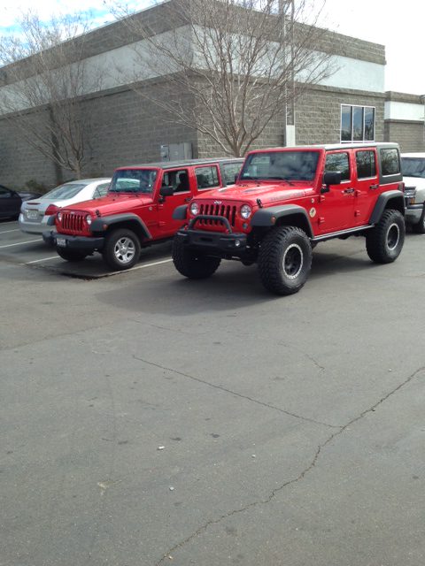

    A fun little comparison pic. . .
    https://posse4x4.org/wp-content/sp-resources/forum-image-uploads/johndf/2015/03/compare.JPG
    #12114 Mar 2015, 2:14 PM
    My Jeep was that little for 3 years. Didn't realize it was that long!
    #12214 Mar 2015, 3:39 PM
    Aww, you found a picture with Gregg jeep! No, wait, his is white!
    Sorry Greg... Im waiting on your build day!

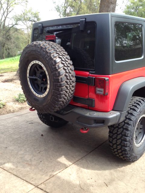

    Spare tire carrier installed. . .
    https://posse4x4.org/wp-content/sp-resources/forum-image-uploads/johndf/2015/03/IMG_4040.jpeg
    #12415 Mar 2015, 8:25 AM
    I also re-programmed my Jeep with the AEV ProCal module. I recalibrated my tire size and turned my TPMS down to "zero". Now my tire pressure reads zero psi but doesn't throw the stupid idiot light on. Super easy to use too.
