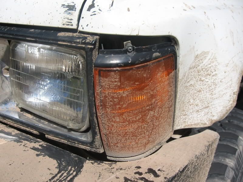

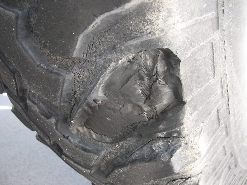

    My only damage, if you could call it that is a broken light tab thing and some missing lugs off my front passenger side tire.
    This is the biggest one i could find. It caused some major death wobble on the way home. Time for some MTR's.
    Oh ya, and i bent the bumper a little bit on the front right when i came up a little too fast on winch hill # 1 and hit that rock.

    That is a wicked gash on the tire! I've got to post a picture now...my parking light looks exactly like that! Must be a Toyota thing! πŸ˜€

    I can see all the pics fine.
    Those are some nasty chunks.
    I'd move the two worst tires to the rear.
    #2349 Jun 2008, 6:25 PM
    Yeah i will do that until i get some new tires.
