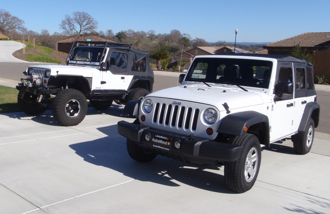

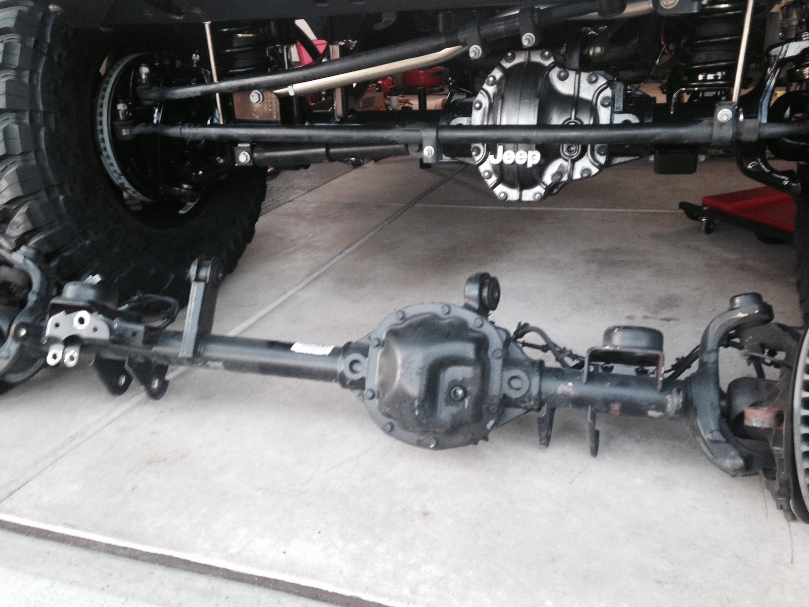

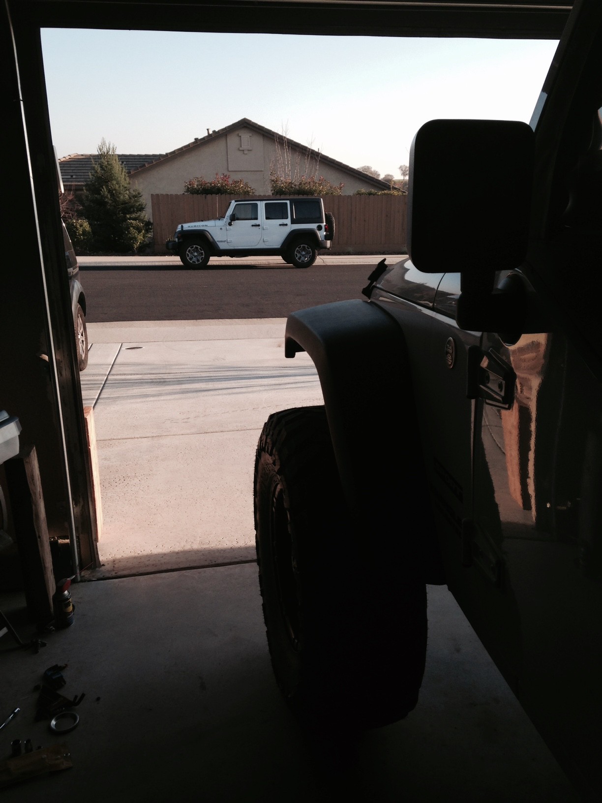

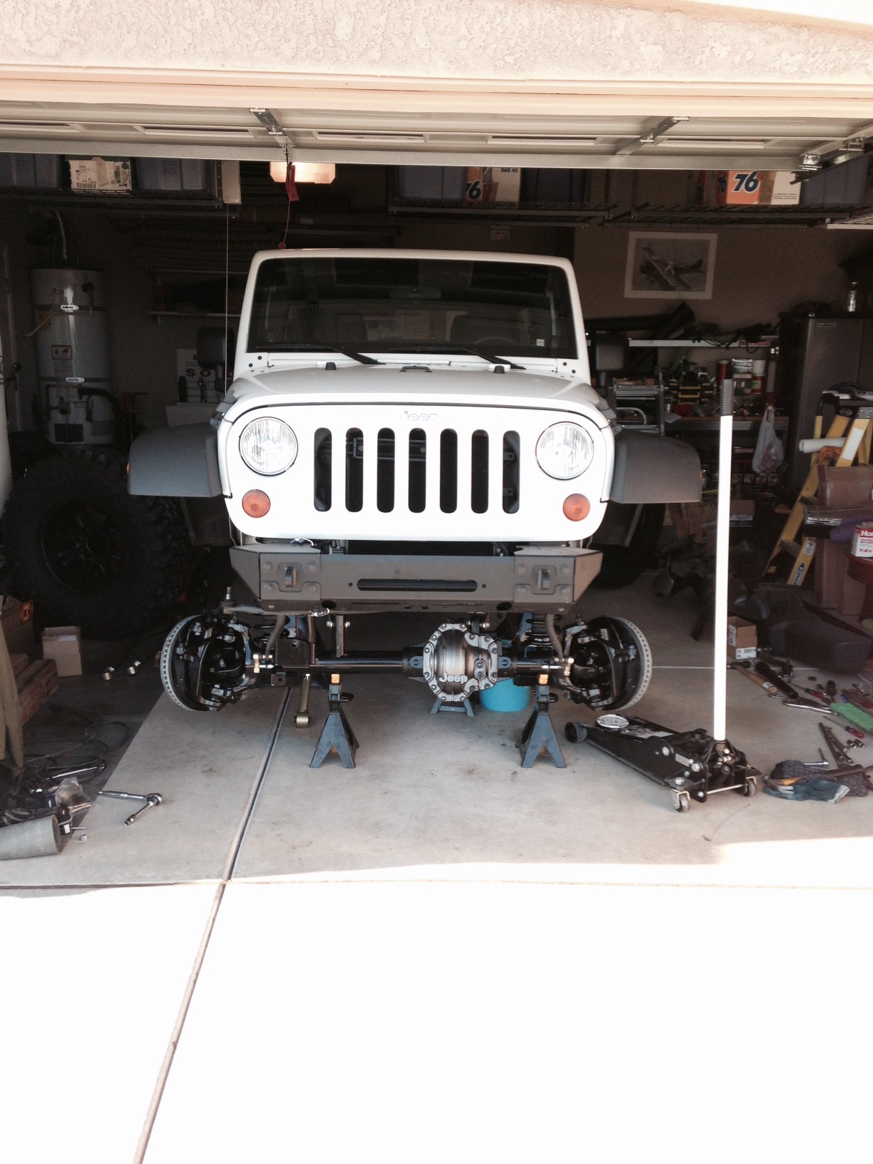

    Here's some pics of the progress...
    Before next to my old Jeep.
    Front axle and suspension removed.

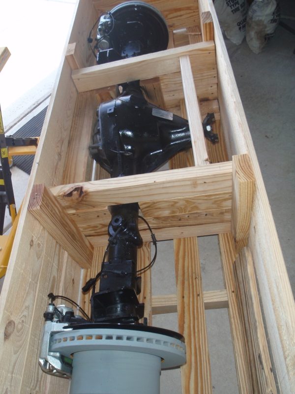

    It's about time!! I have a pictures to add.
    https://posse4x4.org/wp-content/sp-resources/forum-image-uploads/finder_87/2014/12/Dana-60.JPG
    https://posse4x4.org/wp-content/sp-resources/forum-image-uploads/finder_87/2014/12/dana-609.JPG
    https://posse4x4.org/wp-content/sp-resources/forum-image-uploads/finder_87/2014/12/dana-6013.JPG
    https://posse4x4.org/wp-content/sp-resources/forum-image-uploads/finder_87/2014/12/image1-3.JPG

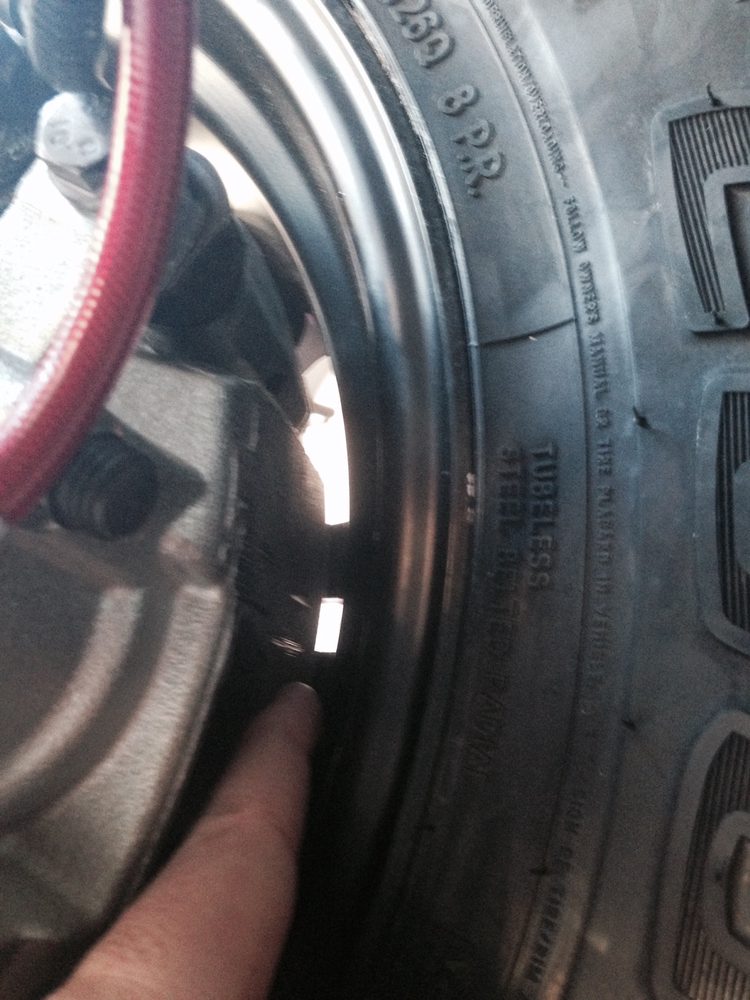

    Are 18" rims required to clear the rotors? I figured they keep it at 17" to fit stock rubicon rims...
    #831 Dec 2014, 5:12 AM
    .whose build is this?
    Lol

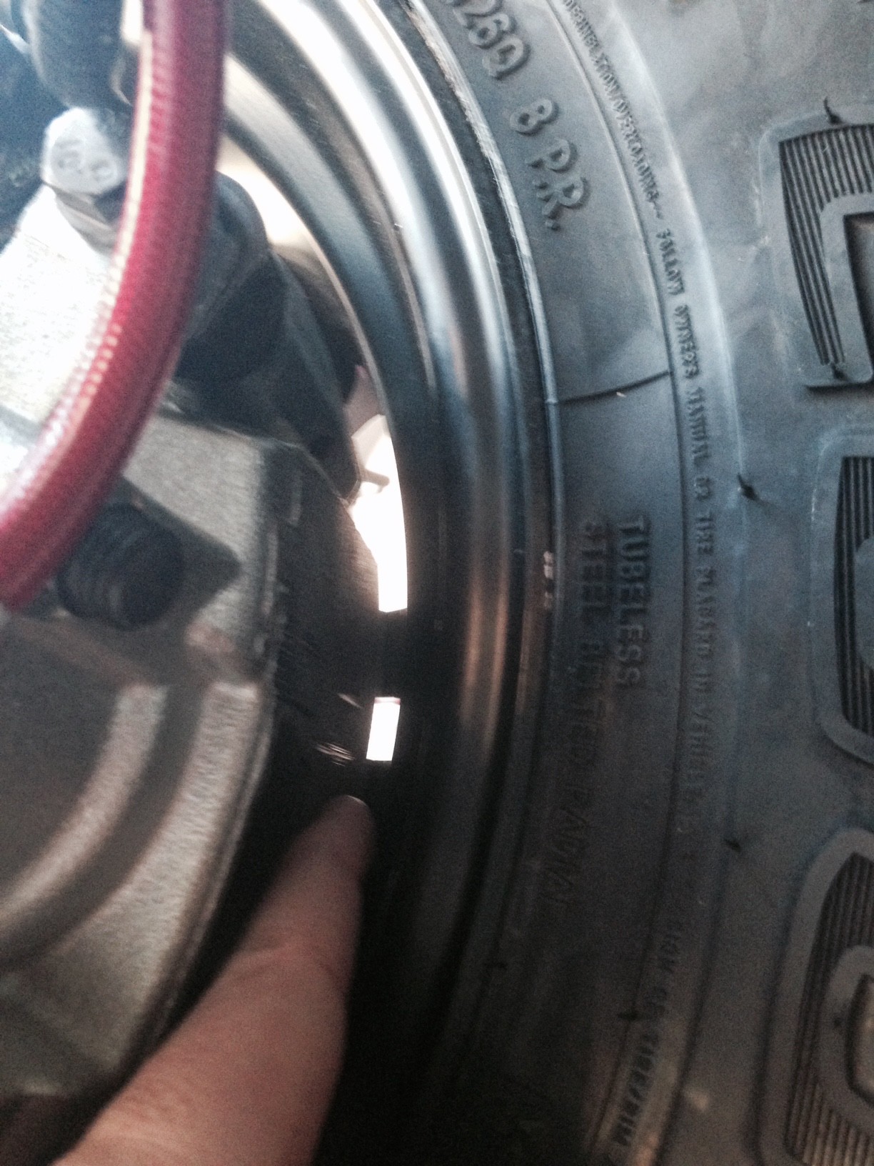

    #91 Jan 2015, 2:56 AM
    Yeah! 37x13 50 tires?
    38x13.5x18 toyo mts...whose build is this?
    It was a tight squeeze for my finger between the caliper and rim. This is with 18x9 4.5 backspacing. Kevin said he was told a 17" will fit with the correct backspacing.

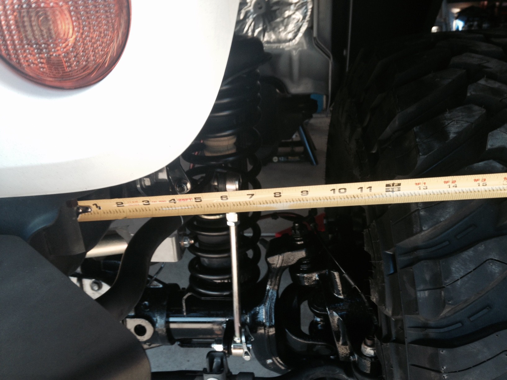

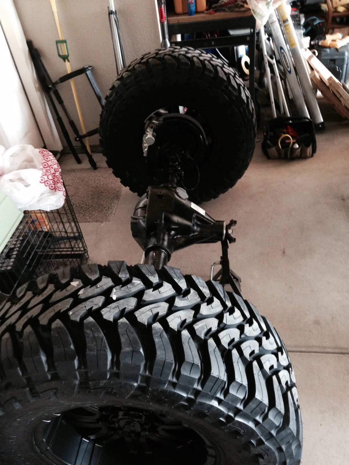

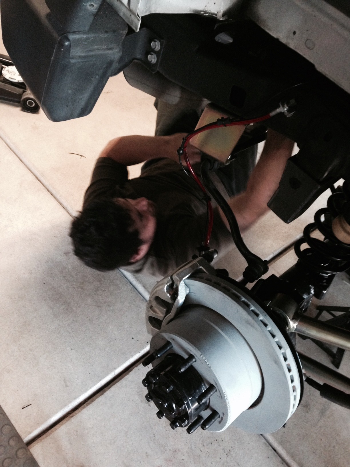

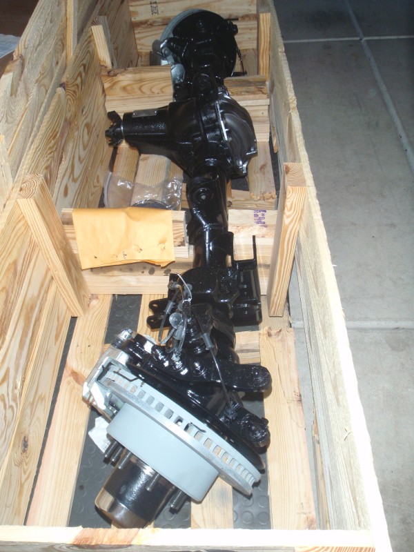

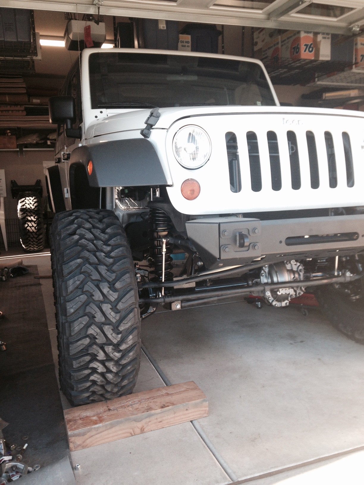

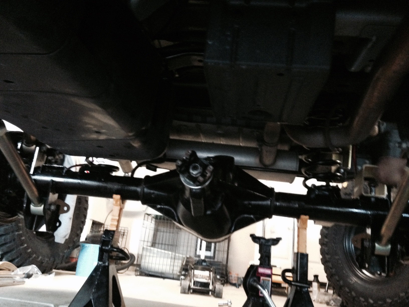

    More pictures of the build. Kevin is doing pretty much all the work and I am watching handing tools and helping move stuff. Slow and steady!
    https://posse4x4.org/wp-content/sp-resources/forum-image-uploads/finder_87/2015/01/image3-4.JPG
    https://posse4x4.org/wp-content/sp-resources/forum-image-uploads/finder_87/2015/01/image3-2.JPG
    You can see above that the axles are 69" wide with 4.5 backspacing on a 9" wheel with 13.5 wide Toyos Kevin's tire is 11.75" from the frame rail which was Metalcloak recommends.
    https://posse4x4.org/wp-content/sp-resources/forum-image-uploads/finder_87/2015/01/image5-2.JPG
    Stock steering was a bolt on replacement for the new Mopar 60. Nice touch from the factory. Dana 30 vs Mopar 60.
    https://posse4x4.org/wp-content/sp-resources/forum-image-uploads/finder_87/2015/01/image1-2.JPG

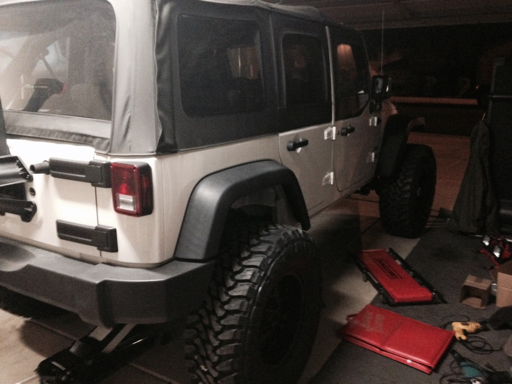

    #172 Jan 2015, 12:26 AM

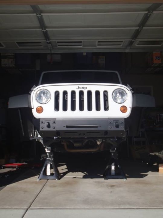

    I have more pictures of my...Kevin's build.
    Dana 60 fitting nicely.
    The man hard at work...
    Kevin's jeep staring down my poor stock rubicant.
    Lastly, the big reveal almost. I had to head out for dinner with the wife, but Kevin was wrapping up the rear lug nuts. He needs to bleed the brakes, find some driveshafts, alignment and other odds and ends and this monster should be out on the trail soon!!
