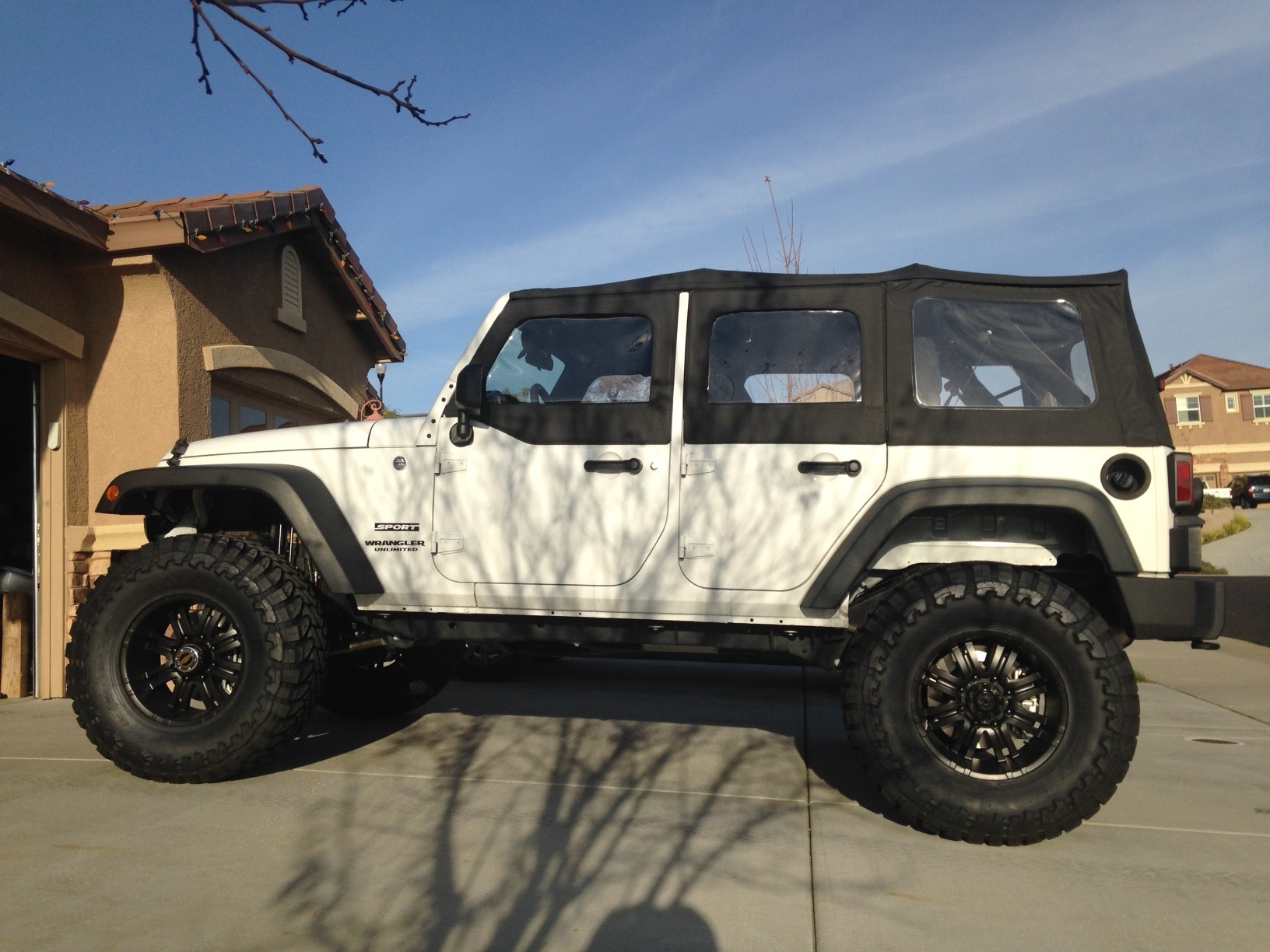

    Got everything aligned yesterday. Rides smooth!
    Still some work to do.
    #276 Jan 2015, 5:36 AM
    It looks amazing. Are you going to do tube fenders?
  3. Specialsoundman Member Joined: January 2013
    #286 Jan 2015, 5:45 AM
    Looks real good, you going to go play this weekend?
  4. Josh Subscriber
    #296 Jan 2015, 6:26 AM
    Very nice Kevin. Congrats on getting it this far. Maybe a Hell Hole trip is in your future!
    #306 Jan 2015, 8:18 AM
    I'll trim the flares for now and change them when the budget allows. :)

    Very nice! Is the front end raked, or is it your driveway?
    #337 Jan 2015, 3:33 AM
    I think I read that they intentionally make the rear springs slightly taller in anticipation of a heavier rear bumper, larger spare tire, gear, etc., which will settle it down. None of which I have yet. :)

    Anything left to work on? Or, are all your purchased items now installed?
    #3516 Jan 2015, 10:18 AM
    Need to adjust rear upper CAs, install rear track bar bracket, adjust parking brake, wire up lockers, trim flares and seams.
    The track bar bracket on the new axle is higher but not high enough.
    VKS Fab rock sliders are on order!

    Adjusted rear CAs this weekend. It drove great before and now it's driving even better! :)
    Up next, rear track bar bracket. Currently, the rear track bar is close to hitting the diff cover on big bumps. Need to figure out how to get the bracket to fit the new axle to get it up and out of the way.
