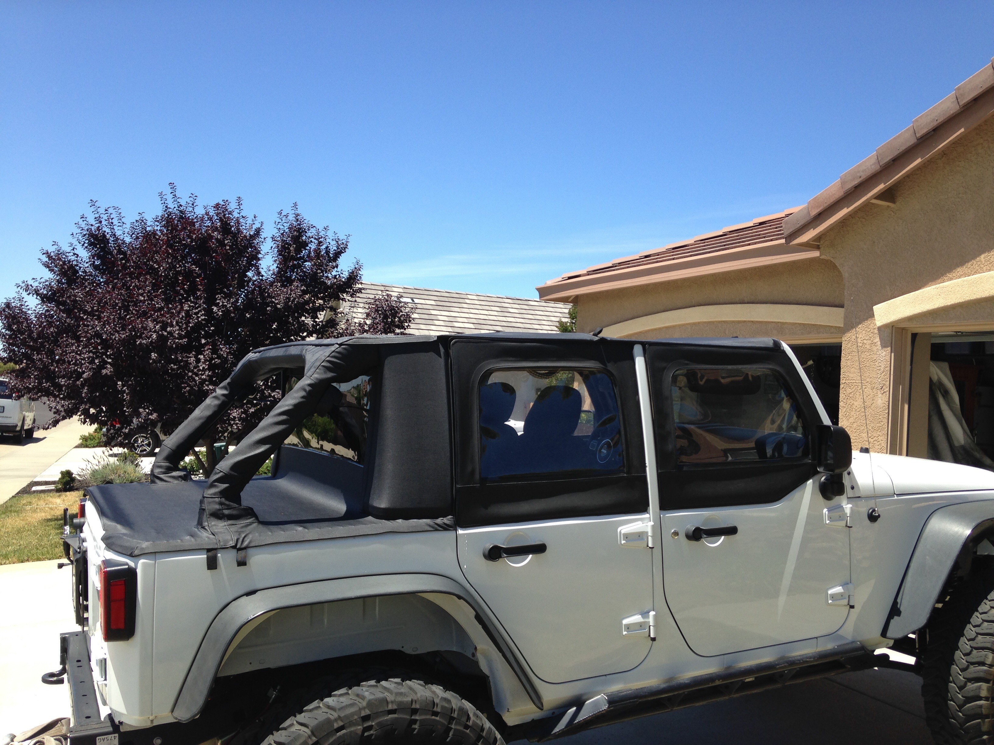

    #17018 Jun 2016, 5:18 AM
    New top is finally on! Man, was that rear cover tight! I had to use a wood clamp to get the plastic into the channel. Hopefully the hot sun will soften it up a little.
    Now time for a test drive.

    #17118 Jun 2016, 6:52 AM
    Cool Beans!
