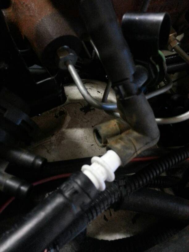

    #12715 Apr 2013, 10:36 PM
    Nice, you found those evap hoses for me. 😀 oops

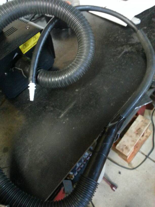

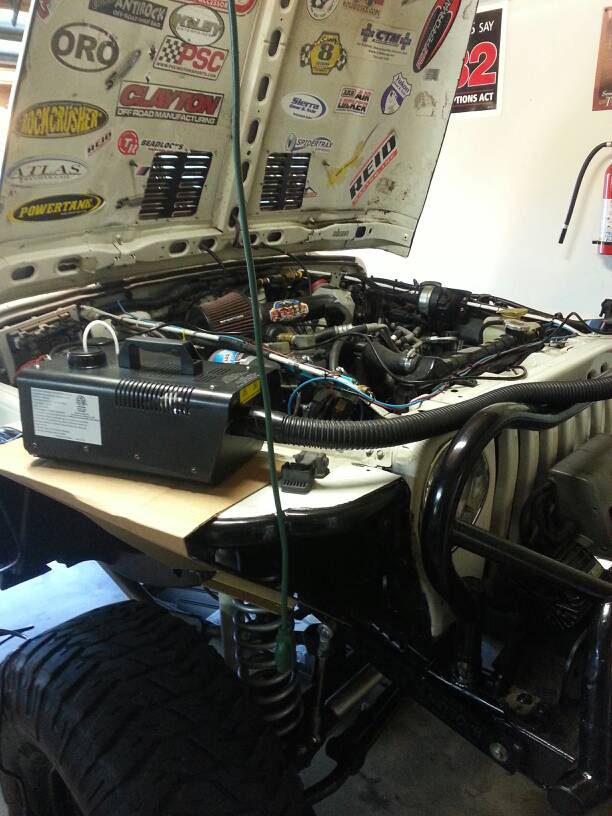

    I utilized today to finish up the last few things. Fixed a broken body mount, Re plumbed the rear arb hose, installed the front bumper and wired the winch. The Front bumper required welding on the lower mount tabs. I had to cut these off to remove the bumper. With the welding I had to disconnect the battery and thus resetting the computer. With the evaporation leak I decided to do a smoke check to find the leak. I called around and local shops wanted to charge a hundred bucks. I said, no way. What I did was but a smoke machine fro party city and duct taped a hose and reduced the size down to push smoke into the vacuum system. No leaks showed up. I'm hoping my problem is simply a gas cap.

    #12917 Apr 2013, 10:24 PM
    Pics of smoke test
    #13017 Apr 2013, 10:28 PM
    Inserted into vac line. Melted the hose I had taped to the smoke machine. That sucker gets hot!

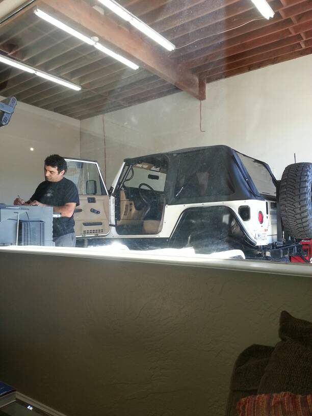

    However half wa y through the test the smog guy couldnt get his obd2 computer to recognize the jeep. I have a blue tooth reader that was working as I pulled into the smog shop. You gotta be kidding me! The smog guy tried everything including rebooting his computer. No luck. I pulled the jeep out into the paking lot and messed with it.eventually I got my bluetooth reader to work again by cycling the ignition on and off. I realizd d what had happened was the bluetooth reader was pulled out of the obd port with being shut down. This screwed up the computer and needed to be cycled to be reset. This time the smog shop reader worked and the Jeep finally passed. Thank God....

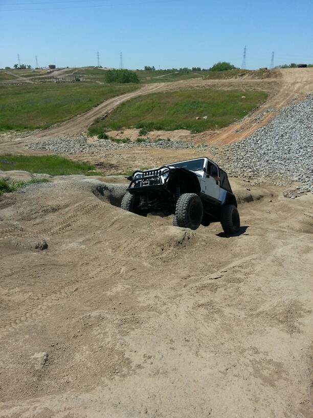

    Its gone the buyer came and picked her up. Of course we had to go do a shake down run at prairie city. At first I was a little nervous but it performed better than expected.

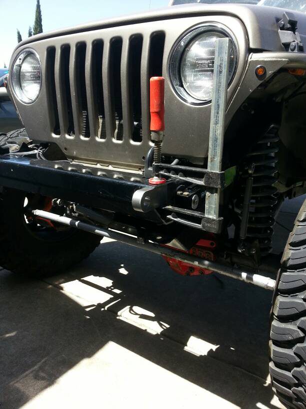

    I purchased an older esab migmaster 250 from my step dad. I got it for a steal mainly because the feed mechanism didn't work. I asked my friend Google and he said the problem might be the micro switch in the gun. So, I decided to bite the bullet and get a new switch. Low and behold Google was right. The switch fixed the problem.
    Since the welder was working I thought it was time to re configure my bumper.
    The plan is to put clevis tabs in, make it a shorty, and intigrate the winch mount.
    #14929 Apr 2013, 6:53 PM

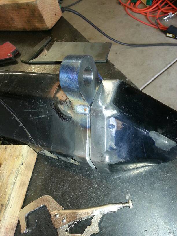

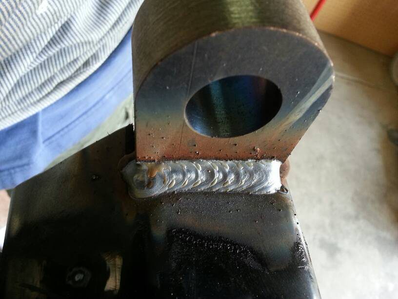

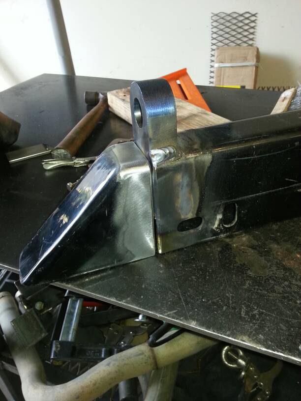

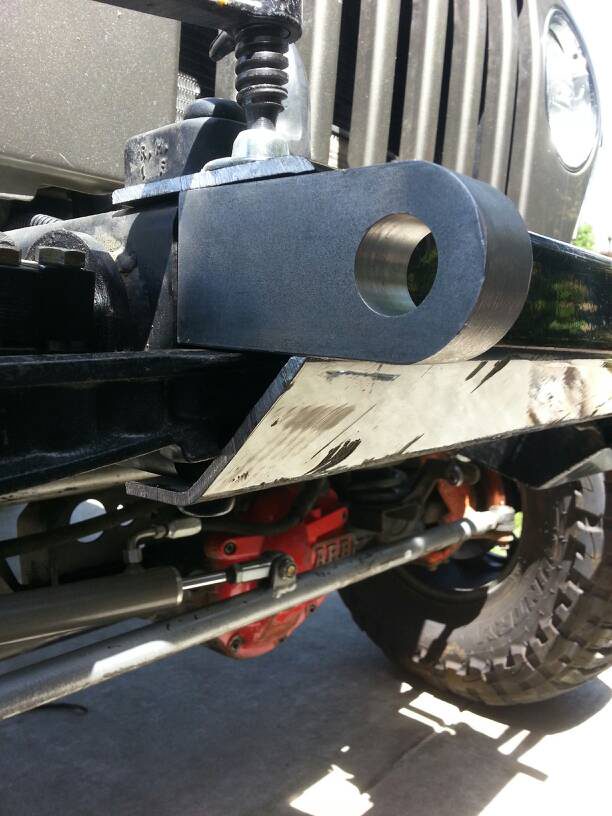

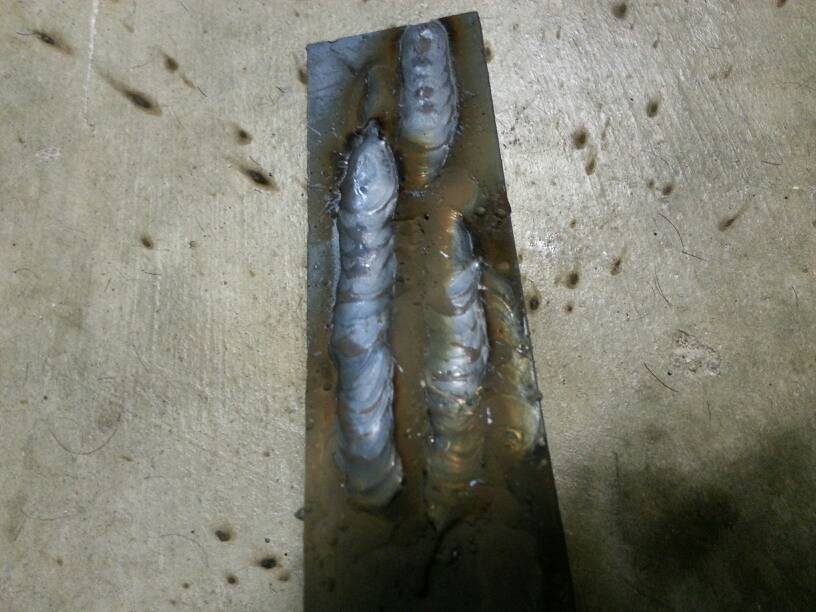

    This afternoon I busted out the portaband and cut her up. I sectioned five inches out of both sides. And cut the holes for the clevis tabs. These tabs are stout! They are from ruffstuff and are bad to the bone. This weld looks a little beter than the first try last night. Hope finish tomorrow.
  25. Guest former user
    #15029 Apr 2013, 7:18 PM
    Next I have to weld it back together and gusset it.
