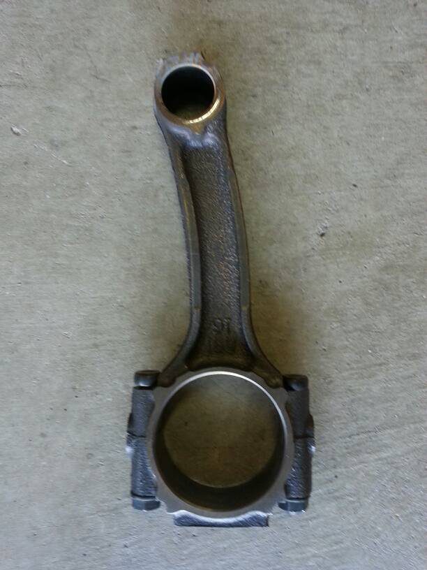

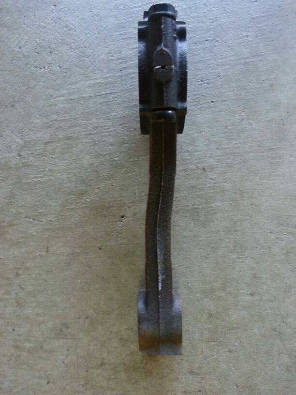

    Picked up the motor today from the machine shop. The long block is back togeather with a new rod and piston in cylinder six. The block was torn down checked, cleaned, honed, and reassembled with new bearings.
    Turns out the rod was bent and the piston was cracked.

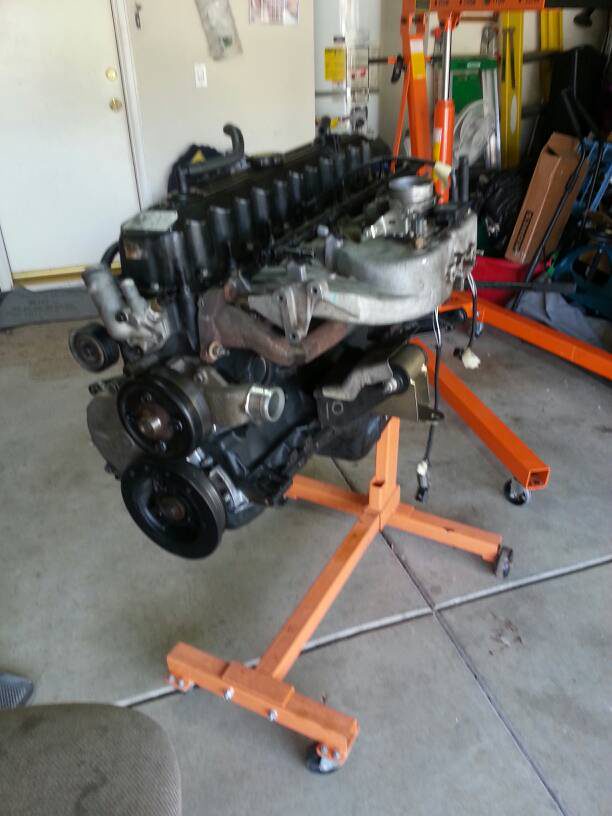

    Got it home and back on Jeff's engine stand. Ready for reassembly.
    I am going to put it back in on friday. I'm thinking work part friday evening. Great way to kick off the weekend!

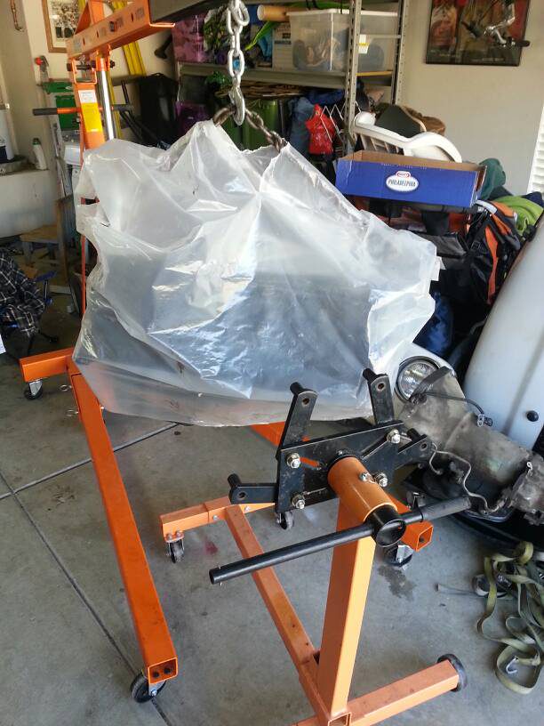

    With my Dad's help started putting the motor back together. Its a lot easier to get the intake and exhaust on when the engine is on the stand. A LOT EASIER.....
    #10510 Apr 2013, 8:24 PM
    Looks good.

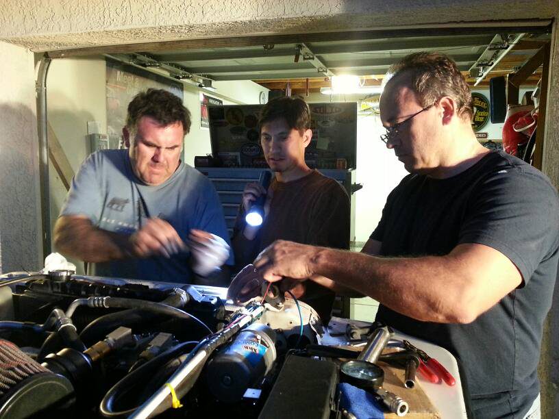

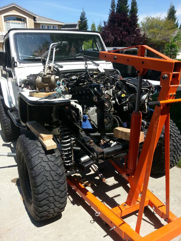

    Any one up for a work party tomorrow day/ night? My dad was in town and we were able to get the motor trans and tcase in the jeep. All we have to do tomorrow is plug in all the wires, hoses, and put the whole front end back together. I would love to fire the motor tomorrow night. Any one know any thing about re-installing the cam position sensor? I'm not sure i put it in right. I guess we will see when i try to start the jeep. :hack:

    You have a Haynes/Chilton manual right? lol
    See you in the morning.
    #11011 Apr 2013, 11:08 PM
    Oh ya chilton baby! Tomorrow it is!

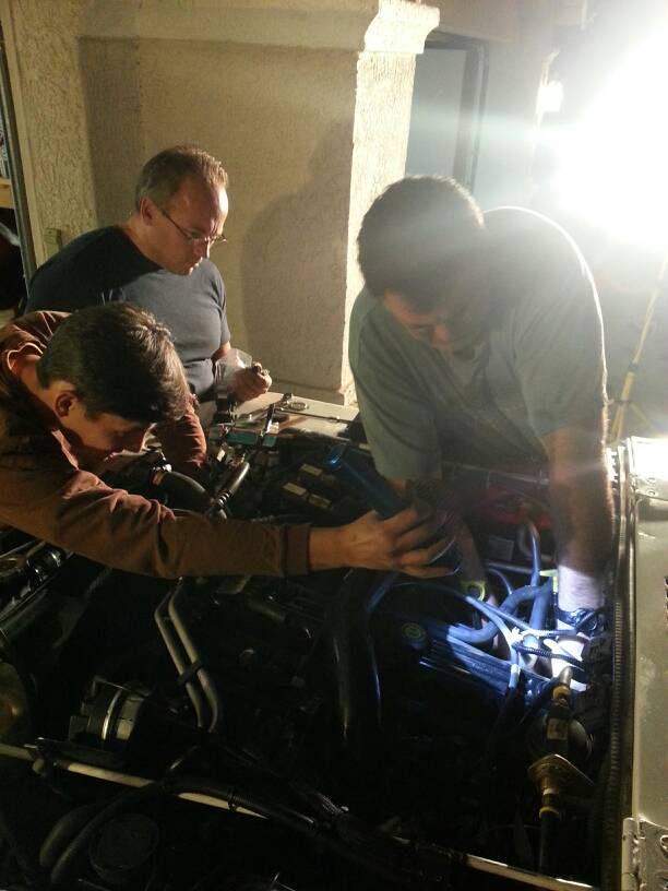

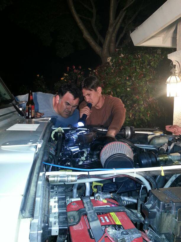

    She's ALIVE! Thanks to Josh and Carl the beast is reborn. After hunting down all the connections the motor started on the first try. Why is it there is always a plug that has no mate and takes forever to find its place. Any way all that us left is to put on the hood install the bumper and winch. Then have a zip tie fiesta. I'm hoping to take it back to the smog shop monday or tuesday.
    I also drove it tonight and she purrs like a kitten. The buyer will have a good ride.

    Dooooood, that last downstream O2 sensor routing is, for lack of a better word, LAME!!
