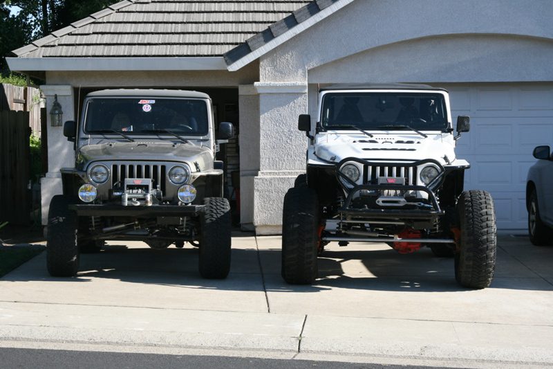

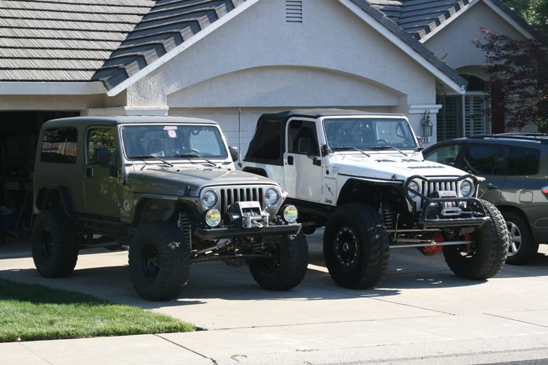

    A deal of the century became available when Rob decided to sell his Jeep! The rusty cogs in my head started turning and I realized that I could buy this well built jeep swap the drive train over. I will then resell his Jeep with my old drive train under it. I’m hoping to sell for close to what I bought it for. Good deal….. I think so…. A week ago Dana 60’s, an Atlas, PSC steering, and many more extras were not even a figment of my imagination. But now it’s reality.
    The work begins after the Rubicon Round up. I’m thinking that I’m going to start with the axles first and the suspension. That way I can have a roller. Then swap the Atlas and drive shafts. Then see if the gas tank switch can work.
    I think the TJ will be a good reseller because it will be a highlined stretched tj on stock springs running 35 inch tires. It will have a dana 30 up front with a Dana 44 out back. Both have chromoly shafts, arb’s and 4.88’s. I’m also swapping in my np231 with the 4:1. I think this will be one stable wheeler. We shall see.
    The swap is pretty straight forward. I think the front axle will almost be a straight bolt in. The steering system should transfer across. My biggest concerns are the rear axle, the drive shafts, and the atlas.

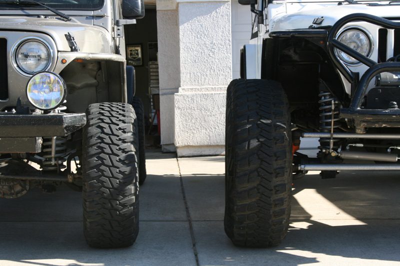

    I need advice on which tires to get. I want the MTR, but should I get the 37/ 12.5 or the 38/ 14.5? Remember that I am going to drive this on the street. I have a hectic 1.5 mile commute. Not too much street driving but enough to be a concern. The 37 inch tires will require a two month wait and the 38 will be about 10 days. Thanks in advance
    #913 Jun 2012, 5:15 AM
    The 38s are awesome but you'd have to do some rear fender trimming to get them to stuff. So, the 37s are as big as I'd go unless you aren't opposed to :hack:
    #1013 Jun 2012, 6:09 AM
    With 60s, I'd go 38s. But that's just me. When you're aired down, the tires will fit in the fenders. 😉
    #1113 Jun 2012, 9:04 AM
    With my genrite corners I have some room to trim. I should be able to make them fit. How about the streetability?
    #1213 Jun 2012, 9:38 AM
    "lj4x4" wrote: With my genrite corners I have some room to trim. I should be able to make them fit. How about the streetability?
    I run those 38's on my JKU on the street with no problems. They're great. John and I are the only club members running the 38" MTR from my memory. I'll have mine at the meeting this week if you want to check them out. They are big tires, but great off road. Greg runs the 37's I believe. I think Scott and Rob are running the 40's.

    "38" Goodyear MT/R Kevlars on Raceline Beadlocks" = 38x14.50x17
    Good catch!
    #1613 Jun 2012, 2:51 PM
    Wheel width?
    You're width is not 14.5" right? I know the tire is.
    I'm guessing you're 17x9.
    #1713 Jun 2012, 3:50 PM
    Rob says my rims are 17x 9.5 and that the 38s would work great.
    #1813 Jun 2012, 7:40 PM
    Wheel width = 9.5".
