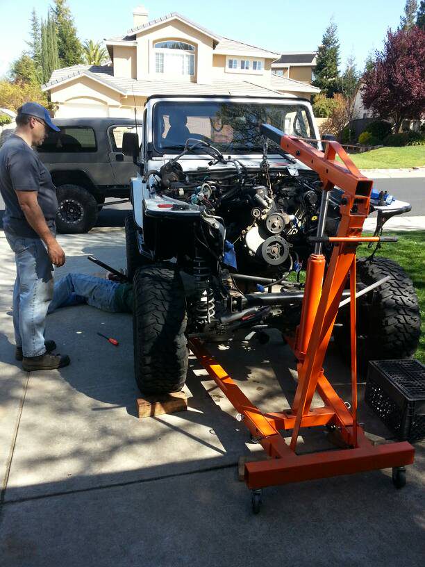

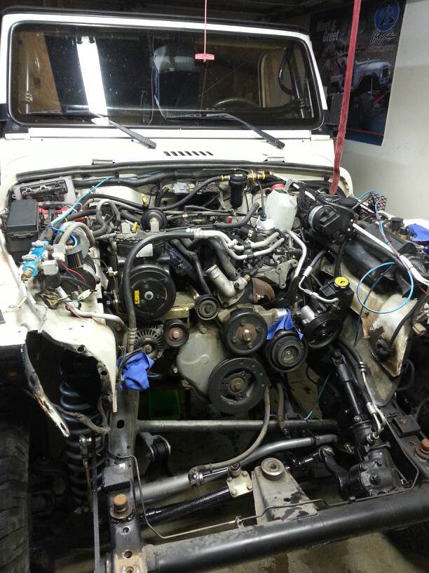

    Tonight Carl came over and we tore into the jeep. We started at six thirty and worked till eleven. Joe sugested we remove the grill and radiator to have good clearance to remove the engine. So thats what we did. The front guard was a major pain. We had to cut off the bottom bumper tabs and use heat a chisle and a bfh to persuade it off. Next came the grill and radiator. We also pulled the drive shafts and the transfercase. A lot was acomplished, thanks to Carl. However there is still a lot more to go. We will resume tomorrow morning. If any one is board you are welcome to swing by.

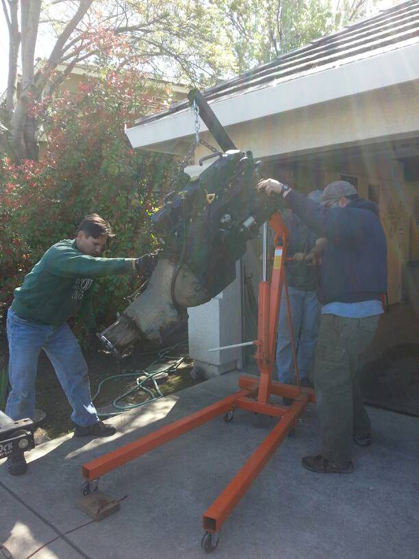

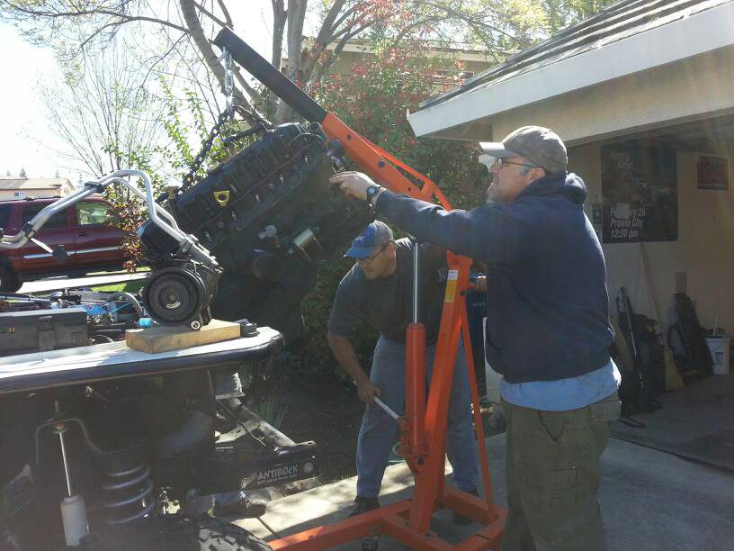

    This morning Carl and Josh were here bright and early. We continued removing the intake and exhaust manifold, the ac compressor. In between eating doughnuts and drinking coffee we plug by plug and bolt by bolt removed all the connections. The big question was weather to remove the the engine with the tranny or not. We ended leaving it in. This worked good. Of cojrse I should have drained the tranny fluid first. But with the expertise of Josh and Carl we were able to manuver it out. We started at 7:30 this morning and had the motor on the stand at one and stripped down by three.

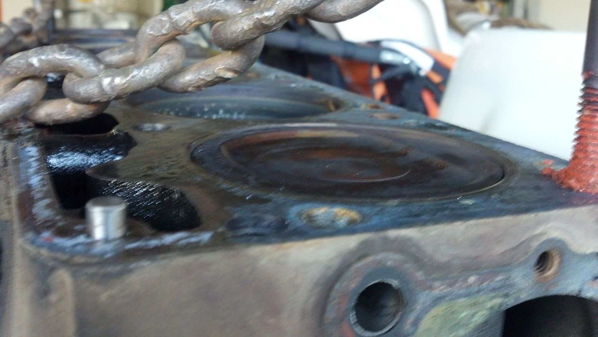

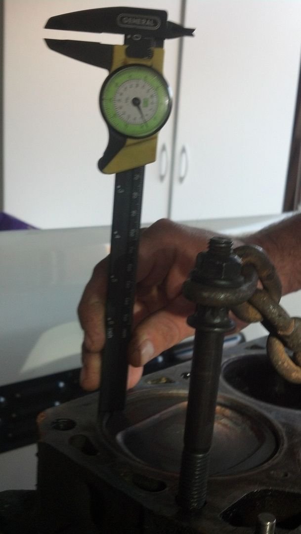

    We found the culprit. It was indeed the coil pack. 😛
    I meant that cylinder #6 took the brunt of a hydrolock experience(s). It was off roughly 0.02" give or take a couple thousandths. Cyl #1 was about .002" off.
    Cyl 6
    Cyl 1
    #9823 Mar 2013, 7:23 PM
    Yep bent rod. Nothing bud cant fix.
