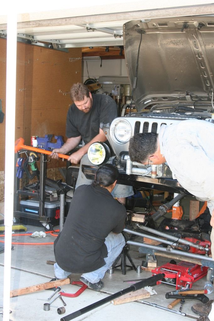

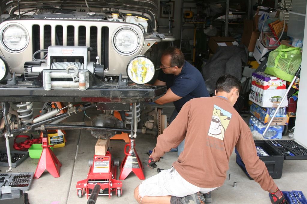

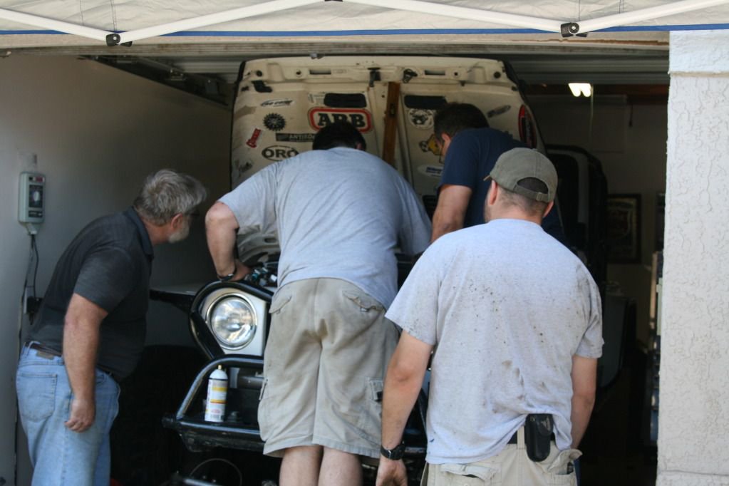

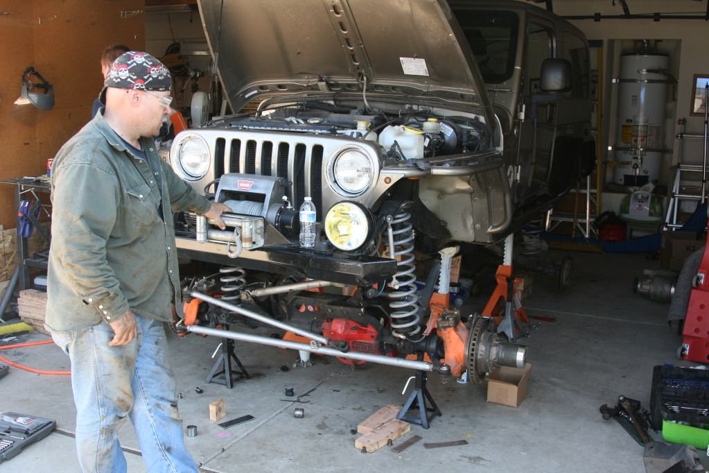

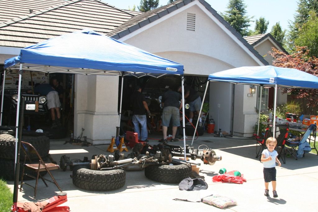

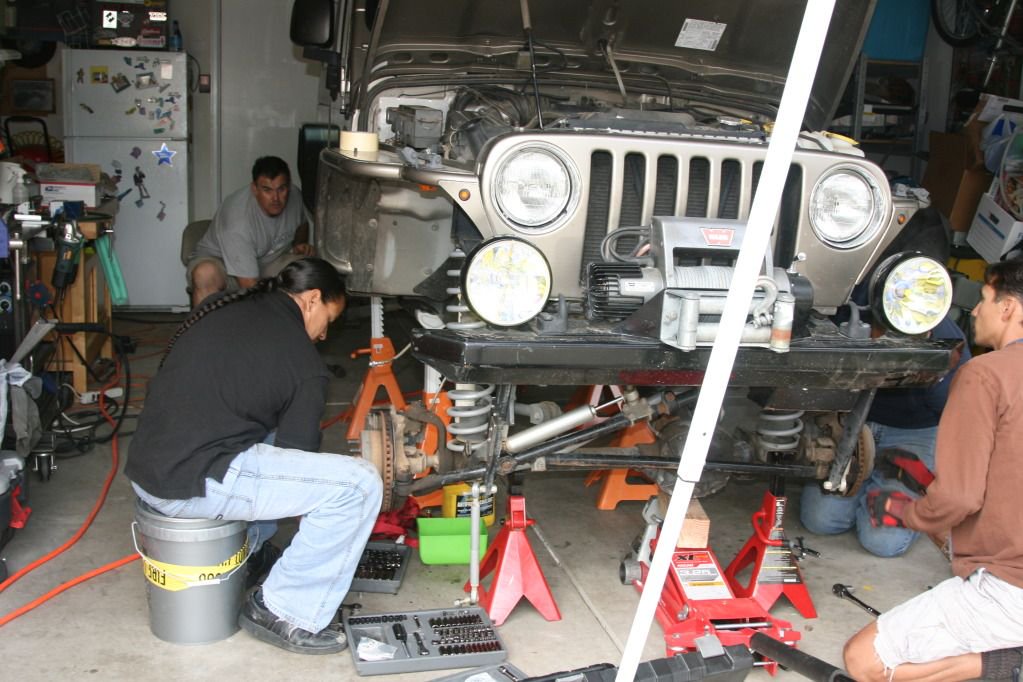

    I have been very busy with work and the project. Currently I have the front axle about 98% done and the rear 75%. The Atlas is in thanks to Jeff and PJohn. Carl Dropped the rear drive shaft off at ADCO drive lines. Hopefully it will be done on Monday.
    I want to again thank everyone who came over to help with the work party. I am still amazed the amount of work that was accomplished.
    #3113 Jul 2012, 9:49 PM
    A couple more pics

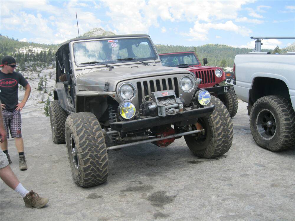

    Yes I jumped ahead but I wanted to get something out. The lj is mostly done. 2 Rubicon trips and I'm getting the rig dialed in. I have more tech to post... in due time. Thanks for the patience.

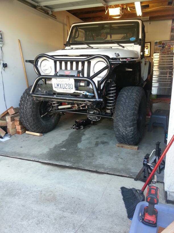

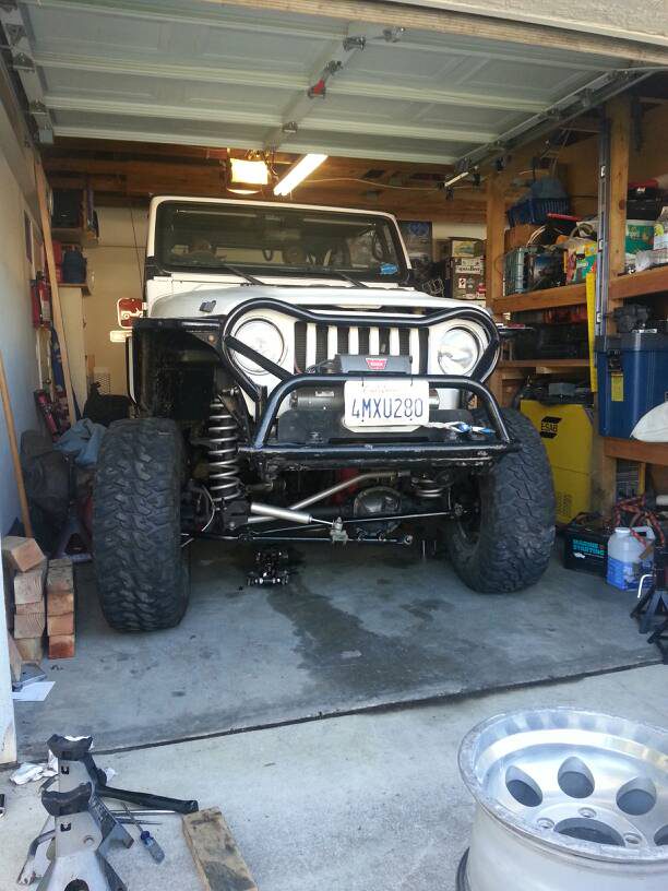

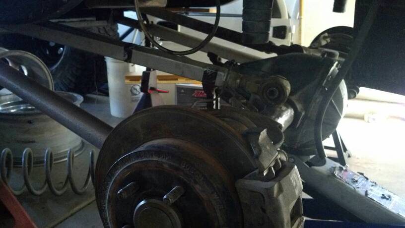

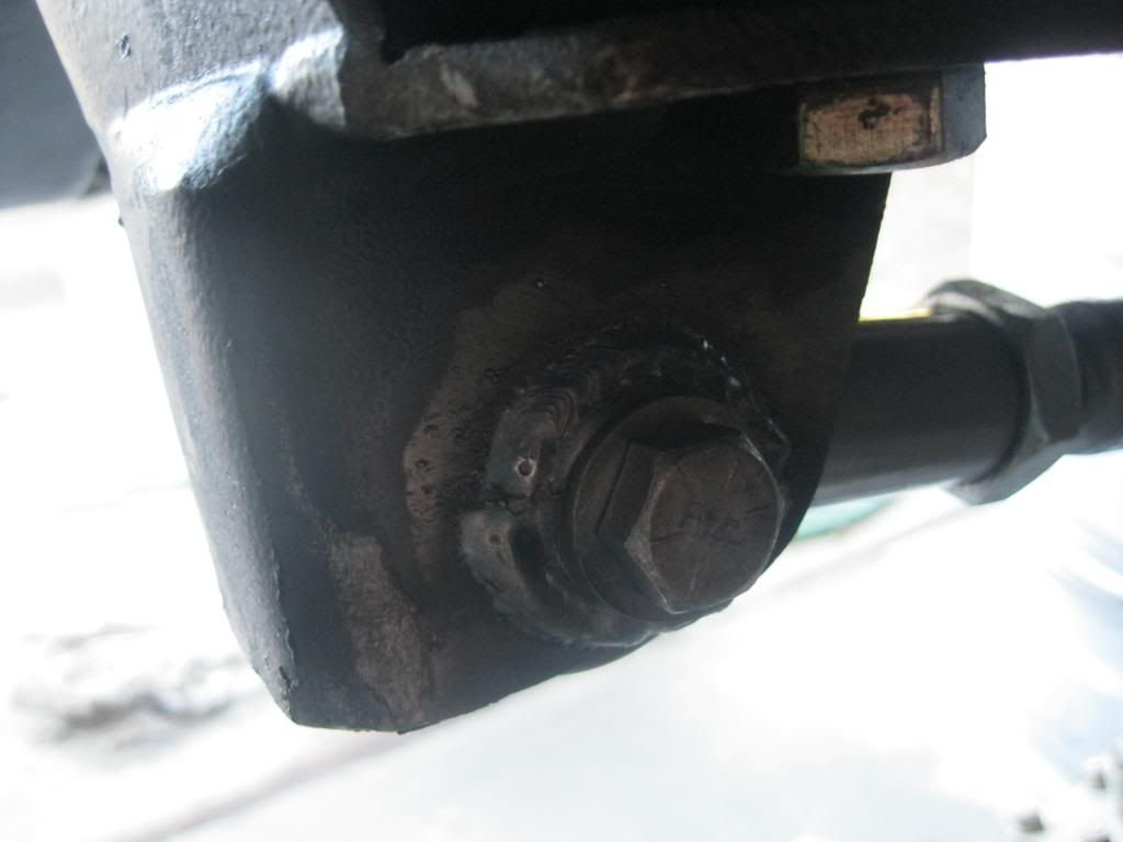

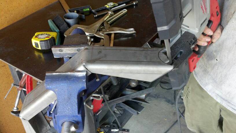

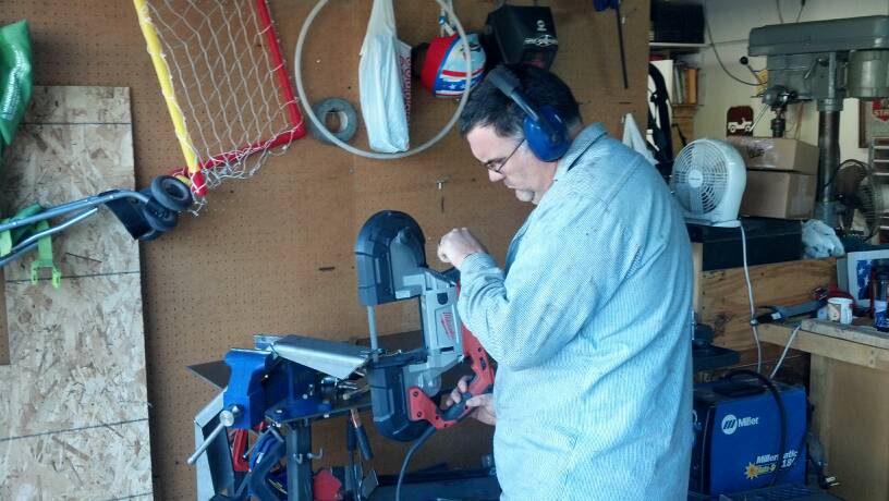

    Yes thats a big bad Dana 30 ! To get it to fit I had to stretch the control arms and shrink the track bar bolt hole. Way to much fun...

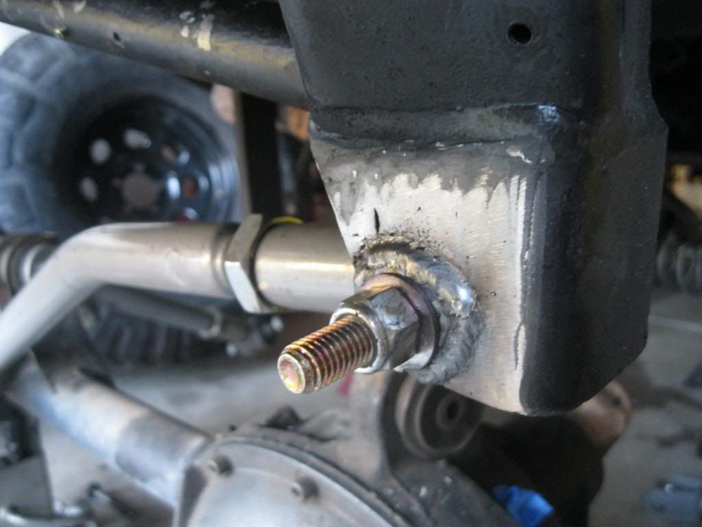

    #3513 Nov 2012, 9:48 PM

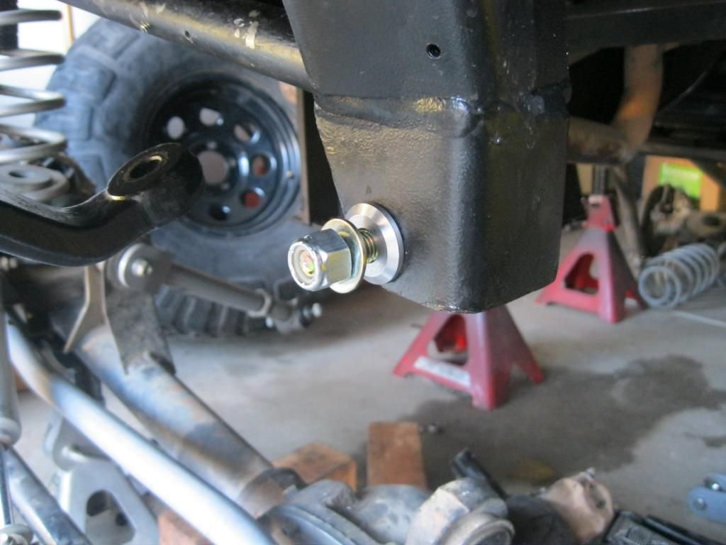

    Have you ever wondered ho to shrink a hole? Well with the help of Ruffstuff I have figured out a solution. The track bat on the TJ was drilled out to 5/8" and the biggest bolt I could use was a 1/2". After searching the fix it washers from Ruffstuff make far superior connection.

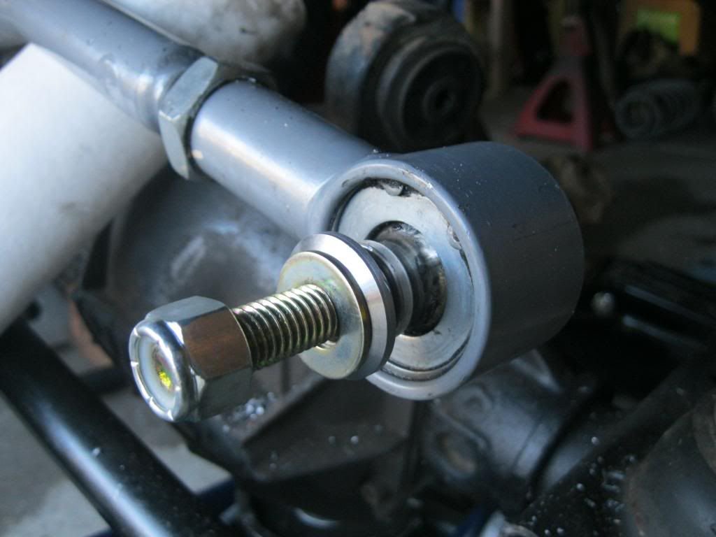

    #3613 Nov 2012, 9:54 PM

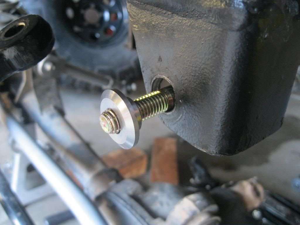

    I reused the RE track bar and the bolt was way to small for my liking. A call to RE and I found out that there is a 1/2 inch bolt hole replacement joint center for the small RE joints. Nt cheap but better than a whole new joint.
    All you need to do is drill out the hole to 1/4 inch over the bolt size and weld these puppies in. Easy peasy.....

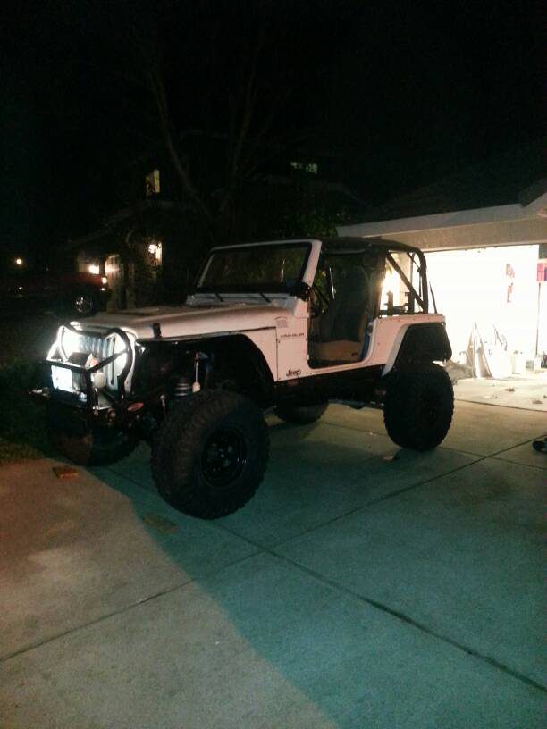

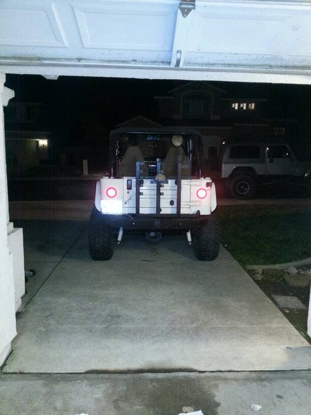

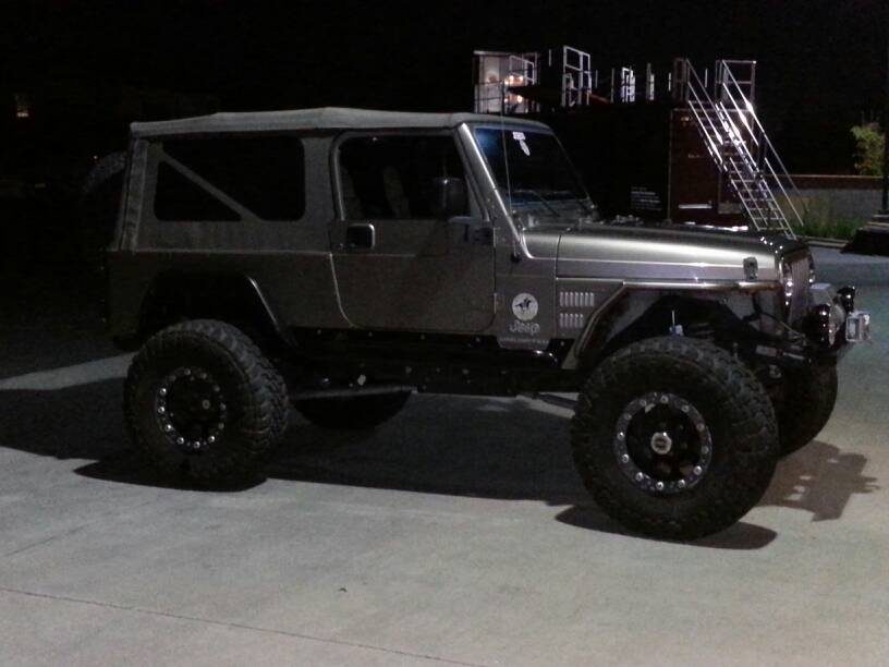

    #4031 Jan 2013, 10:14 AM
    She's alive!
    #4131 Jan 2013, 10:24 AM
    Awesome!!

    Thanks! Still have to get it dialed in. It drives great! Lots of fun and really fast. The auto, the 4:88s, and the 35's make it zippy.
