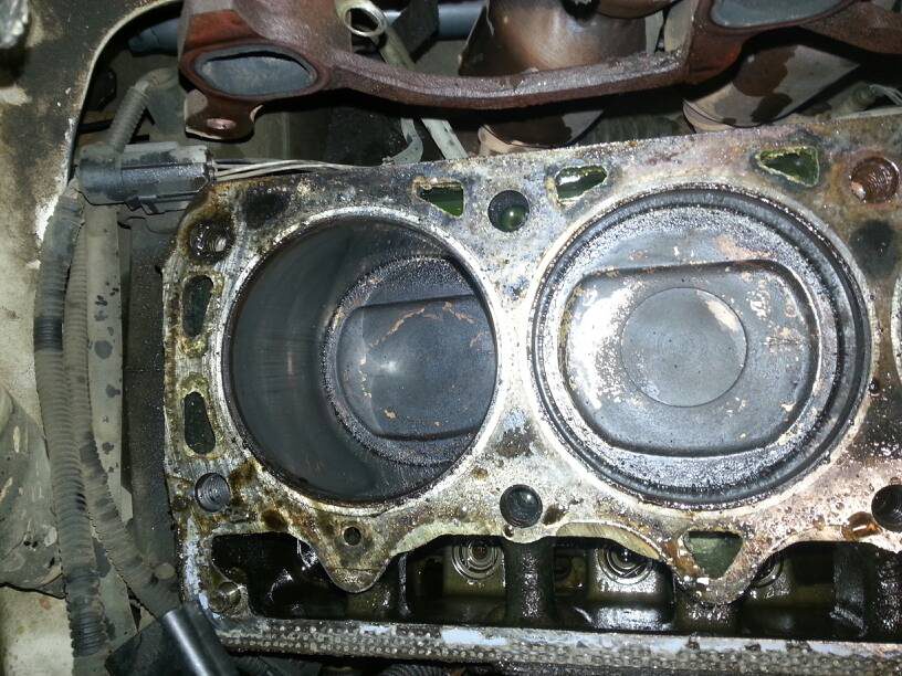

    #5311 Mar 2013, 6:20 PM
    I hope the piston rings are still good. We will see.

    #6113 Mar 2013, 5:58 PM

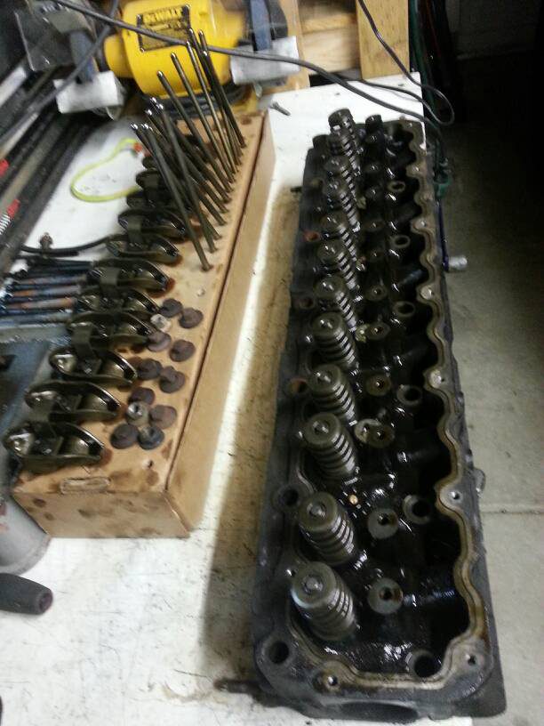

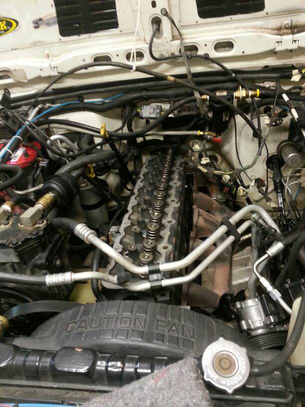

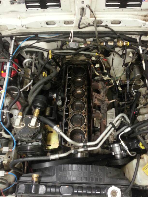

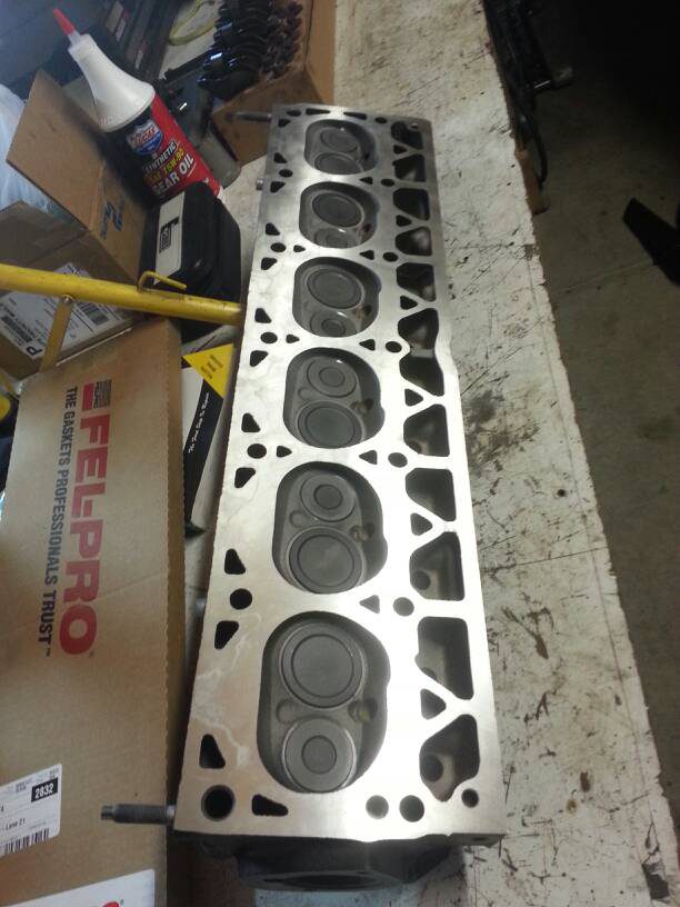

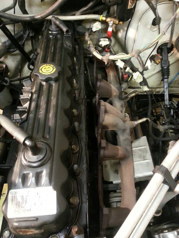

    Got the head back from Bud Walmer's machine shop. He said it was bad and the valve seat was offset by almost a quarter of an inch in cylinder six. He did a vacuumtest prior to machinig and they all had significant leaks. Now she is purdy and should run like a top. Of course after I put everything back togeather. I'm dreading installing the intake and exhaust manifold. It was a pita to get off and I have no idea how I'm going to start the bottom bolts. We will see.

    #6417 Mar 2013, 5:55 PM

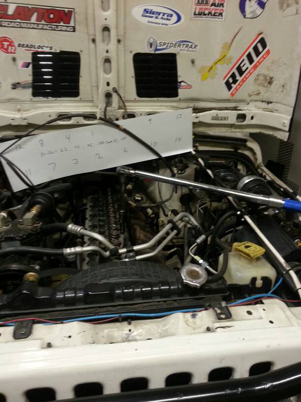

    I got it back togeather and running. Its noticeably smoother and quieter. The reassembly took 7 hours. The hardest part was the intake and exhaust manifold. I learned a lot and hope to never have to do this again.

    #7118 Mar 2013, 9:10 PM

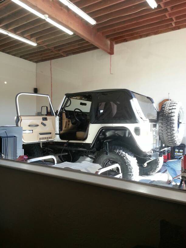

    I'm screwed! The motor needs a total rebuild. I drove the Jeep to Yuba City today for a class. As I arrived the check engine came on....again.... The code was cylinder six misfire 😈 . I have tried everything and the only thing left is a rebuild. Yes I could pull the piston drill hone the cylinder and put new rings on. This would only fix one cylinder and the rest of them are still beat to sh@#. It would be unethical and sleazy to knowingly sell a vehicle with a blown motor to anyone. So even though I can't afford it, I will be pulling the motor next week. I'm not sure how to get it to and from the machine shop, so I might ask for some assistance. Please excuse my 😤 but i'm not happy.
