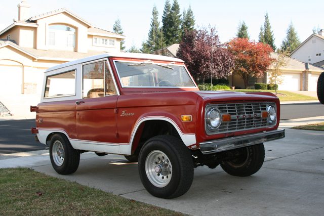

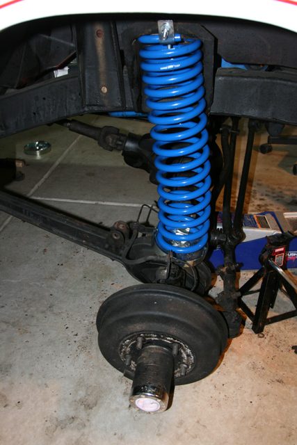

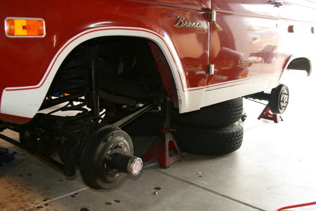

    A couple of pics....
    #1617 Nov 2011, 10:12 PM
    #1717 Nov 2011, 10:16 PM
    When he drove up....
  18. Howdy Subscriber
    #1817 Nov 2011, 11:44 PM
    I can see why he keeps it to the pavement. You don't find too many around anymore that are uncut. Thats got to be fun to drive it around with drums on all 4 corners. 😀 😲

    First off, I want to thank Carl for two days of huge help! We mostly finished last night. We were able to get it back on it's wheels at about six last night. This thing fought us almost every step of the way. Lots of fun! More to follow including pics.
    #2319 Nov 2011, 6:52 PM
    We put a James Duff 3.5 inch lift springs with a Wild Horse drop track bar brackets on the front. In the rear we put Deaver 3.5 inch leaf springs. The actual lift height is 2.5 inches in the front and 3 inches in the rear. We ended up with the right side sitting an inch higher than the left side. This might be binding in the suspension but until we get it drivable we won't know for sure . All that is left is to reconnect the drive shaft, bleed the brakes, center the steering, alignment, and adjust the E-brake.
    Here are some pics with captions.
