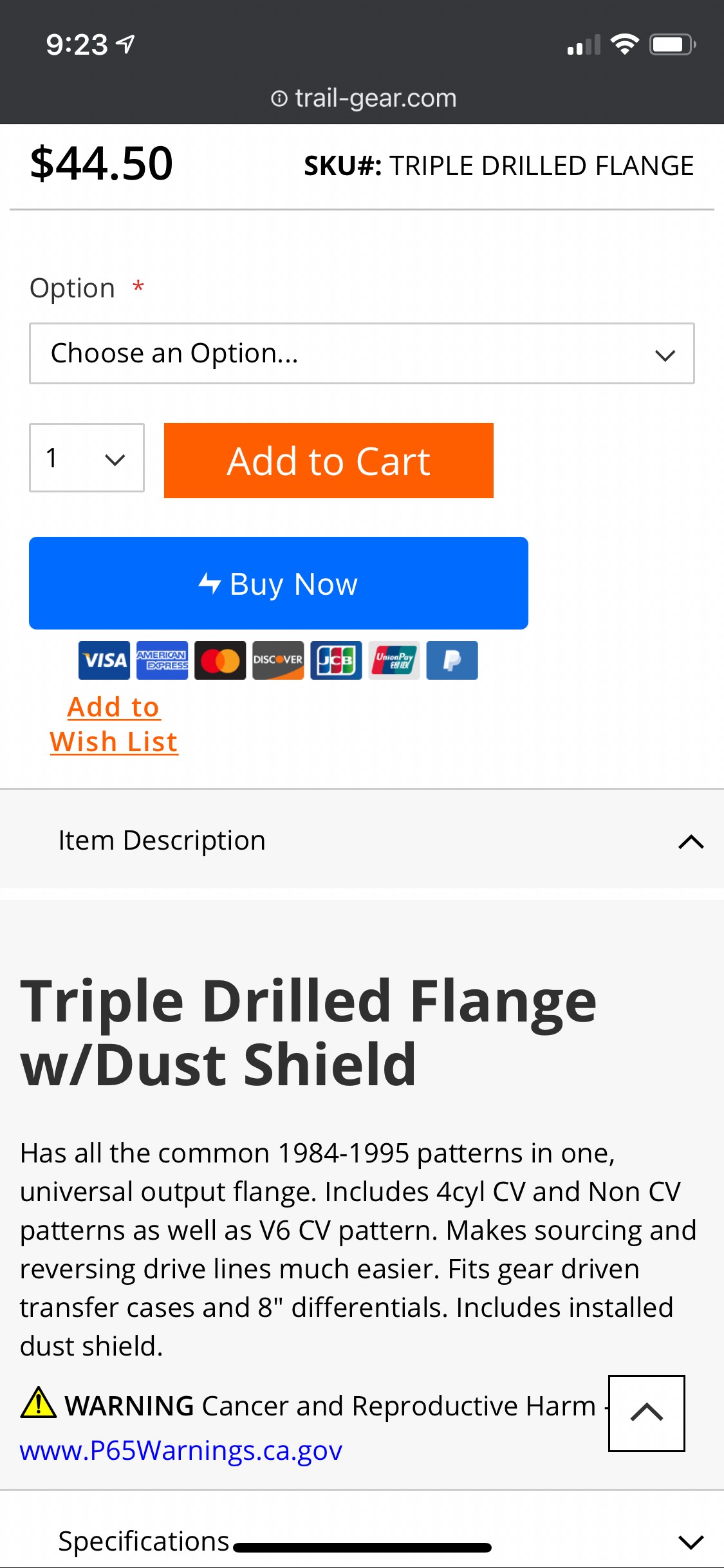

    #1220 Mar 2021, 2:25 AM

    #1320 Mar 2021, 12:40 PM
    no, my transfer case is chain driven and 23 spline. I have looked all over the web can't find anything. Need to go junk yard hunting for this one. Toyota said that it is discontinued and none of them exist in their inventory. I ordered one similar that said it was 23 spline but it did not work. With dry weather approaching I hope to find it this next weekend.
