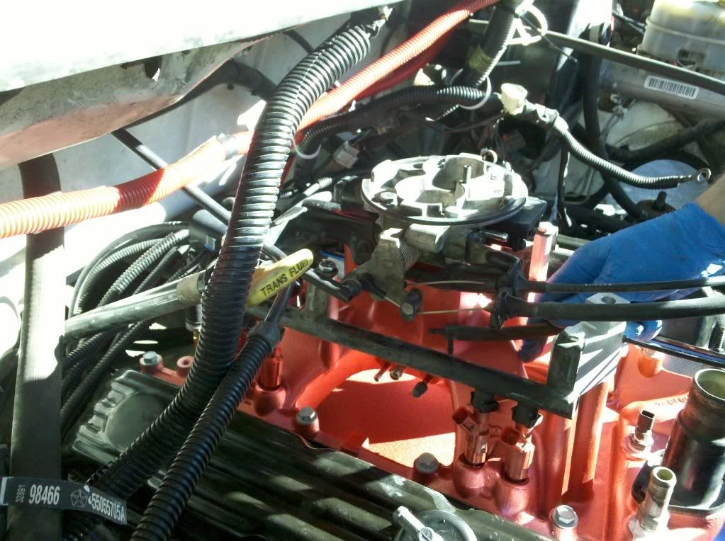

    #816 Jan 2012, 2:20 PM

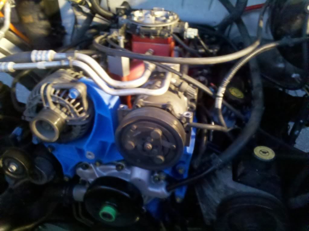

    So the install has been completed: 90% Remaining 10% is assorted stuff.
    What did I do?
    1. camshaft change
    2. double roller timing chain
    3. water pump
    4. new intake manifold
    5. tune up
    This is the first time ever I've done engine work. It was darn fun, especially vs. the doubters. πŸ˜€ Big learning experience and no regrets. So here is a video of yesterday's big moment. Cameo by the new VP.
    http://www.youtube.com/watch?v=gilYN6ePuNk
    Some pictures
    Everything bolted on minus serp/fan/shroud

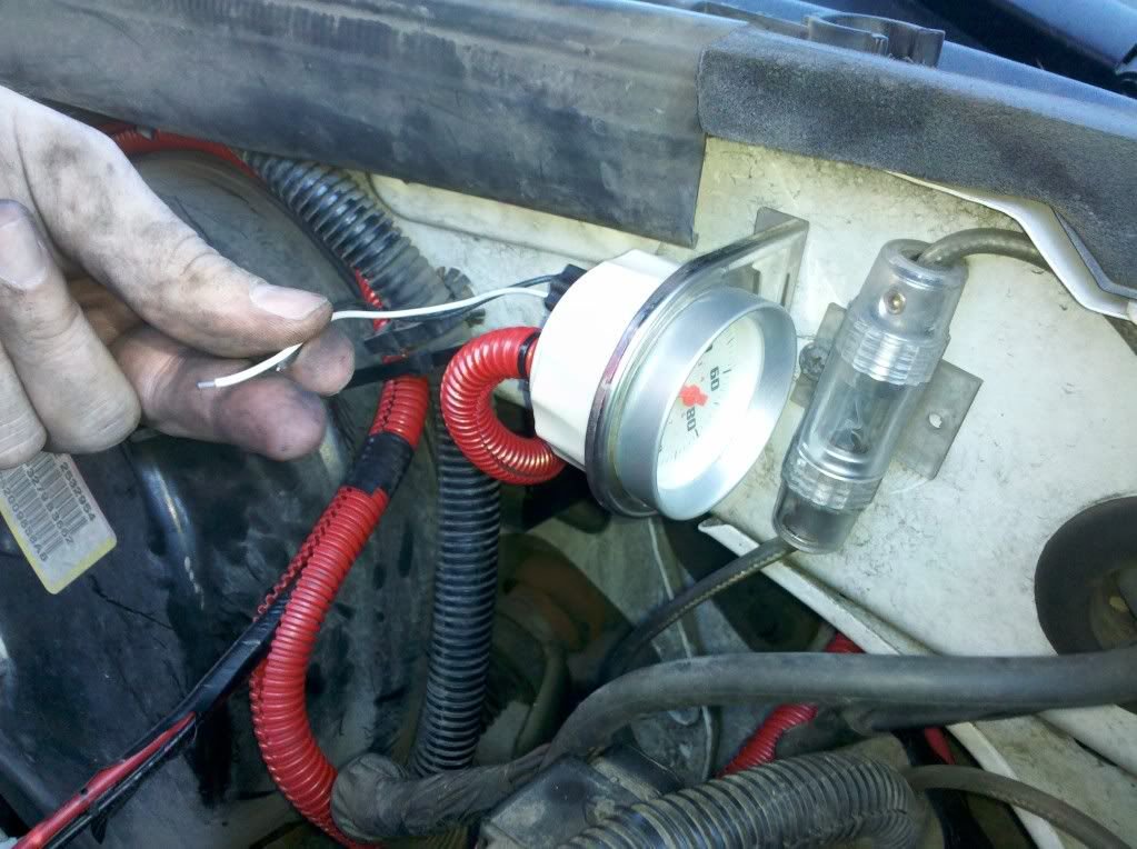

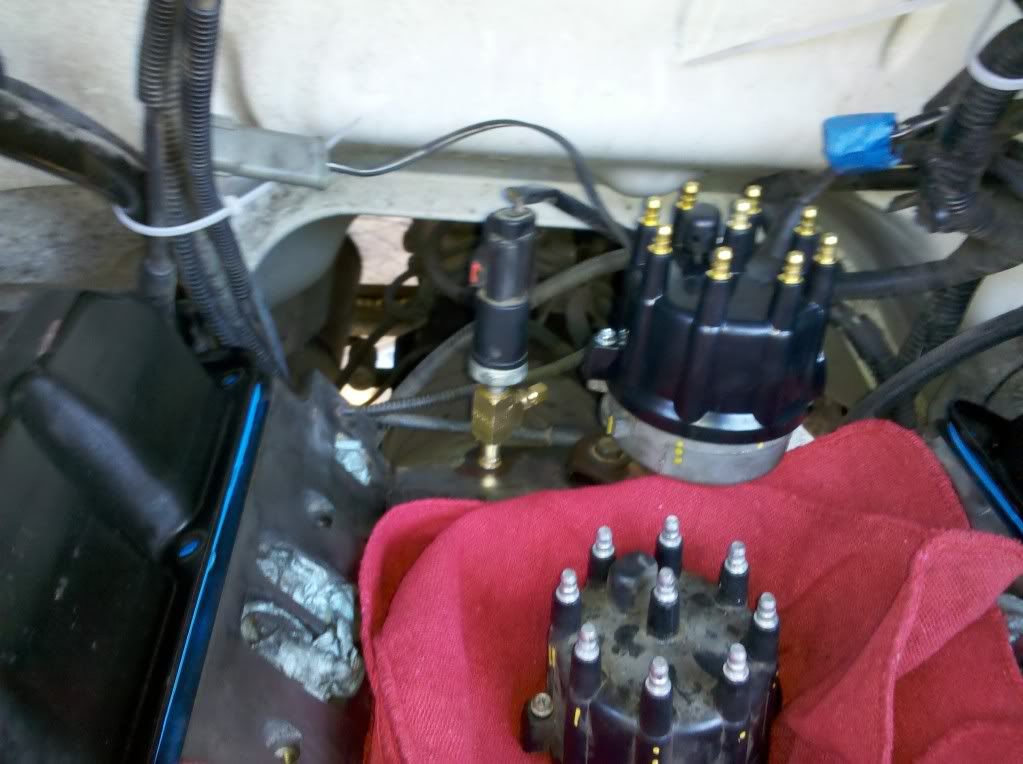

    Oil tree tee for mech. oil pressure gauge

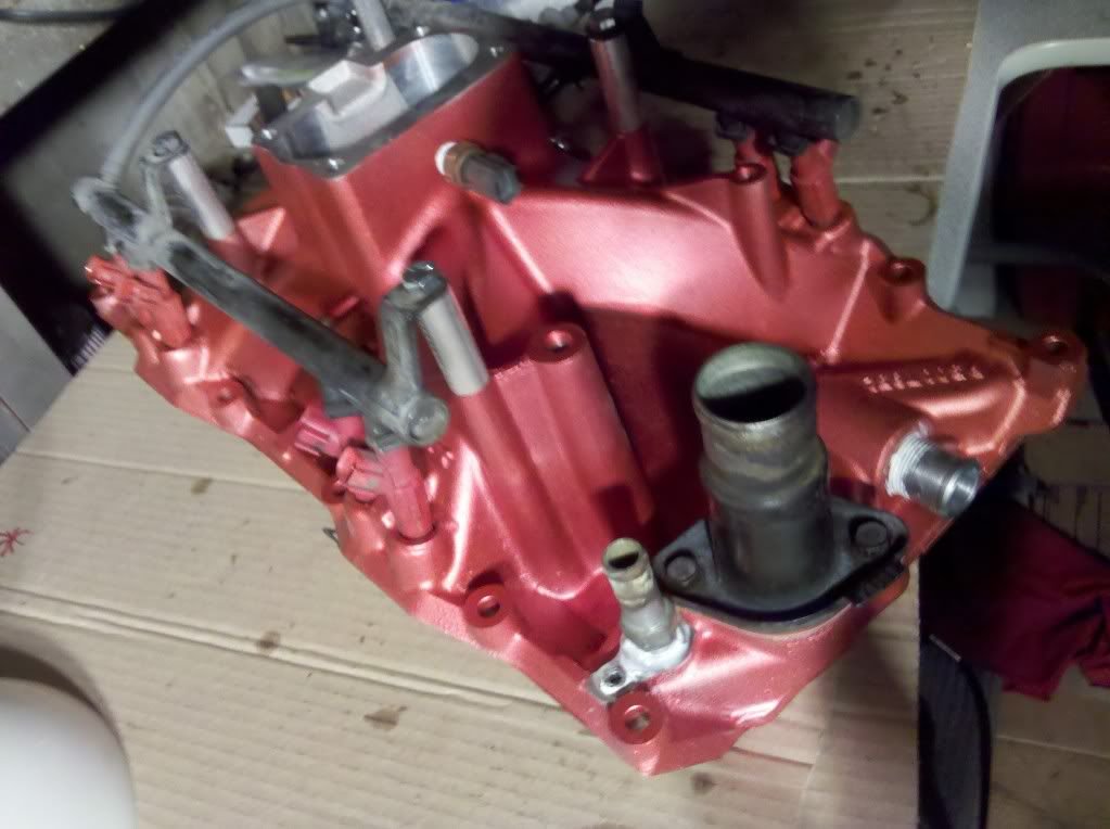

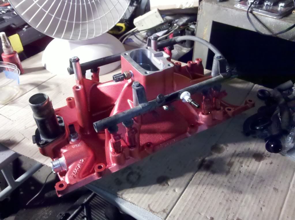

    M1 Intake Manifold
    Could not use my K&N kit due to the body lift. Jeff had a spare 14x3 to toss on there.

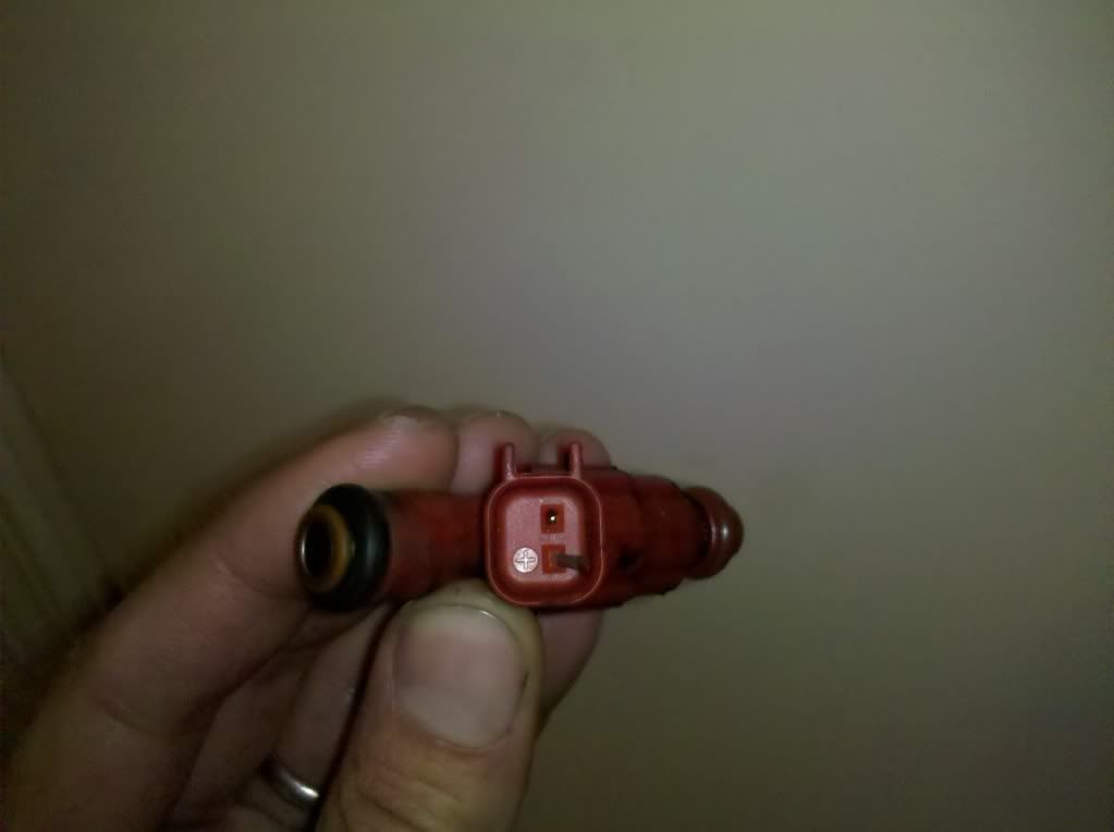

    Only 1 glitch right now. Code for injector #5 open circuit. So, no fuel, but there is spark as tested with a timing light. Picked up a new injector today at lunch...and crossing fingers this evening. Seriously...only 1 glitch like this. Well, might be couple others...but I'll leave that for another day. πŸ˜€
    Then get some metal fabbed up for a winch bumper!! I don't want to put the stock bumper back on. 😈

    #1116 Jan 2012, 10:11 PM
    Fixed the glitch. These things don't shoot the fuel when like this...
    Up and running.
    HP bump somewhere like 20-30, but they may be on high side. Torque ~10-15 ft-lbs potentially, I'm not sure. You say lower the torque band? no comprendo.

    Here is the cam card details. I was partial to torque, but not greatly. Most importantly to keep cost down, picked a decent cam with little more lift, but not so much to go out of spec for remainder of stock valvetrain. Down the road...considering roller rockers to get even more lift.

    #1717 Jan 2012, 8:26 AM
    Gibsons are on the list to add. You gonna help me shop for them....? πŸ˜€
    I think you're gonna get a black and yellow M1. 🍺
    #1817 Jan 2012, 7:56 PM
    Yea, I help you shop. Black and yellow comes off just fine with garnet in a blast cabinet. Sniff, sniff ? Is that a stroker motor I smell ? ( I wish )
