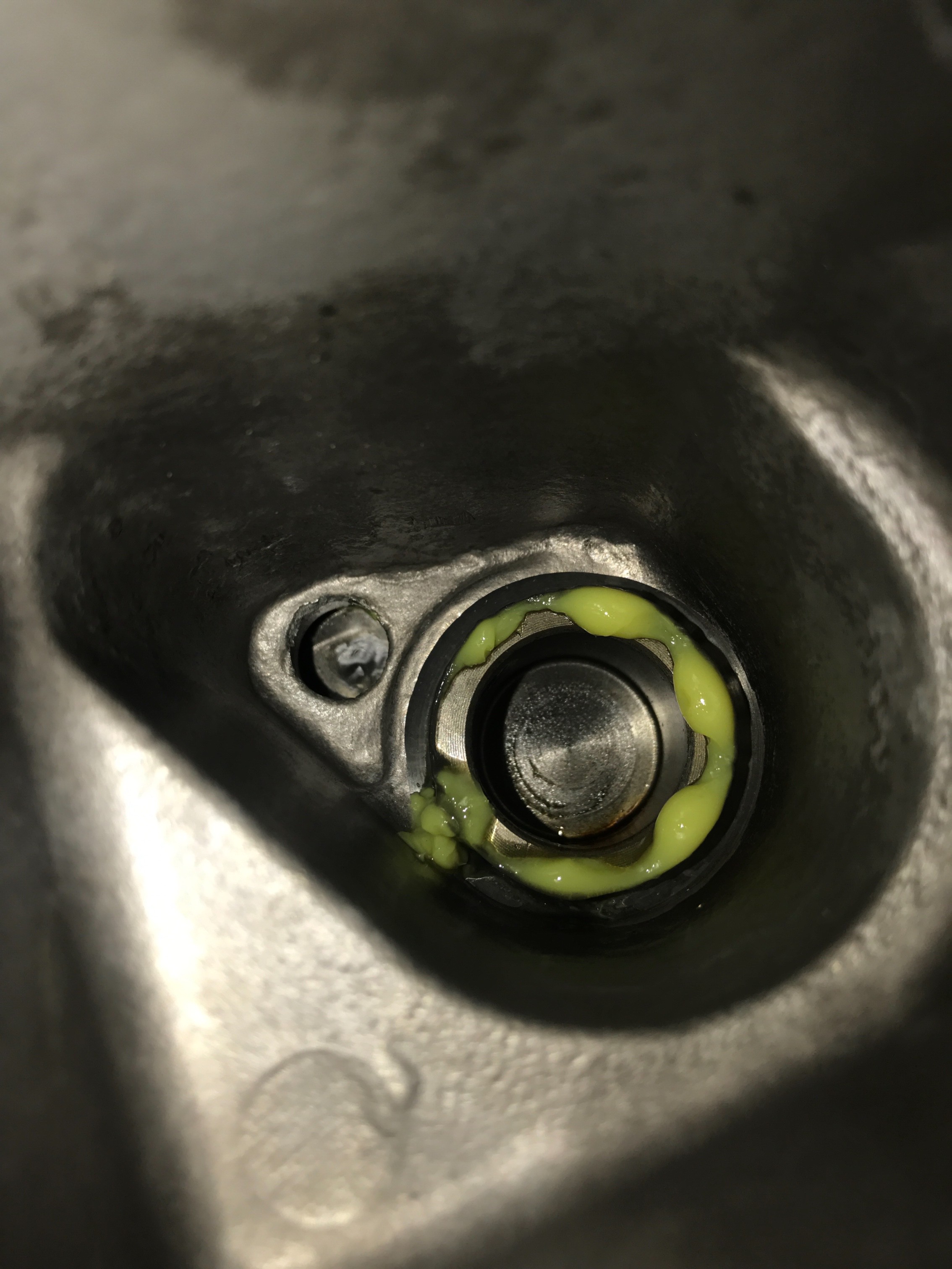

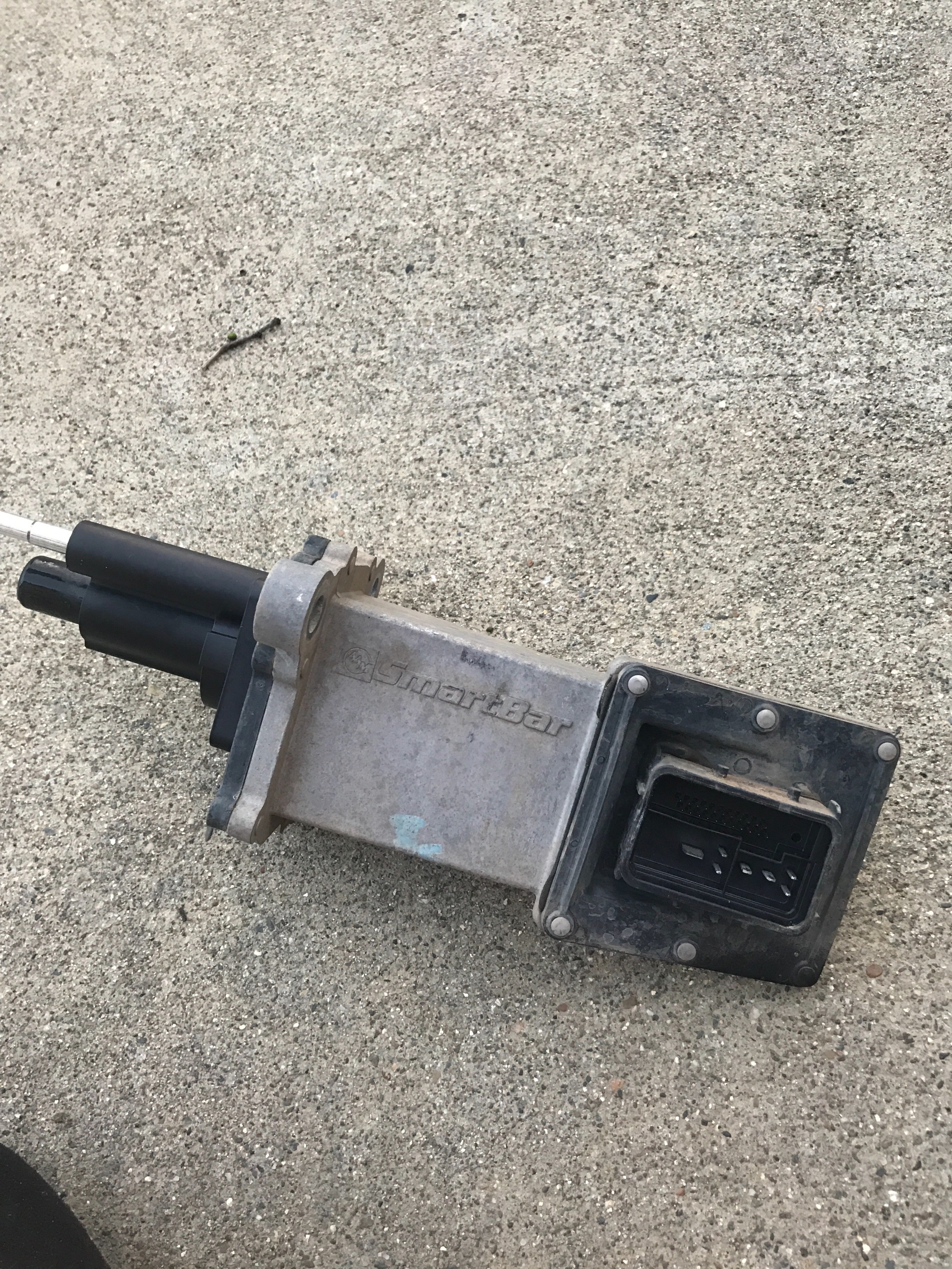

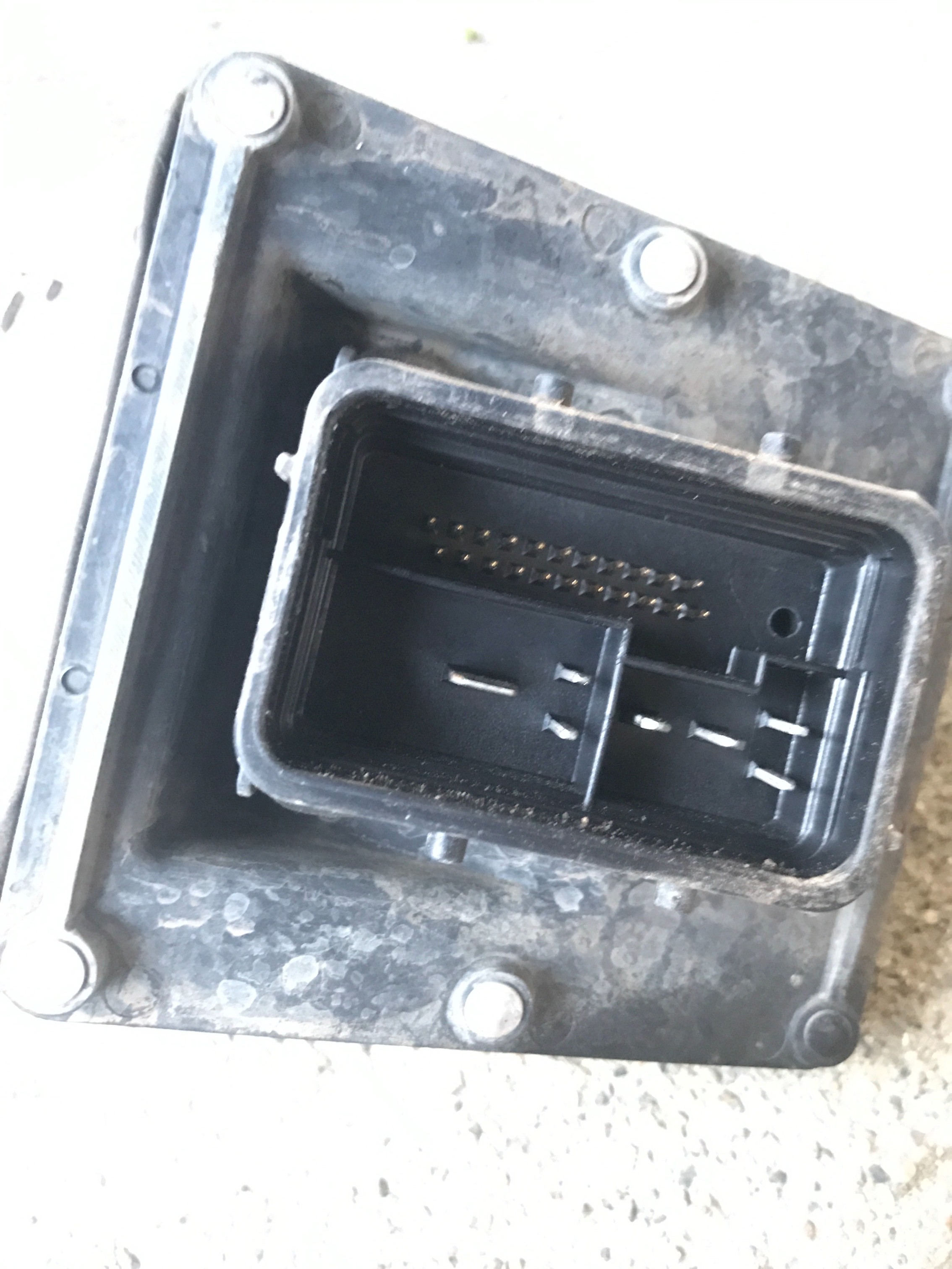

  9. Brian started this Member Joined: February 2020
    #93 Apr 2017, 12:13 PM
    All of these were super clean. Inside the smartbar I assume is where the board is. ?

    #124 Apr 2017, 6:44 AM
    Brian said IMG_0493.JPG All of these were super clean. Inside the smartbar I assume is where the board is. ?
    Yes. It looks like they used rivets on yours.  Since you have it out, plug the unit in but leave it unbolted from the disconnect.  In 4low have someone click the swaybar button and see if the actuator is moving.  If the motor is working, the actuator will slide about 1 inch in and out.
    If the motor isnt working then you found your issue and it is inside that unit.  If the motor is working but doesnt actuate when bolted up then the issue is in the shift collar housing.
