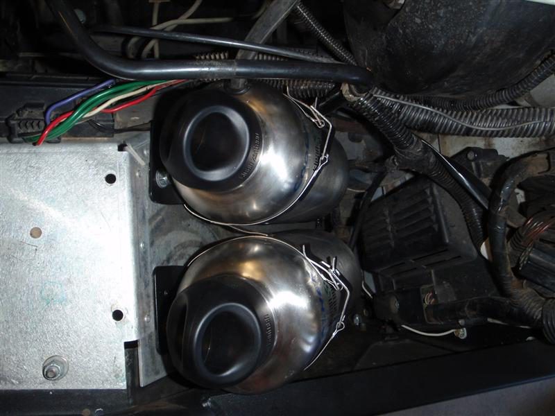

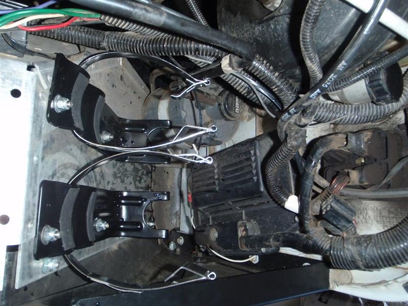

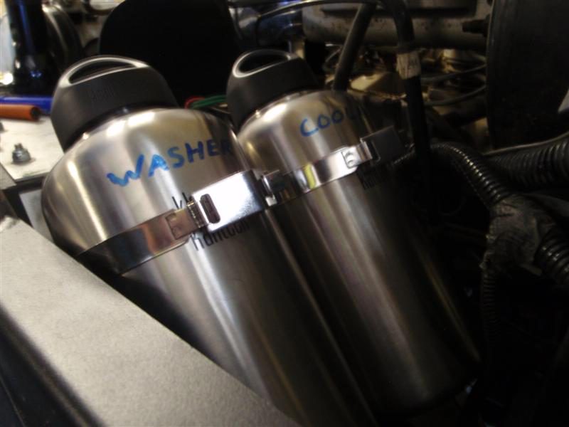

    So I ended up using a couple of 64oz stainless steel bottles. Inside of caps are stainless as well. Drilled one hole in the bottom of one for the washer pump. Drilled one hole at the top of the other for the overflow hose (open system). Reinstalled the grommet from the washer pump and installed a new grommet for the overflow hose. Then used some fire extinguisher mounts mounted upside down and secured in place. This is on the driver's side inner fender. Here's the result...
    #829 May 2011, 4:23 PM
    Very cool. Hope it works out!
    #929 May 2011, 6:06 PM
    So far so good. Took it for a drive and no rattles. Brought it up to normal operating temperature and checked the coolant bottle when I got home. It was warm but not hot.
