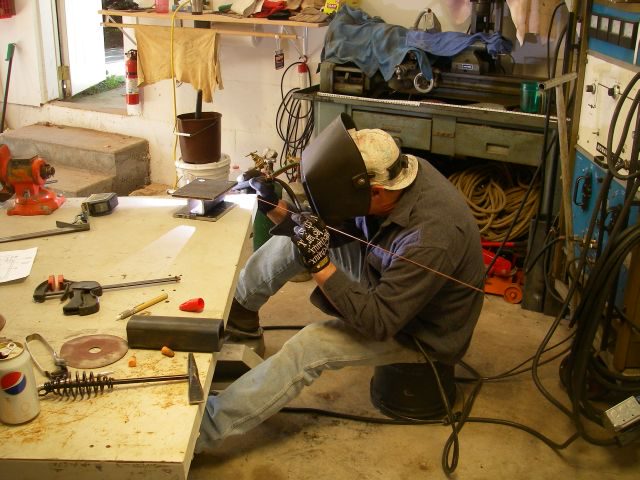

    I finally got to work making a bracket to fit a York compressor in the 4Runner. It's not rocket science but with my fab skills anything is hard. 😀 Thanks to my buddy Dale for the help. Here are some pics.

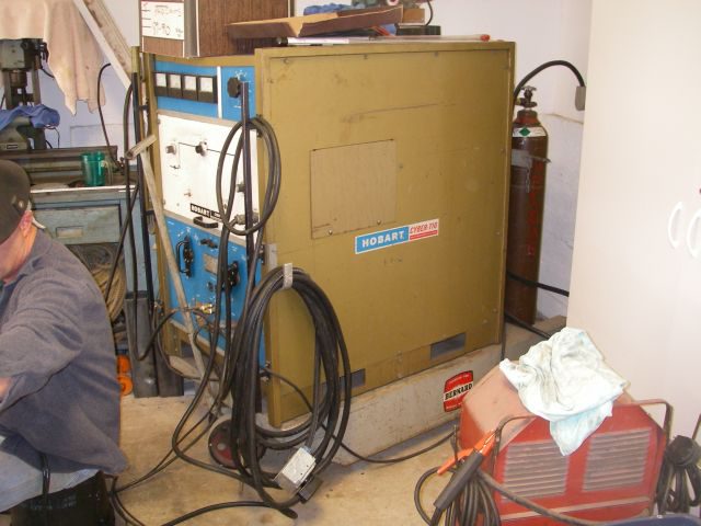

    And for those that believe that size matters with a welder. Here's Dale's setup. 😲
    #34 May 2010, 7:29 PM
    It may not be rocket science--but at least you have one at your disposal 😎

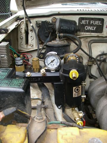

    I finally found some time to work on the York. There really wasn't a good spot under the hood to mount the manifold/filter setup so I got a bit creative. The homemade bracket is redneck engineering at it's finest but it's solid and actually looks decent. Gold star if you can guess what I made it out of. 😀
    At this point I'm just waiting on some fittings and I need to get a belt. I didn't want to pay for Kilby's flange to npt adapters so I bought an adapter that went from the outlet of the york to npt. I couldn't find it locally so I ordered it online. Come on UPS!

    I don't have a tank. I was trying to keep this quality but low dollar. I'll keep my eyes open for a deal and mount a tank later. My plan was to put it in about the same spot you have it. Under the bed kind of where the stock spare tire went. I was worried that it would run funny or over pressurize without a tank, but so far when I'm filling the tires the compressor is on when I'm not it turns off. I couldn't see what pressure it held while airing up, but it must have been ok since it seemed pretty fast. I don't have an ARB so all I plan to use it for is tires at this point.
    You think yours is a cheapo job...no one has even guessed what I made the manifold/filter bracket out of yet. 😀
    #155 Jun 2010, 7:47 AM
    "RobD" wrote: It is a nice set up. I really like how you can return the oil to the pump.The quality of the material it is made out of is very solid.
    I agree. Kilby seems to have figured out how to put a quality setup together. The one corner that I cut that I'm not stoked about is the connection to the York. Like I said above, I didn't want to pay for their npt fittings. I ordered some ORB fittings that aren't quite right and couldn't find the compression type fittings that I needed. No one has them locally (I went to all three spots that might have them 😁 ) but got tired of driving around and didn't want to order something else without being able to test it out. There's conflicting information out there. I can't believe the internet is wrong! I ended up giving up on trying to find the fittings. I tapped the fittings that came with it from the junk yard. On the inlet I have a 3/8" fitting, but the outlet is a 1/4" which feels a bit small. There's an A/C shop down in Rancho that I went to years ago. I'm sure they'll have the right stuff, I just need to get down there. Of course, after ordering the wrong fittings and driving around I probably spent as much as the Kilby fittings would have cost. 😳 I did meet some cool local folks in the process though. 😎
