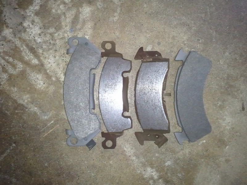

    After I added Toyo tires and beadlock wheels to my Jeep, it seems my brakes weren't up to the extra weight. My last Fordyce trip in October was nerve racking because I could not stop my Jeep coming off ledges or rocks.
    With the help of a ton of information from Fred, I decided to try a 2001 Dodge Durango master cylinder which has a 1/4" larger bore. Installed it and was pretty happy with stopping results on the road. I also found some info on larger brake pads that work on the Chevy half ton brakes I run on the front. Wagner MX614 or SX614 from a 1980 to 1990 Chevy Police Cruiser or 1994 to 1996 Chevy Impala will fit and have a considerable more amount of friction material. Installed those, flushed the fluid, and hit the Rubicon this weekend. What a difference! I am real happy with the stopping.
    Thanks for the master cylinder info Fred. 😎
    Here is a picture of the Brake pads. Stock pads are in the center and the MX614's on the outside. Just thought I would post this up in case anybody wants to try it.

    I had no idea that GM had different brake pad designs for the same calipers. That's a lot of extra braking material.

    Note: Unless you've changed the size of your calipers or changed from drums to disks, don't mess around with swapping different master cylinders. It may change the way your brake pedal feels but it won't improve your braking.
