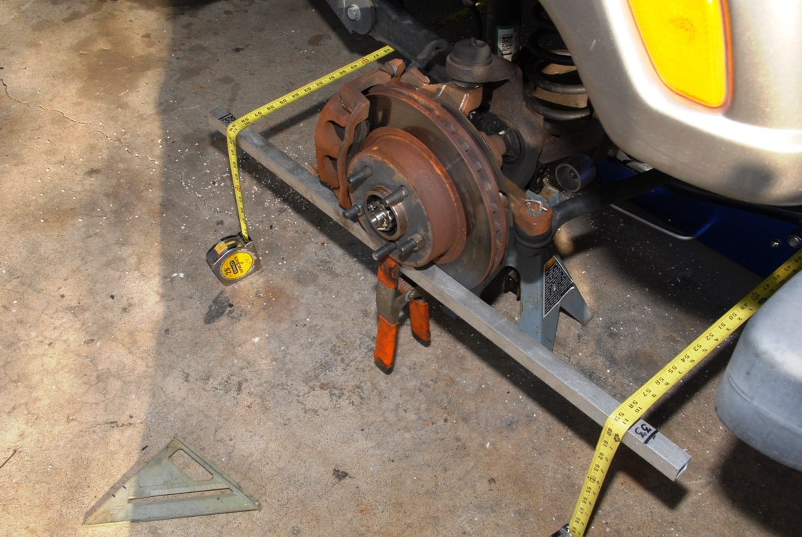

Here's how I'm going to align mine next time. (the pic is from a thread on another forum)
1" tubing cut to the diameter of the tire with the center marked, and lines for 33s or 31s. note the rotor is bolted snug to the unit bearing. this might not be needed depending on your front hubs.
Image Enlarger
using two tape measures is pretty smart...
Image Enlarger

"Dan-H" wrote: Here's how I'm going to align mine next time. (the pic is from a thread on another forum)
The MrBlaine technique

"FAM" wrote: [quote="Dan-H"]Here's how I'm going to align mine next time. (the pic is from a thread on another forum)
Yeah, I was trying that with 2x4s. But I couldn't convince myself that it was right. I kept thinking that the 2x4s need to be exactly parallel (in 3d) with each other unless they went through the dead center of the wheel. So I tried to set them level, which got tricky since I was working in the gravel. The truck also wasn't level, but I convinced myself that it didn't matter. I kept screwing with everything until I got frustrated and quit. I wasn't happy with the ride (vibration) and steering so I figured I'd have it done. In reality, the problems I was trying to fix are probably more related to my pitman arm being loose than the alignment. I'm convinced that I could get it good enough, but that they can get it way better.

"Dan-H" wrote: I already have the square tubing, I just need to cut it.
Cutting it for your sized tire isn't important. Measuring the exact same distance from the pivot point is. There's a fair amount of eye balling involved, but like I said, you could probably get it close enough.

"Bender" wrote: Cutting it for your sized tire isn't important.
I have one eight foot length of square tubing.
I think I should cut it in half so I can use two pieces 😉
Having the center marked, and the radius of the tires marked will help to make accurate measurements. The two "tape measure" lines should be parallel for the measurement to be accurate.

Figured I'd follow up on this. Kelly took the truck in today for the alignment. Good news...I got the toe so close using 2x4s strapped to the tires that it was within specs they didn't adjust it (and didn't charge me). Bad news...My thrust (front to rear alignment) is waaaay off. A couple of people have told me that the truck dog legs pretty bad. Hopefully the new bushings will take care of it. That's the conclusion that they came to. Fortunately it's cheap and I ordered them a while ago. I'm really hoping that cures my vibration.
Moral of the story, do your own toe alignment. Even with the most basic tools, you can come as close as they pros can. 8)
