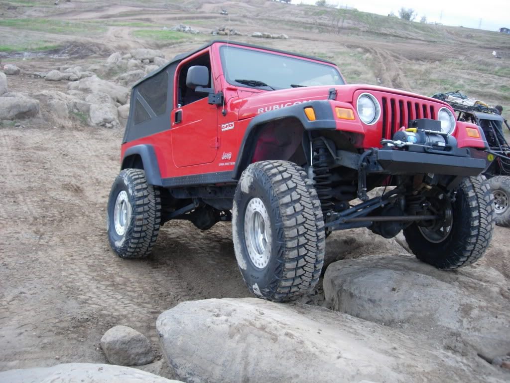

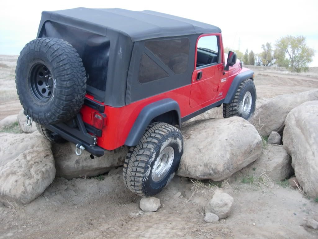

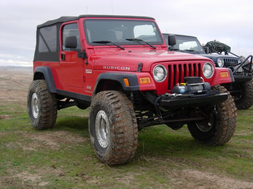

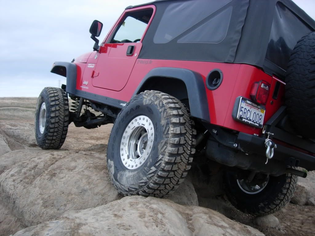

    Alright, I got them mounted and all I can say about these tires is that they are SMOOOOOOTH!!! I feel like I am riding on street tires. I ran out to prairie city today. They did awesome in the rocks. They weren't so good in the thick mud. But I am happy with them. They aren't very loud at all. It's almost disappointing. Heres some pics.

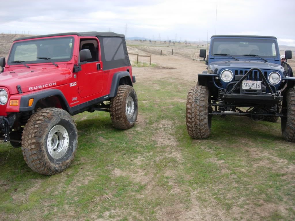

    And here they are next to Irok 39.5s

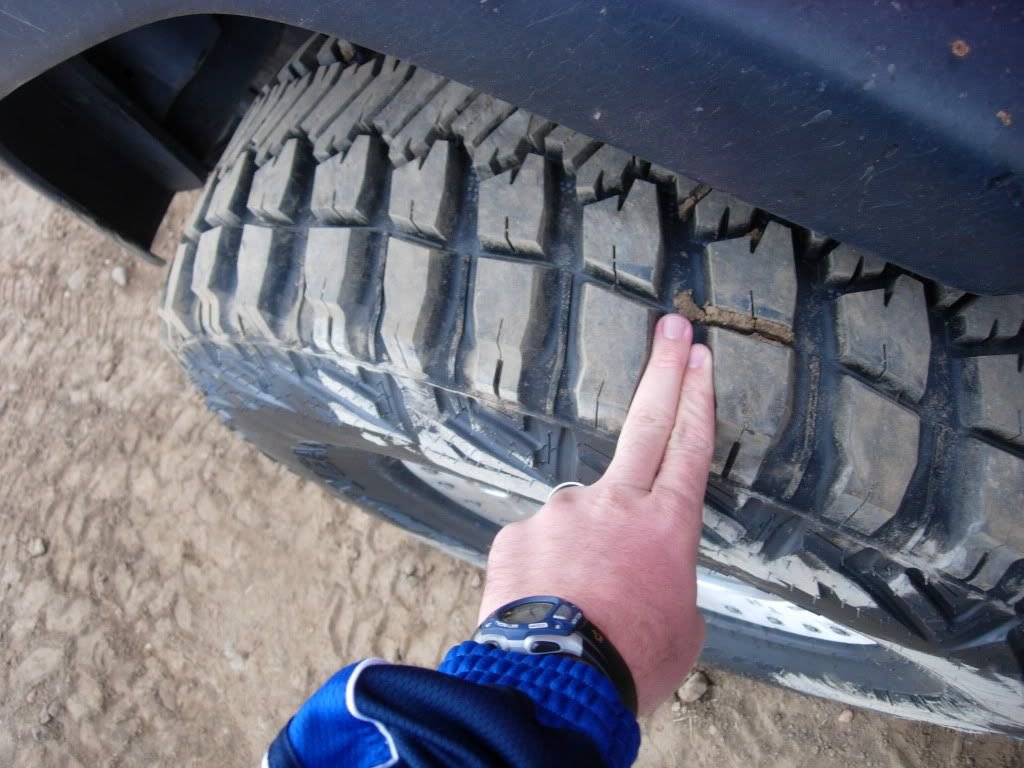

    And here's a close up of the tread gap on the outer lugs.
    I really am pleased with these tires. And I love the trailready beadlocks. It looks like I have a yuppie jeep now. πŸ˜‚

    I bet they are a LOT smoother than what you took off πŸ˜‚

    The Kevlars hook up good when inflated, but they are incredible when you drop them to 5 or 7 pounds in the rocks!!!!! With those beadlocks you can drop them down to 5 or 8 pound with no probelm. Your only limitation when the tires are that low is your steeing. You stock box will have a hard time turning tires that low in the rocks.

    Nice Jeep, but if you plan on playing in the rocks, I would get that gas tank a real skid plate!!!!

    "RobD" wrote: Nice Jeep, but if you plan on playing in the rocks, I would get that gas tank a real skid plate!!!!
    No doubt there is a lot more $$ that needs to go into my jeep. I only bought the wheels because I got a KILLER deal on them. Next up will be rock sliders, skid plates, rear cromo shafts and a cage.
