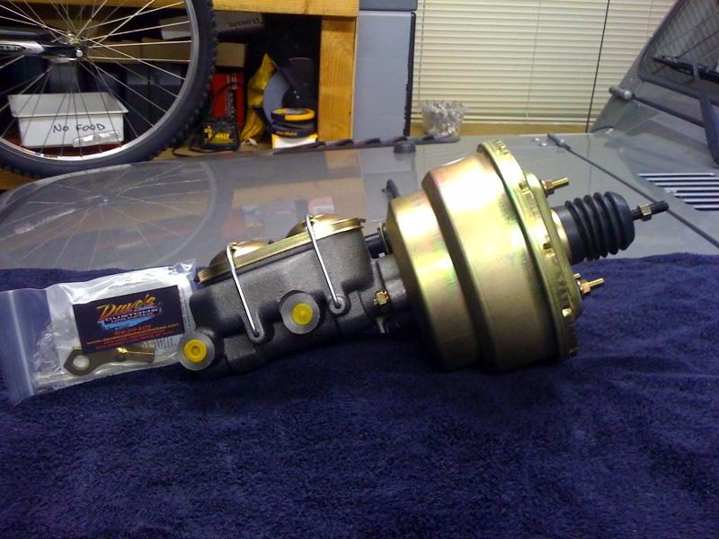

    Well, I'm working from home today and was staring at the article hanging on the wall about Dave's booster/master cylinder combo. I just got off the phone with Dave and ordered it. 😁
    The kit he generally recommends and the one I ordered includes the 8" booster and a master cylinder derived from the Corvette master cylinder.
    We talked about my current set-up and he recommended I remove the 2 lb residual pressure valves regardless of whether or not I install his kit. He also suggested while running his kit to remove the factory proportioning valve altogether. I'm not entirely sure about that idea but who knows. Since I already have direct lines for the front brakes and an adjustable rear proportioning valve he said just to open it up all the way and make any small adjustments as needed.
    I sure hope this works as well as he says it should.

    #1823 Dec 2009, 6:58 AM
    Brown Santa dropped off a package last night.
    #1923 Dec 2009, 7:57 AM
    I hope it does everything it promises šŸ˜Ž
    #2023 Dec 2009, 8:03 AM
    "JohnDF" wrote: I hope it does everything it promises šŸ˜Ž
    It would be a Christmas miracle! šŸ˜‚ šŸ˜€
    #2123 Dec 2009, 8:57 AM
    My what a big Power Booster you have!!!
    #2223 Dec 2009, 8:58 AM
    That's perty!

    #2327 Dec 2009, 5:58 PM
    I installed my new parts today and have a mixed opinion of the results. This booster & master cylinder are far better than any other vacuum powered booster/master combo that I've tried in the past. Normal braking feels really good, but it still seems like I'm not getting enough pressure for emergency braking. I can lock up the tires at about 45 but it takes a lot of leg pressure to do it.
    I did take a bit of a shortcut though. Dave said to remove the residual pressure valves and preferably remove my adjustable proportioning valve. I didn't have the fittings I would need so I left them in. I'm wondering if there may be a restriction in the lines because of all the extra parts & adapters.
    I'm also thinking about ordering the EBC Yellow Stuff brake pads that MrBlaine likes. I've got the EBC Green Stuff pads on the front now but only have Napa pads on the rear.
