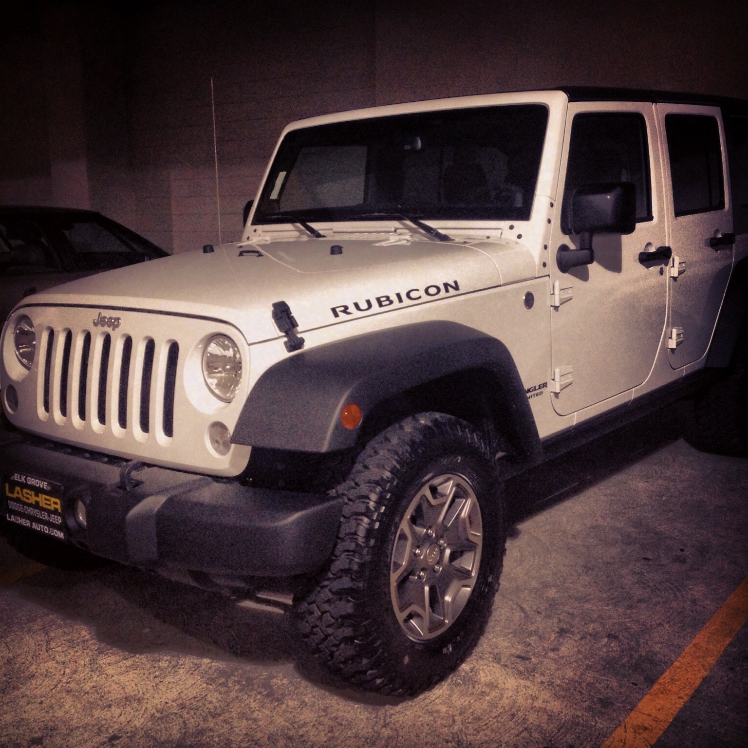

2014 Jeep Rubicon Unlimited
3.6L, 6 speed manual with all the rubicon goodies.

I think the first thing you need to do is change your avitar picture to the white Jeep.
It's on my to do list...
