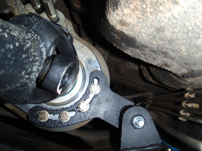

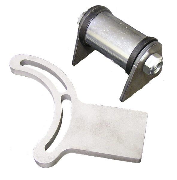

    I did get the one offered by Stak. The transfer case has mounting holes front and rear. I didn't have room in the rear so I mounted it on the front. A co-worker who also knows how to weld did the welding of the bracket for me. I had him mount it on a 1/4" plate and then bolted that to my stock transfer case skid plate. The reason I did that is because I plan on getting a better skid plate at some point in the future. Here's a picture of the mount from Stak and a picture of it mounted with the front driveshaft to the left.
