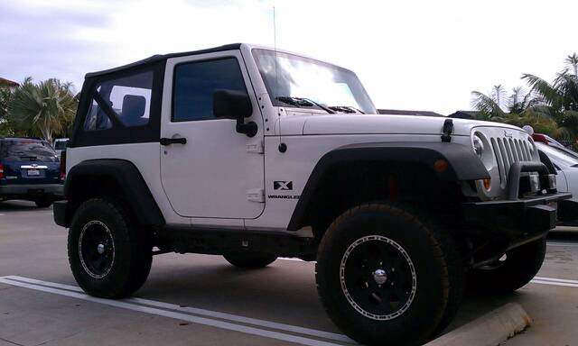

    On vacation in San Diego and I ran across a deal I just couldn't pass up. I bought a 2007 Jeep JK 2dr sport, auto. It's got 3700 miles on it. The previous owner pulled it behind his motorhome. It needs a little TLC but considering I paid less than 10k for it, I'm ok with that. I'm driving it home on Monday while Liz and Lauren fly back. First mod will be an oil change and new wipers in case we hit rain. Pics to follow.

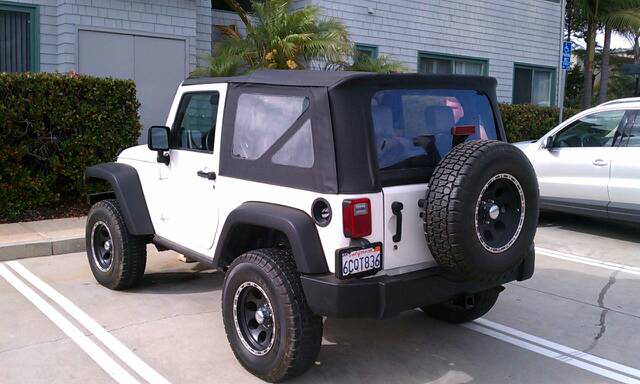

    Not big fans of the bumper, side rails, lift, or wheels. You can see why its a project.

    Its pretty much the base of the base models. It has an automatic transmission, air conditioning, basic am/fm CD stereo. It was left under a car port with just a bikini top on for a few years so the roll bar padding, carpet, and seats could use a good cleaning or replacing. The tires have to be the cheapest round things that would hold air the previous owner could get his hands on. Think 5 spare tires. πŸ™ No power windows or locks. No cruise control. The axles are D35s probably with a 3.Xx gearing. No lockers. It has some cheezy budget boost(pucks) with white and red shocks. I assume Skyjacker for the lift, but don't see any logos. When they installed the lift they didn't change to an adjustable trackbar so it looks like the rear axle is about an inch off to one side. The ride is a little rough but I'm not sure if its the budget boost, crappy tires, or the fact that the lift is queationable. Or it could be just the ride of a 2dr vs my 4dr.
