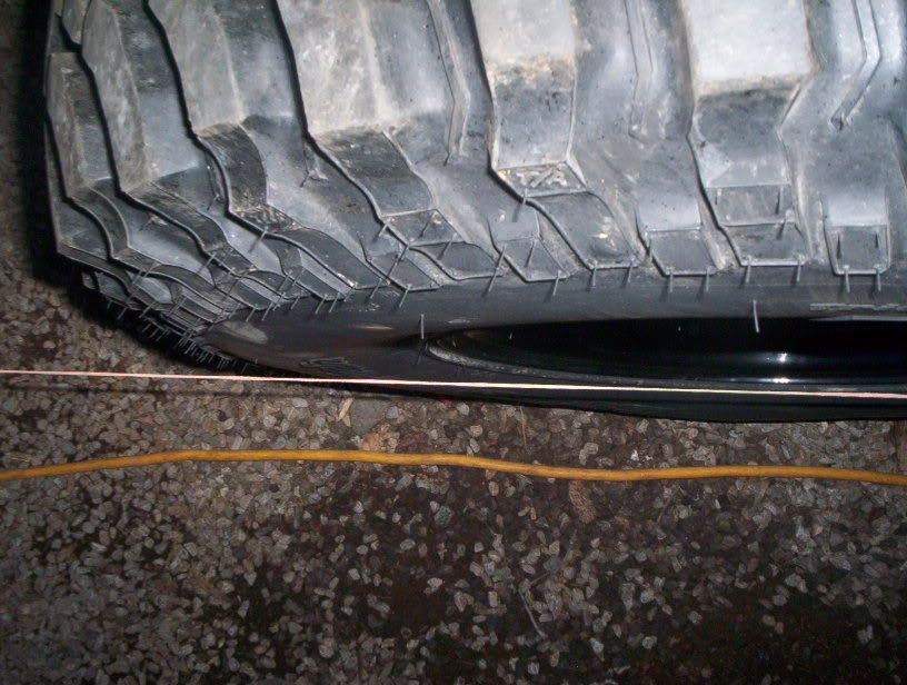

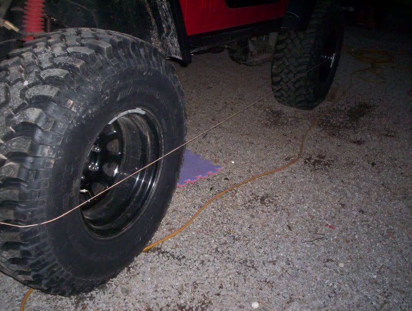

    i have bad rear steer and wanted to check if my tires were lined up. i put a string all the way around and found that the left rear is facing in almost a 1/2".
    the spring is shorter by at least a 1/4" from the center pin to the front of the spring. the tire is almost a 1/2" closer to the front tire on the drivers side. that would explain the jeep pulling right when im on the gas and left when i let off.
    i already addressed the bump steer in the front.so i dont think thats it.

    I wish my axles were that square 😳
    But hey...it's a Jeep...
