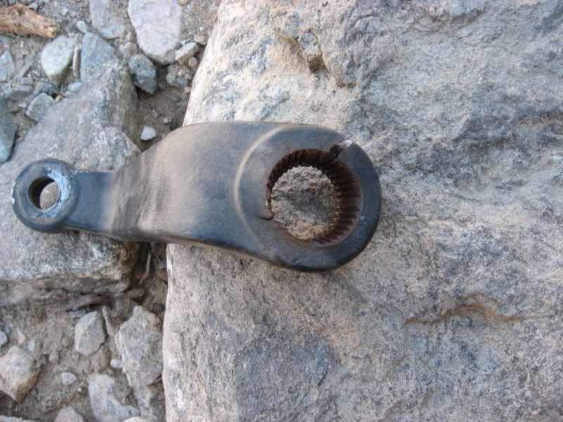

  14. Justin Subscriber
    #149 Feb 2010, 7:45 PM
    "JohnDF" wrote: and they are mandatory for Hammers trips...ask Justin how he knows 😁
    Yeah, John saved my rear on that run. I didn't have a spare but John happened to have the one I needed. 😎
    I now carry a spare.
    My offering to the mailbox at the top of the Sledgehammer Trail.
