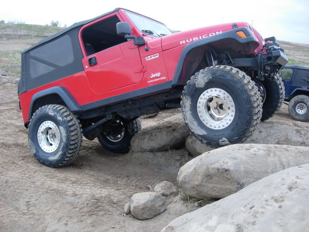

    #528 Jan 2010, 5:34 PM
    Aluminuminuminum 17" with 37" MT/Rs 😎
