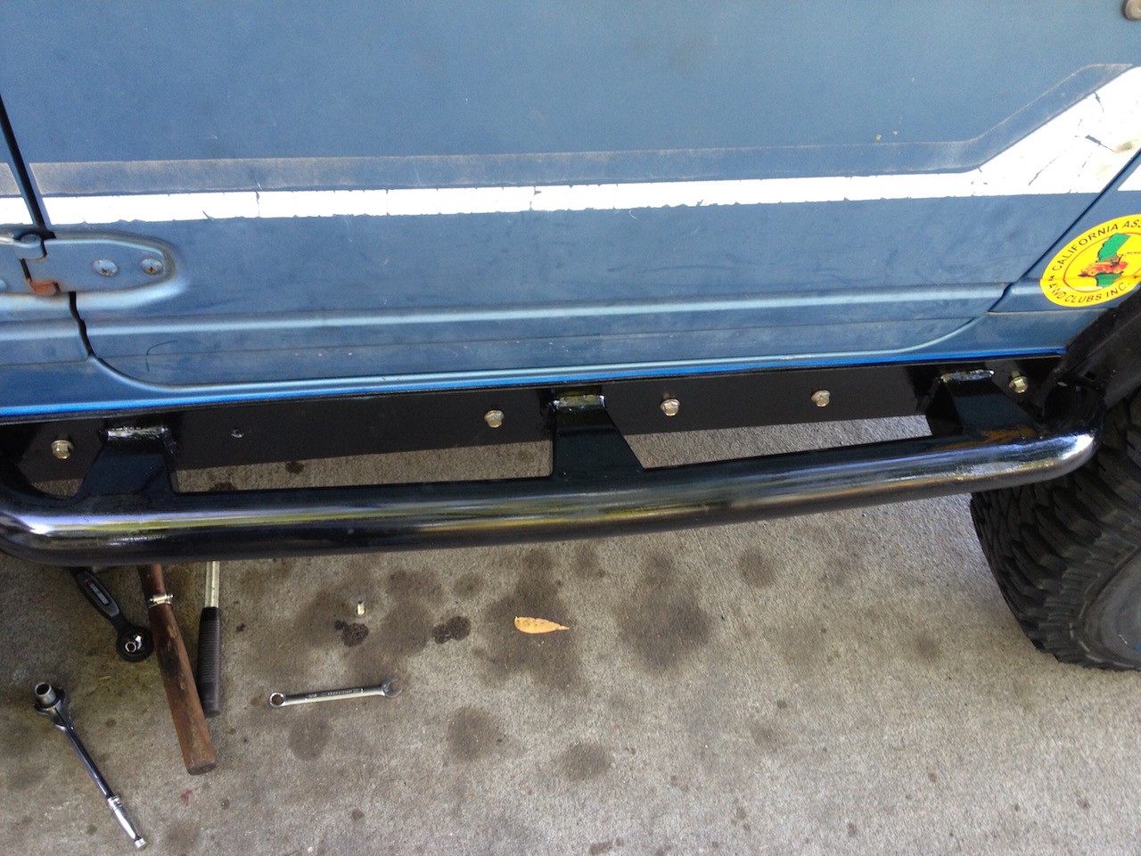

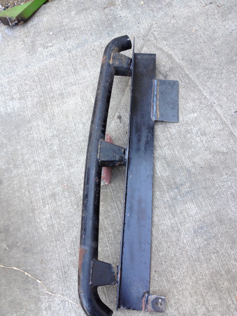

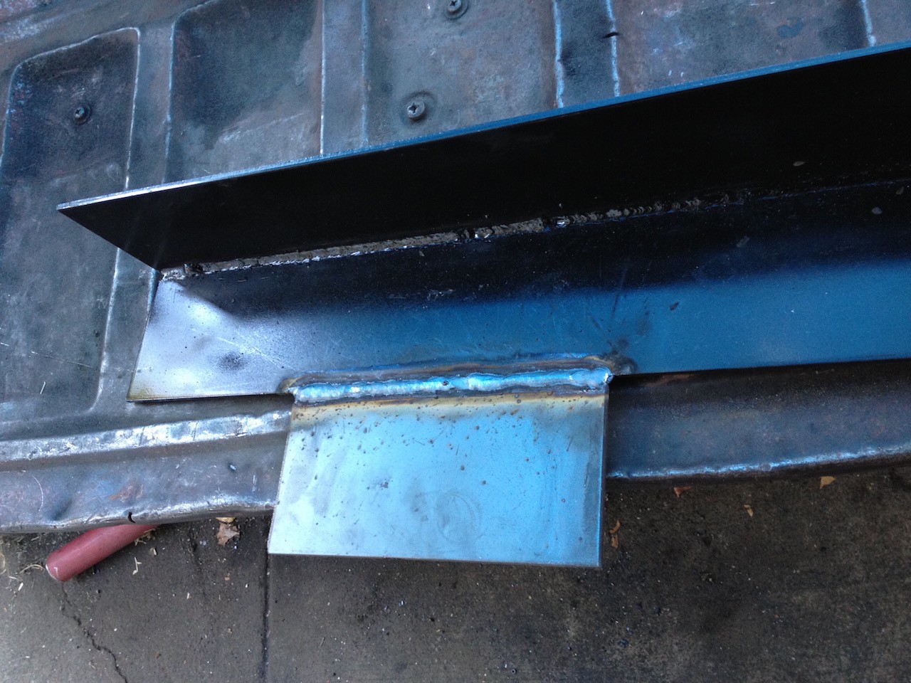

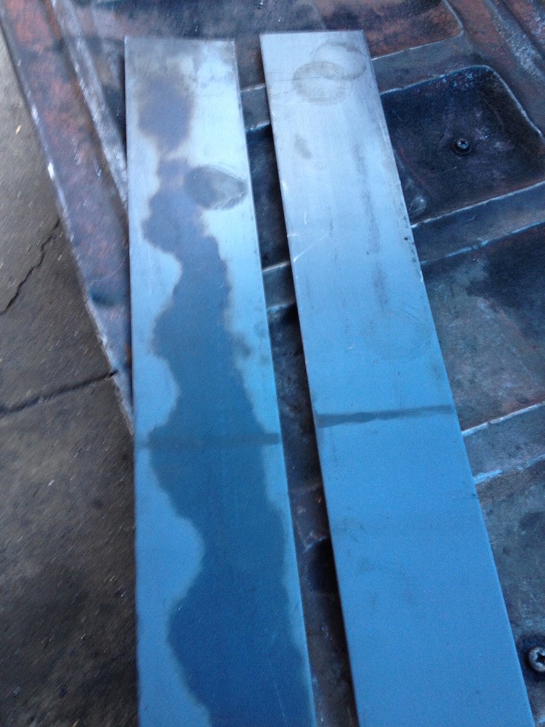

    On my Samurai I used 3/16" thick plates and hooked to body. Yea I know not even close, but you asked. For your F150 I think at least that thick of plate. The tube I would think 1/8" or even going 3/16" for serious rock crushing. If you hook to frame you'll have to brace it a lot more sense it will have to reach out further. The question would be to decide what and how much are you wanting to protect.IMG_1070.jpgIMG_1072.jpgIMG_1076.jpgIMG_1094.jpg
