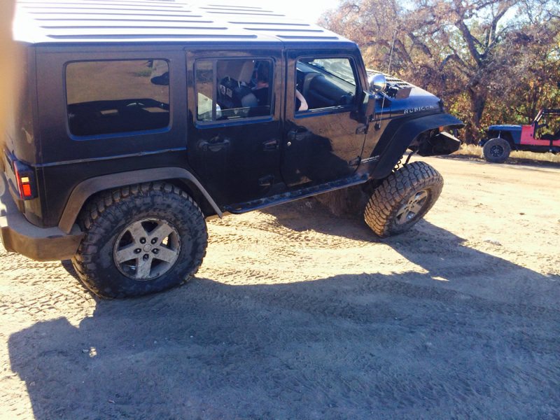

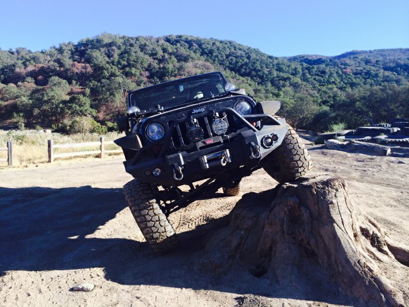

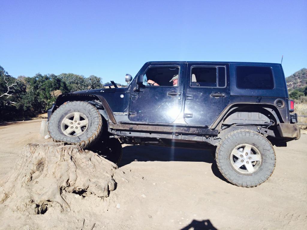

    I've been running 37 km2s for years on nothing but a cheap teraflex lift - the only place I've been told they are weak is in the snow and I've done many snow runs and never had an issue - I will probably never buy another tire - just going up in size next go around.
    I have the lame 3.8 and auto box and I ran them on stock gears for months - worked but was stupid - the 3.6 with a 3 pedal set up should be manageable
    - that and I'm at 50 thousand miles on them and still have some left which is a +
    #147 Jan 2015, 6:47 AM
    How did they stuff with stock fenders?
  15. scoped Subscriber
    #157 Jan 2015, 11:59 AM
    Not the best pics but it's all I could find - I have never rubbed anywhere and may have just a bit more room to trim the bump stops
    https://posse4x4.org/wp-content/sp-resources/forum-image-uploads/scoped/2015/01/IMG_9082.jpghttps://posse4x4.org/wp-content/sp-resources/forum-image-uploads/scoped/2015/01/IMG_4427.jpghttps://posse4x4.org/wp-content/sp-resources/forum-image-uploads/scoped/2015/01/IMG_6202.jpg

    Looks good, but hard to tell if you would have mashed the non-trimmed fenders. Almost looks like it would though. Thanks for the pics.

    Not that it matters any more but yes without the trim on stock fenders I did hit them.
    I think 37s are a much better option on a 4 Door as opposed to 35s
