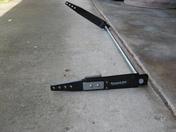

    I just went to try and install my new dual rate Swayloc on the front of my Jeep. Well, the inner torsion bar is machined wrong. :x :x :x It's not splined, it's machined with a flat spot that the arm slides over and the flat spots are off by 30 degrees which means if I put one arm where it needs to be, the other one will be 30 degrees up or down. :x :x :x I sure hope their customer service is better than their machine work when I call tomorrow. (Unless I'm missing something, but I don't see any other way to mount them). :x :x :x

    Justin, That is not how they are supposed to be. The inner torsion bar is not splined but has a flat spot machined in the same spot on both sides. I believe the flat spot faces the rear.

    My inner torsion bar on my Swaylock is splined on both sides and the arms are probably 10 to 20 degrees off..The arms not being parallel is no big deal..

    There is no way to even mount the arms on the way it is machined. The flat spots have to line up for the arms to go on. If I line up one side, then the other sides flat spots are 30 degrees off from each other and you can't put the arm on.

    I just got off the phone with ORO. I left a message and they called me back within 15 minutes but, they basically don't believe me. They want to see pictures before they send out a replacement. 😲 The guy I talked to is the machinist and couldn't believe that he would make this kind of mistake. He said they need to be within 1 degree of each other for it to work. Like I said, there is no way to mount the arms in this configuration. He was extremely nice so hopefully I make positive progress in trying to get this resolved.

    I had the same problemish With terra flex. They called back right away after they got the pics. My pass side arm was put together backwards and upside-down. They replaced it with a dual rate which is still in the box. I don't think you will have any problems once they get the pictures.

    Here is a pic of the inner torsion bar with the arms on. 😂
    #1110 May 2010, 8:17 PM
    Whoa!
    Time for a return!
    At least it's only the bar. ORO will probably rush ship you the new bar and have you return the old one in their packaging. Quick and simple.
    You'll be ready for our next snow run in day or two!!!
    #1211 May 2010, 5:37 AM
    It looks just a bit off 😂

    Received an email from ORO this morning with a tracking number for the replacement that's on it's way. 😀 😎

    "Justin" wrote: The guy I talked to is the machinist and couldn't believe that he would make this kind of mistake.
    "Justin" wrote: Here is a pic of the inner torsion bar with the arms on. 😂
    Maybe it got twisted during shipping. 😂
    #1811 May 2010, 11:10 AM
    That's amazing. Did they have any explanation?

    No. He sounded really shocked since he does 95% of the machine work there. I guess whoever does the other 5% did this one.......probably on a Friday afternoon. 😂
