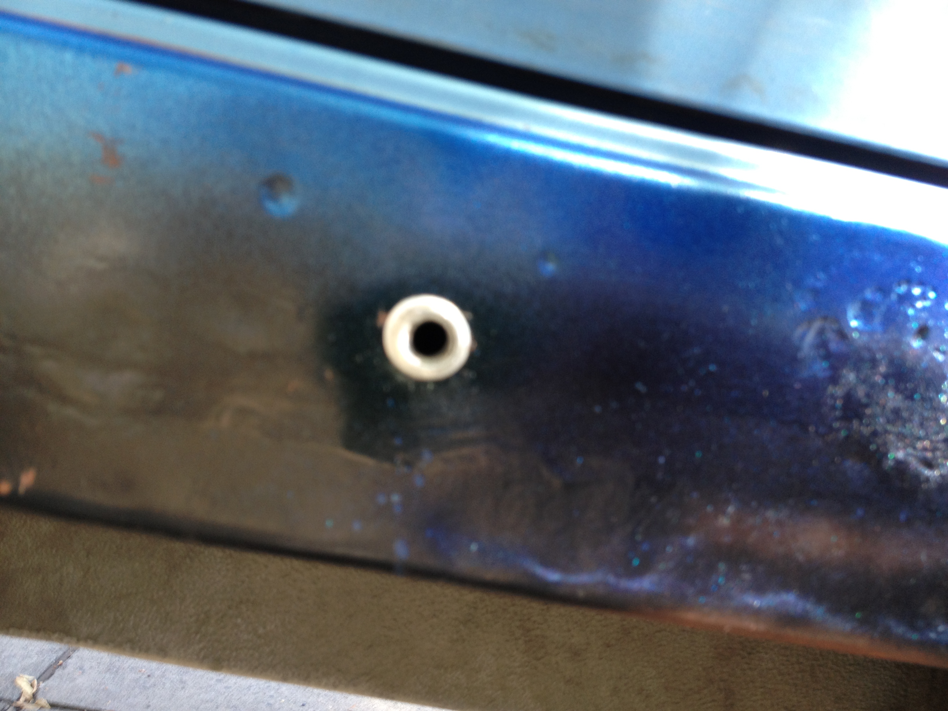

For those DYI folks, I made my own nutsert/rivet-nut tool. Grade 8 bolt & a flange nut one size bigger than bolt so it will slide (I use a lock flange nut to grab top of rivet-nut) and flat washer. All your doing is pulling the threaded part to compress it to cause the material to bow out and grab. It's what I used to mount my rock sliders on the side of my rig. Simply thread the bolt into the rive nut then hold the flange nut with a wrench, use a ratchet and start tightening the bolt. I use a air gun to speed it up. The bolt will squished the rivet-nut to expand the collar. the only down side is some time it will leave teeth marks on top of rivet-nut. But I found that if I didn't use a nut with teeth the rivet-nut would just spin when I tried to tighten it.IMG_4321.jpgImage EnlargerIMG_4323.JPGImage EnlargerIMG_4324.jpgImage Enlarger

What he said. Same for my T-case skid. Not too difficult. The hard part is getting the holes in the fenders lined up to the nutserts you install.

For those DYI folks, I made my own nutsert/rivet-nut tool. Grade 8 bolt & a flange nut one size bigger than bolt so it will slide (I use a lock flange nut to grab top of rivet-nut) and flat washer. All your doing is pulling the threaded part to compress it to cause the material to bow out and grab. It's what I used to mount my rock sliders on the side of my rig. Simply thread the bolt into the rive nut then hold the flange nut with a wrench, use a ratchet and start tightening the bolt. I use a air gun to speed it up. The bolt will squished the rivet-nut to expand the collar. the only down side is some time it will leave teeth marks on top of rivet-nut. But I found that if I didn't use a nut with teeth the rivet-nut would just spin when I tried to tighten it.https://posse4x4.mystagingwebsite.com/wp-content/sp-resources/forum-image-uploads/specialsoundman/2016/01/IMG_4321.jpgImage Enlargerhttps://posse4x4.mystagingwebsite.com/wp-content/sp-resources/forum-image-uploads/specialsoundman/2016/01/IMG_4323.JPGImage Enlargerhttps://posse4x4.mystagingwebsite.com/wp-content/sp-resources/forum-image-uploads/specialsoundman/2016/01/IMG_4324.jpgImage Enlarger
I actually tried this after looking at youtube. it worked a few times, but then then bolt failed and broke in two. I was trying to use one of the stainless 6mm bolts that came with the fenders.

That's why I used a grade 8 (10.9 or 12.9 metric) bolt. Are they steel or alum? If they are steel, your most likely going to need the tool.

If you need some help let me know. Cause it worked for me on mounting my rock sliders and the mount for my air compressor.

thanks for the offer Dave! I found a nutsert tool at harbor freight for $21 worked just fine. i just had to use 1/4 20 bolts instead of the supplied metric bolts. Fenders are now complete!
