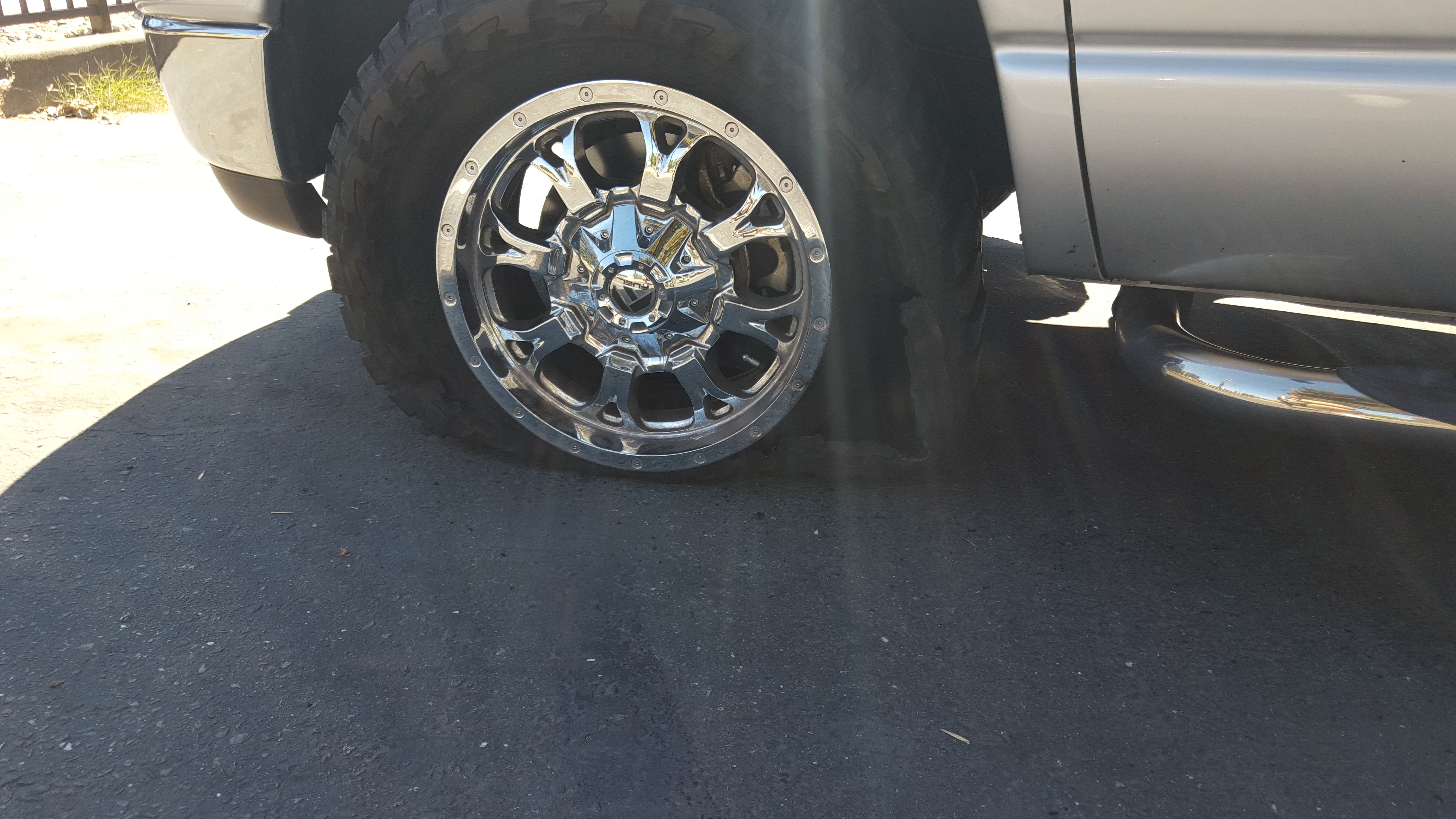

  5. Sloguy started this Member Joined: June 2019
    #520 Jul 2019, 11:08 AM
    Thanks for the advice.  I can understand Kris's point. I had a similar situation where I had a slow leak on my truck tire and did not notice and the tire blew on the freeway. Didn't have a tire patch big enough haha. I am more diligent with checking tire pressure over the years so I may forgo the TPMS.
