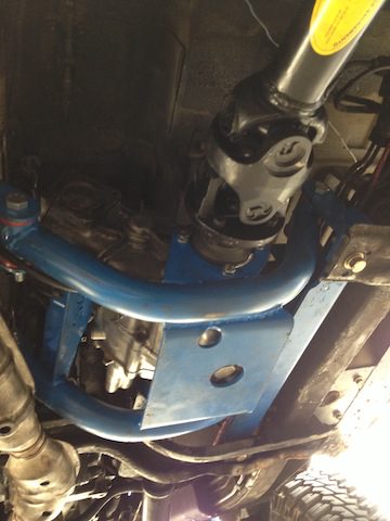

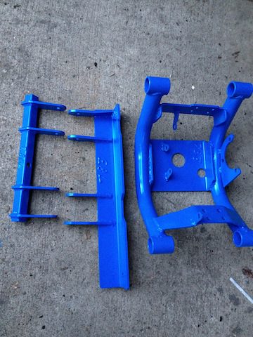

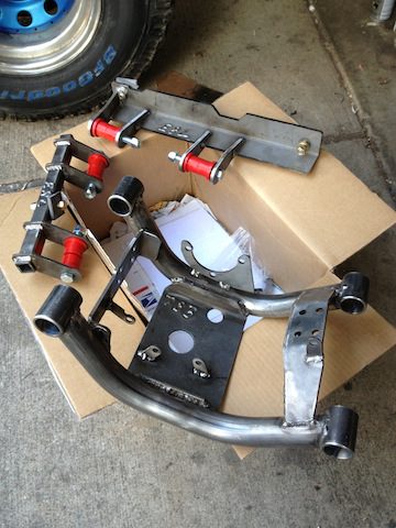

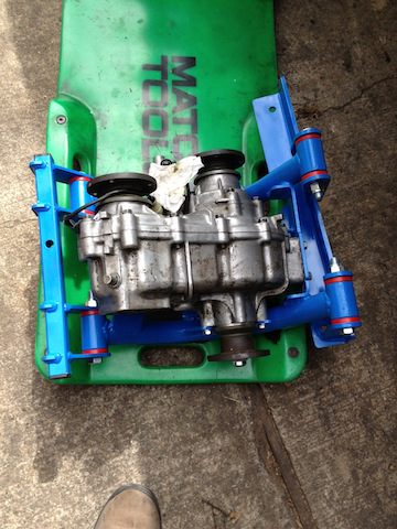

    Ok got my heavy duty transfer case cradle/mount yesterday. So i painted it, of course.....blue. So today I tore my transfer case apart and put in the 6.5:1 crawler gears and all new bearings in it. tomorrow I will be putting it all in. Then test run Saturday 4/6/13
