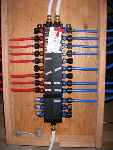

    #1416 Nov 2008, 2:42 PM
    Here's the installed Manabloc. It act like a circuit break on the electrical side. Makes it pretty easy to shut stuff on and off.

    #1516 Nov 2008, 5:00 PM
    Looks nice and neat. What size is the PEX tubing? It may just be the picture, but it looks kind of small.
    #1616 Nov 2008, 8:30 PM
    "FAM" wrote: What size is the PEX tubing?
    The size varies. The white stuff coming in the top and bottom is 3/4". Then there's 1/2" and 3/8". Since you're running everything from a manifold to an individual fixture you can run smaller pipe. I've got 3/8" to the sinks and toilets and 1/2" to the showers. They claim that running 3/8" to the sinks will save water because the smaller pipe will waste less while you're waiting for the water to get warm. In the sinks it does actually seem to get warmer faster. I haven't noticed any pressure difference anywhere.
