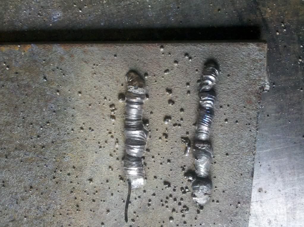

    Update:
    Went to Harris Welding on Auburn up in Citrus Heights last Saturday. Picked up some schtuff.
    Was not able to mess with the machine till right before the meeting. Checked everything out....and the polarity was setup for gas, but flux wire was installed. lol Changed the polarity and all good.
    I'm way out of practice.... 😲

    Yes its flux core. I just needed to first eliminate the problem that the owner had. It doesn't need a new liner. Oh, and I need a better circuit. LOL
    But this was the first throw downs to make sure it was running fine.
    Using gas is just plain cheating. πŸ˜› I do have a small bottle and just not hooked it up yet.
