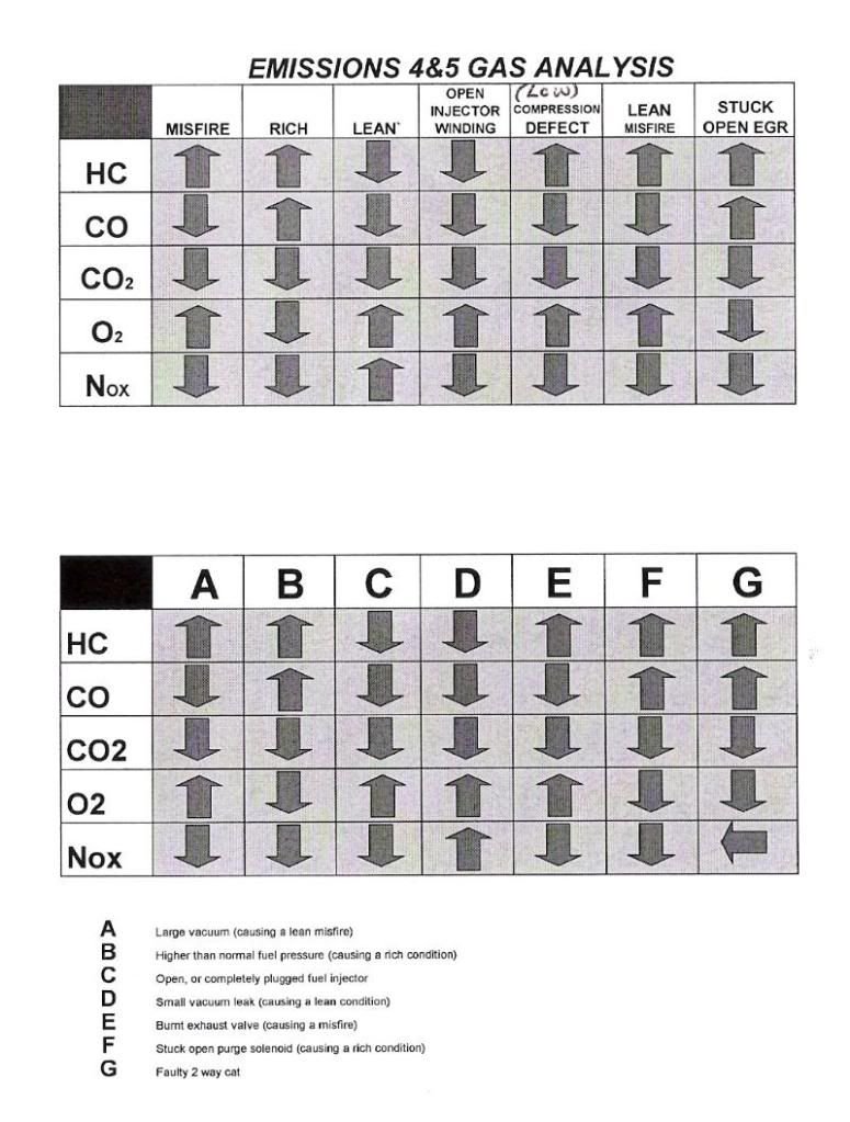

    i think your rite, i did a little search and found this:
    NOx are caused by excess heat and pressure during combustion. At
    excess pressure-temperatures, the oxygen will combine with nitrogen,
    forming oxides of nitrogen (NOx; NO1, NO2, etc). EGR problems are a
    leading cause of high nox. EGR reduces cylinder temperature by
    displacing some incoming oxygen with recirculated (non-combustible;
    inert)
    Timing that's too advanced
    means that the mixture is igniting while the piston is still
    compressing, and this causes high pressure and temperature (high NOx)
    as the expanding gas is compressed.
    since low compression wouldnt cause high temps ,it isnt your problem.
    here is a chart that should help,
    after some more reading i found that high combustion temps are caused by:
    timing
    vac leak
    low fuel pressure cuasing lean condition
    high carbon build up on piston and valves
    knock sensor{changing timming}
    egr valve or plug egr ports
    if the cat was bad wouldnt the ohter readings be bad as well?

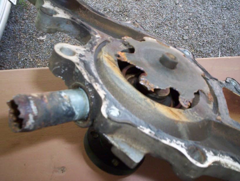

    the merc im working on now was running hot and cracked the head, i think i found out why...
    it was probably putting out high nox numbers as well! you can see that electrolysis can do a lot of damage. if you keep the antifreeze fresh this is less likely to happen. it has something to do with ph i think.
    #1821 Apr 2009, 1:51 PM
    Geez...mine better not look like that. It's only about 2 years old. πŸ˜€
