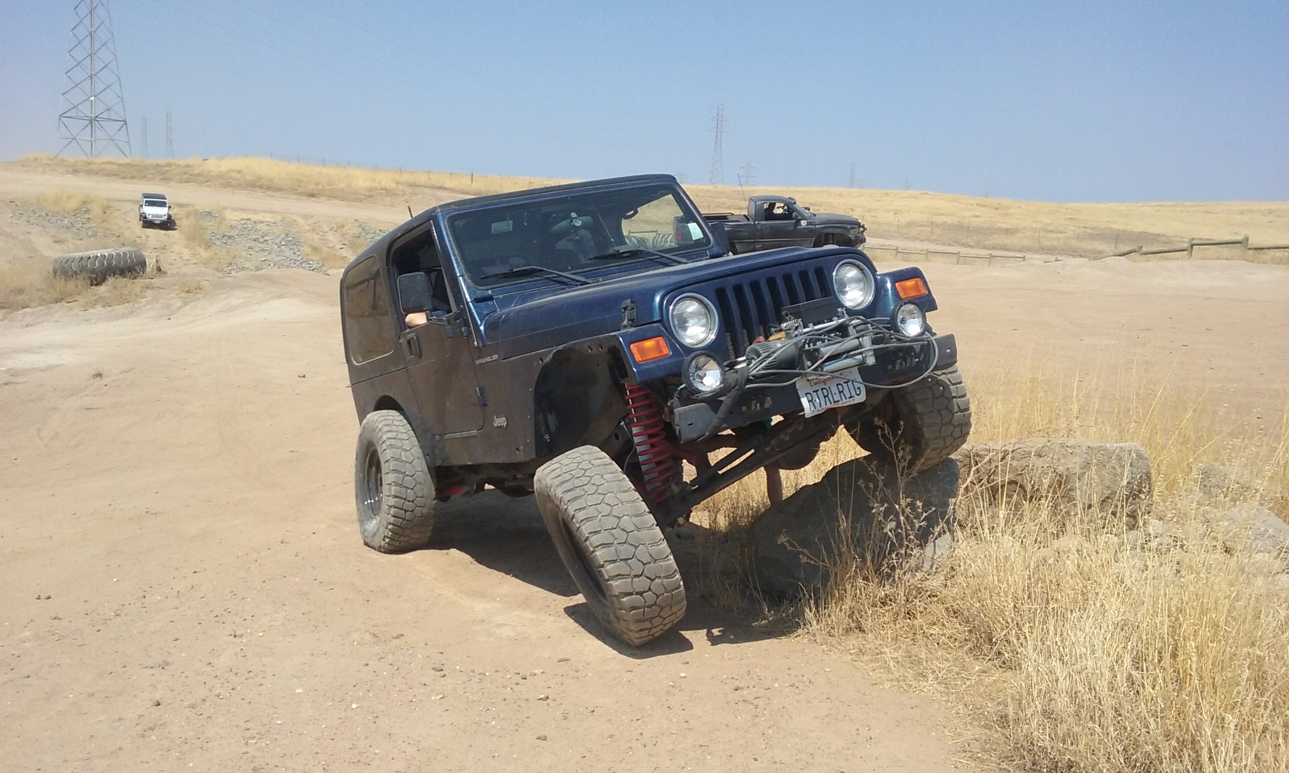

It was great only had 1 problem out there but had no problems on the pyramid, stairs or any of the rock gardens. The jeep has some serious flex now too20160827_131105.jpgImage Enlarger

Double flex kit does what is was advertised to do.  Front springs seem to be about perfect though bump stop extensions are needed to prevent fender-tire contact.  Front was flexing well with the sway bar disconnected.  Rear was resisting flexing quite a bit, my thoughts are that the springs are rated for a rear bumper and tire carrier plus camping gear.  Add some armor and typical trip supplies in the back and it should flex nicely too.
