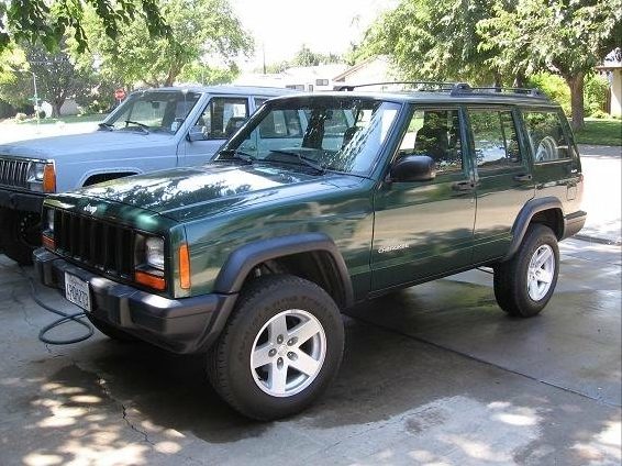

    So since the LJ is going to be out for some more serious work for the next few months I am going to need to make some upgrades to my daily driver to go on club events.
    Current Stats:
    2000 XJ, 120k miles, auto, stock, stock, stock, tow package, some basic recovery gear.
    The Plan:
    Club minimum requirements, ~3" lift, 31s, 4.10s, rear traction aid, and armor in the future.
    In my parts pile:
    RE 3.5" TJ springs, 2" front spacers, RE superflex lower control arms, RE 3.5" rear springs (used and sagging but soft riding), 1.5" shackles, used 4.10 front and rear gears with front carrier, ZJ v8 tie rod, hd D30 diff cover, and a few other small parts.
    I just purchased some TJ Rubicon wheels with 31s on them so im getting close to starting the build.  Should end up looking something like this but with 1" larger tires and 1" more lift:
