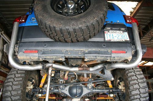

    I am running into the same problem. I have a stock 03 muffler on my TJ Rubi (that is leaking) Some say I can get a new muffler from Chrysler until the 8 year of 80k mile mark. Does anyone know if this is true? Also I hunt quite a bit and like my exhaust quiet. As they say in drag racing chrome and noise in this case dont make it go!
    Here is an idea... Please notice the make of this rig. 😁 hahahaha!
    #618 May 2011, 9:11 AM
    i think that dude needs a cleanout on that setup! πŸ˜‚ πŸ˜‚ πŸ˜‚ them darn weird toyota guys! πŸ˜›
