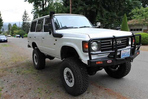

    I found this place while surfing around the web looking at fj60s...
    http://www.kavikoffroad.com/Vigilante.htm
    #2324 Feb 2011, 7:53 AM
    That's a lot of lift. If I had sold the 4Runner a month or two earlier I'd have gone and looked at this one.
    #2424 Feb 2011, 7:57 AM
    I was referencing the place because they specialize in fj60s and do motor swaps. Might be a good place to start your pricing.
